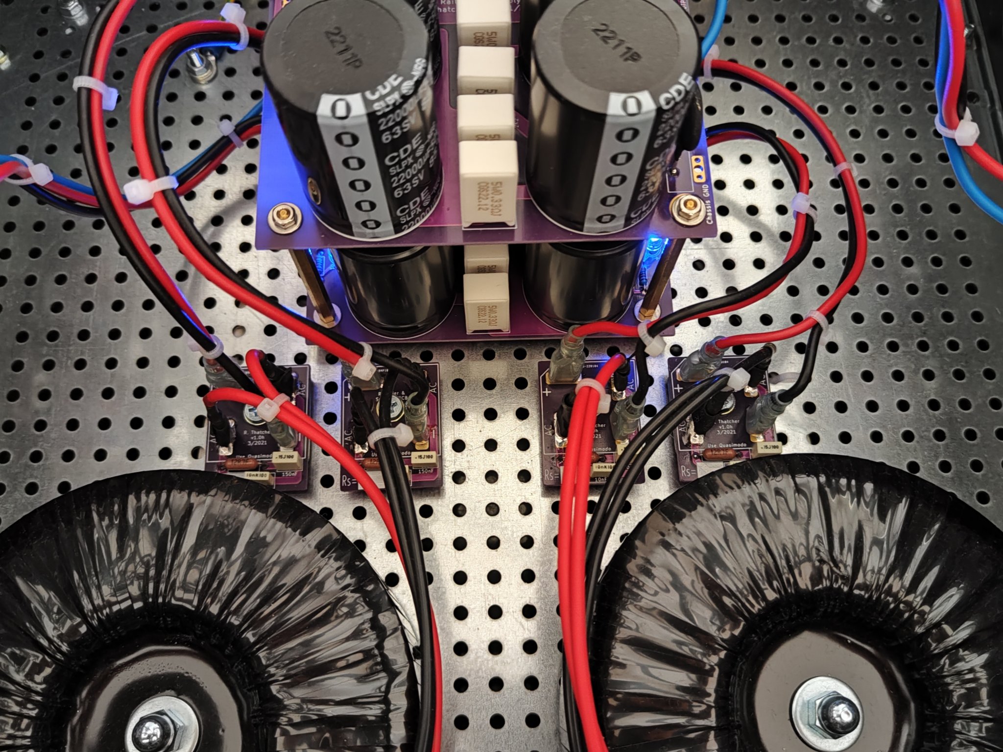

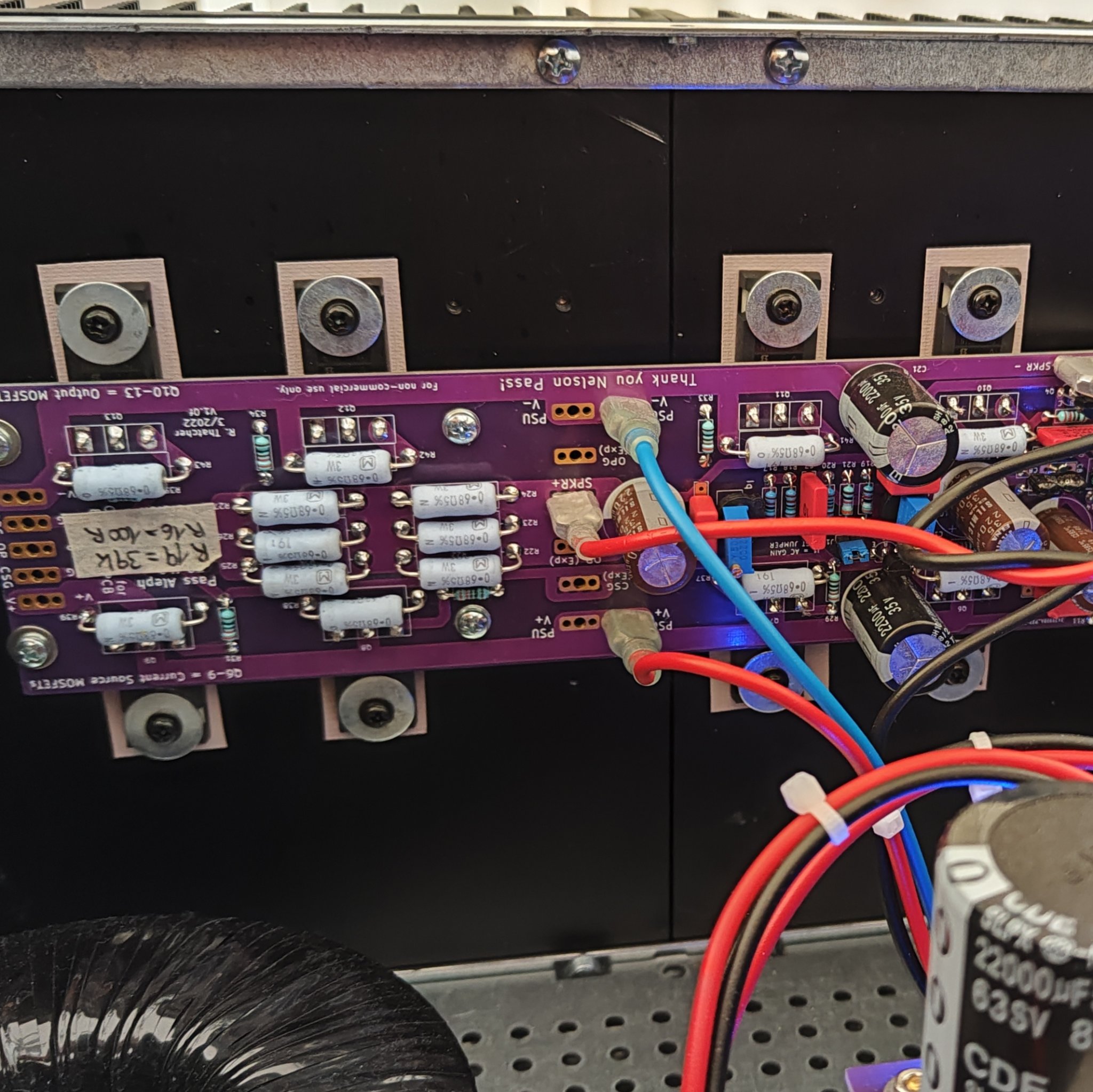

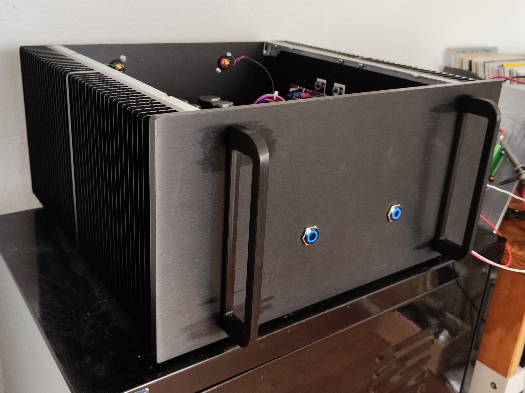

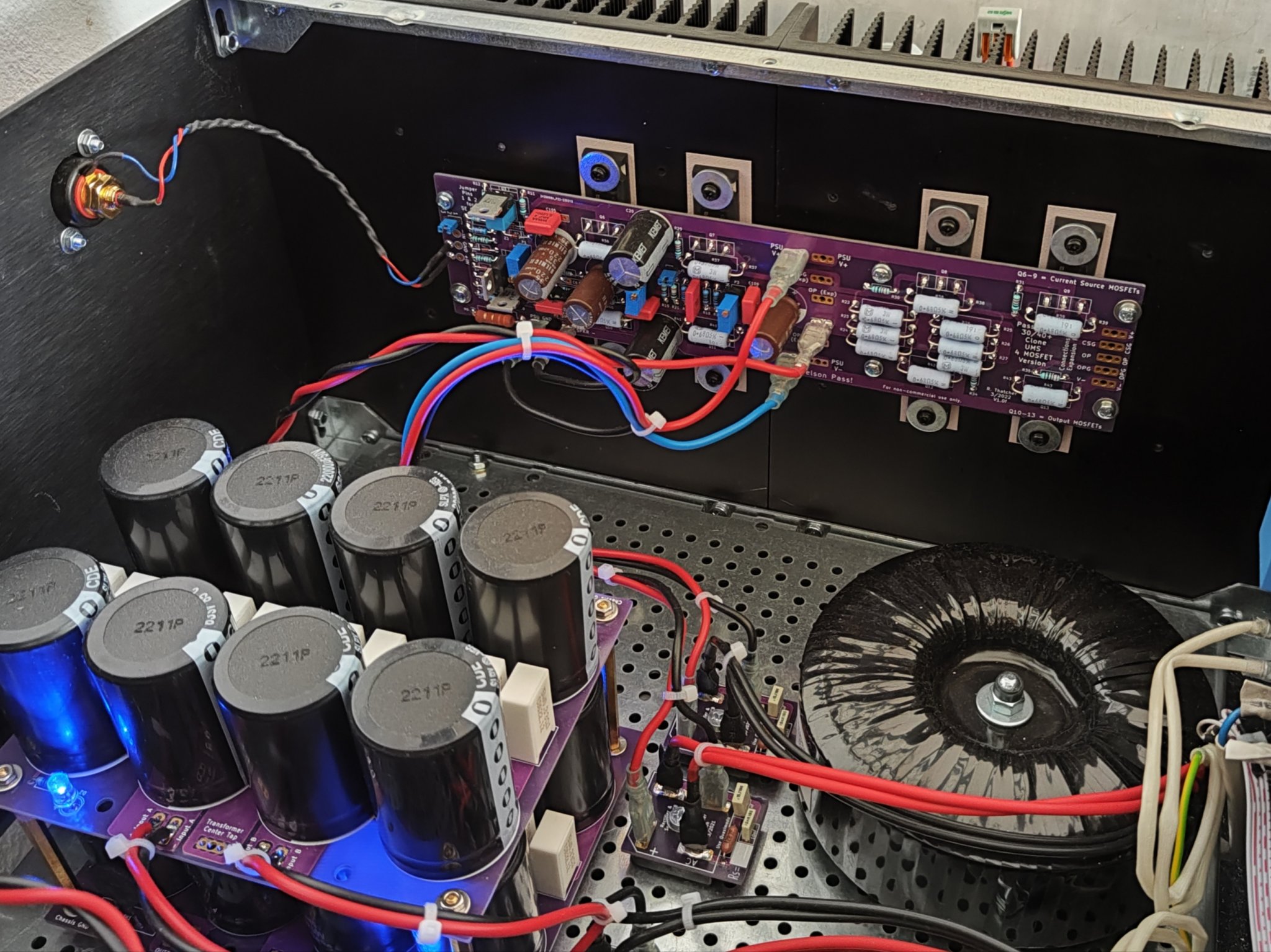

It's alive! Everything worked right from the start. Today I finished the build. In the past I thought of it as an Aleph40 build. But it will be more of an Aleph35+ because it seems to run a bit hotter then expected in the 5U 400 Enclosure. To be fair I think the 5U 400 is a good match if you want to build a cool running standard Aleph 30. I could have known this before, there are a lot of helpful comments about the ability to dissipate heat of different modushop enclosures.
My V8 CRCRC PSU ends up at (only) 27.6V per rail when a current of 2.7A is drawn. I suspect that the 2x22V 400VA Toroidy.pl donuts are not stiff enough or the CRCRC drops more volts than I expected. I would love to be able to compare my donuts with Antek ones.. But for now it that doesn't matter, because for the moment I am limited by the heat dissipation anyways. So a Mighty Babysitter is needed.. Or maybe liquid cooling?
The first listening test was pleasing. There is no trace of residual hum in this dual-mono build. I guess it's because of the CRCRC PSU plus double the filter capacitance compared to the F5 T PSU in my old A30 build (built with the same type of capacitors). It's hard to tell the differences between the A35+ and my "old" A30 build. And it will be even harder to tell where the differences come from, because so many details are different in the new build:

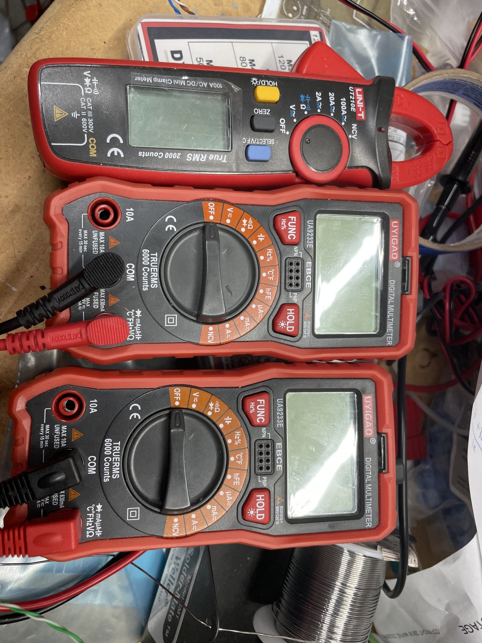

What (general) values are you talking about? Sounds silly to ask, but how far are they off? You're not measuring them in-circuit are you? What precision/accuracy are you expecting? Do you want to pay to have it calibrated semi-annually?
A resistor in the 50K range is about 1% low. It isn't a problem for doing regular checking of resistors before populating boards. My post was really in question to AddiDub posting that he measures pots to possibly change them out to regular resistors, which got me thinking about the accuracy needed to do that. I am pretty both my meters are not calibratable (a very old but rather nice Radio Shack meter, and a Klein MM700.

it's easy enough for you just to compare simplest reading on 1KHz and, say, 400-500Hz
that will give you proper info about your DMM
besides that, you're not chasing absolute values, relative ones are good enough - meaning - if there is some error, it will be same on two relatively close values

Today I finally adjusted the AC current gain to 50% on both channels. I used a 4-ohm load. After that I let the Amp warm up a bit. A quick check with the oscilloscope and signal generator (1kHz) showed that the Aleph 30+ is able to deliver at least 15V-16V RMS clean into the 4-ohm resistive load. That means something between 56W to 64W into 4 ohm. With my other Aleph 30 build I achieved about 35 Watts into a 4 ohm resistive load (23.3V / 2.2A).
Rail Voltage: 27,6 V
Quiescent Current: 2.7A
Total dissipation per channel: 150W
Heatsink temperature 5U 400: insanely hot
Sound: insanely good
No scope pics where made (yet) so I attached some pictures of the build.
