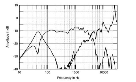

You need a biggish bass for a steep natural mechanical rolloff. Then you struggle for a tweeter that can crossover low or just go for a natural 3kHz with 8" bass. Enter Robin Marshall's Epos ES14. I don't know what Robin is up to these days, but he was a deep thinker on dispersion and dynamics and driver integration and even cone materials and shape.

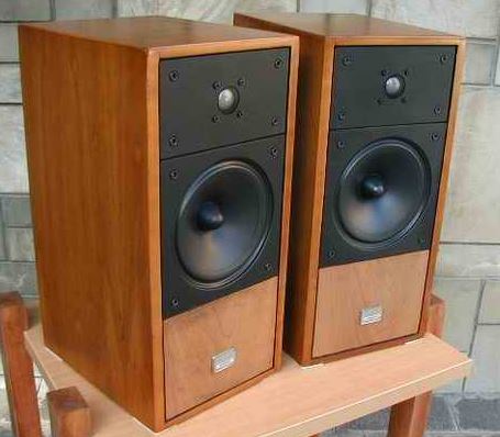

The Epos had a crossoverless polycone bass and a single cap and maybe some resistance to the metal tweeter. My old 12" paper bass Wharfedale Melton 2 had some of this sort of sound. And the SEAS Njord is along the same lines. It's a very good sound on percussion and drums IMO. People like it and it harks back to the sort of speakers people listened to back in the valve days. Mellow, in a word. Maybe a more modern modelled approach would use a series filter. 😎

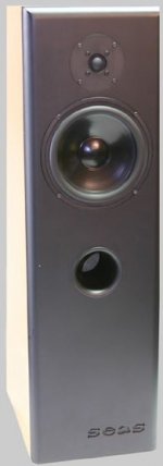

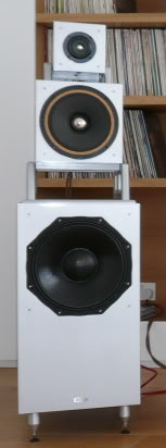

The trouble with a sloping baffle is that, although it is a good approach to time-aligning the acoustic centres of mid and treble drivers, the treble you hear at the listening position is off axis,
True. Though I don't like speakers that doesn't sound good off-axis (on-axis is less important for me).
But pyramid means also minimum baffle for HF drivers. Just like Vandersteens and even the Alexia. So a combination of stepped baffle and pyramid.

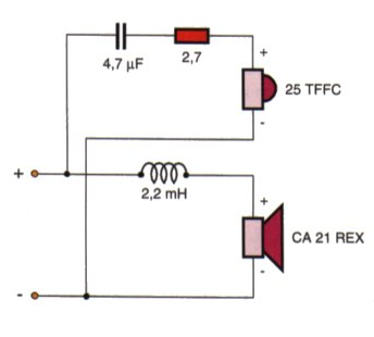

My last speaker was inspired by this (see attachment): Art Impressions

If your intention is true LR2 from the beginning, you may start with the stepped baffle, but often decision changes on the fly.
If box is decided from the beginning, diffraction should be measured/simulated with box dimension and be used in the modeling of the crossover.

Without a crossover schematic and some remarks about driver choice, you are a bit short on detail there, Jay. 🙂

I always had mixed feelings about the ES14 when I heard it at shows in the 1990s. I liked the liveliness and the natural sound, but I wasn't impressed by the treble, which always sounded a little "obvious" to me. I assumed at the time that this was the metal dome tweeter, but it could have been that I just didn't like Naim amplification…
