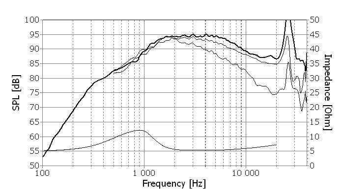

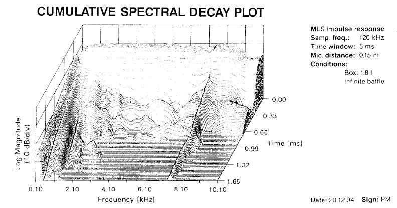

This is the tweeter :
H1499-06 27TBCD/GB-DXT
It is somewhat surprising the DXT is rarely seen in commercial designs, with Bruno's (Putzeys) Kii being an exception.
![Bruno_Putzys_Kii_THREE_curves_saturation-20_C-15_DSC_4801-683x1024.jpg](https://positive-feedback.com/wp-content/uploads/2015/10/Bruno_Putzys_Kii_THREE_curves_saturation-20_C-15_DSC_4801-683x1024.jpg)
(How) did you deal with that huge breakup spike?
I think the Kii has a Beryllium dome. Maybe it was the latest version of the Grimm LS1 that had it. Last year the Grimm was the best speaker in the world and now it is the Kii.Sorry, do not get that ********, i am confused. I heard both speakers at length in various locations and did not get nervous at all. I do not deal with the peak.
First i can not hear 27kHz and second i mostly listen to a 44kHz diet.
The ocasional High Res ? Sure, but in general i think recording is more important then medium nowerdays.
Could simply use a notch filter if i wanted. This is possible passive and also in DSP so where is the deal ? Call me incompetent as it happed here many times. Difference is that when i make a mistake i see it on my bank account. I mean i do not see it.

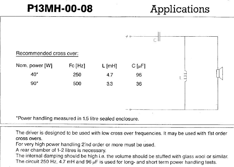

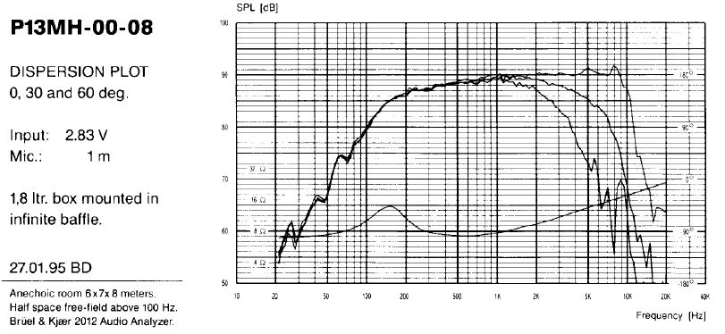

Apropos nothing, here's a near perfect Vifa 5" P13MH-00-08 polycone midrange driver that Lynn Olson will relate to, being the midrange version of his Ariel driver. But observe how it goes to pieces at about 7kHz. You don't need a waterfall to know that. The steep rolloff tells you that. Which is why I think the SEAS DXT tweeter has something going for it. A very gentle curve.

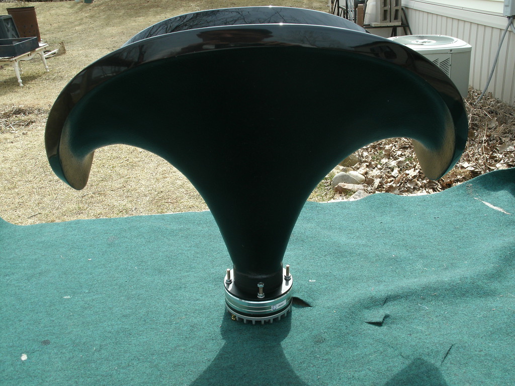

And these are real studio monitors, installed in top-line recording studios around the world. Very different than the audiophile speakers at the usual hifi shows. Thanks for the links, Marco!

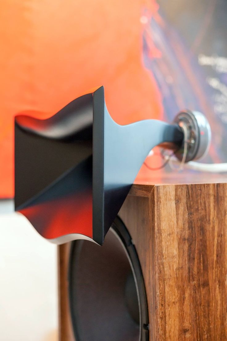

Those Yuichi horns do look remarkably similar to this:
Yes, they are similar. Wooden hypex (T=0.6~0.7) radial horns with a ~300Hz cut-off frequency.
Which horn is that? I'd never seen it before.How about something like this for a big 2 way?

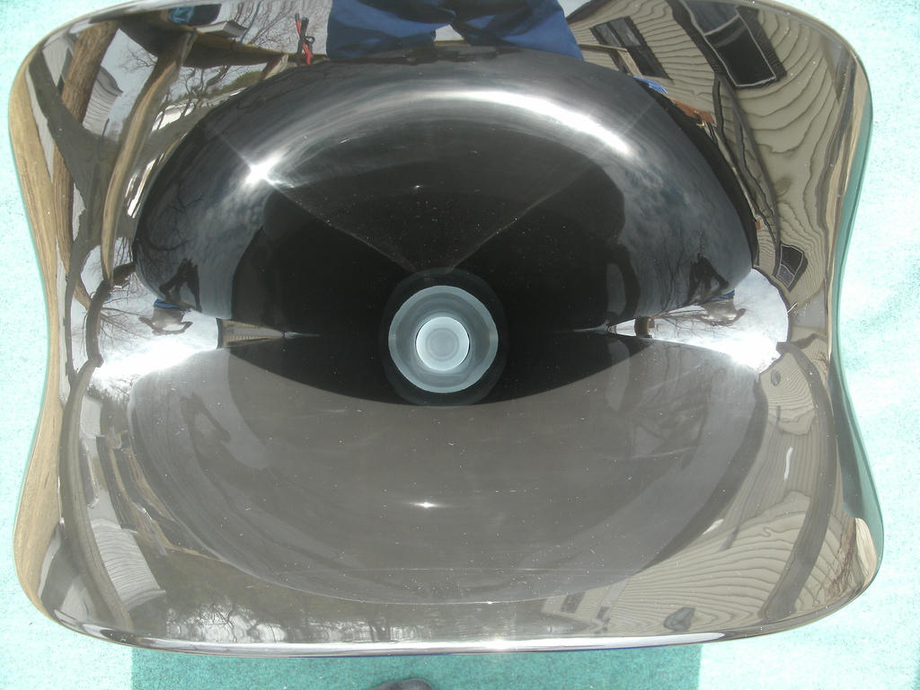

I guess this is a custom design, based on existing horn profiles (Iwata, Klipsch/Vitavox etc.) with the angled throat inpired from the WE KS-12024 and optimized with nummerical modelling in COMSOL or ANSYS.
The "lips" look kind of familiar though.
Cool, thanks.
But what would be the advantage (if any) of that first curved section near the throat?
