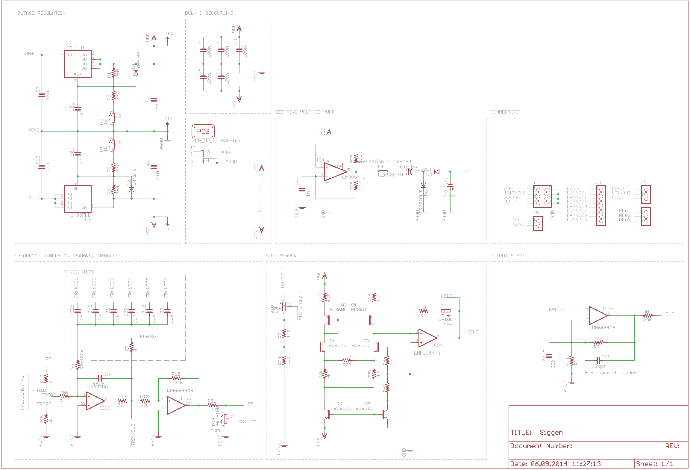

just want to post a basic (old fashioned) signal generator.
Frequency range: 1Hz - 150kHz (possible to run up to 450kHz)
Output amplitude: +-5V

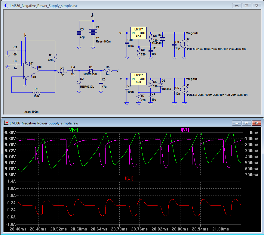

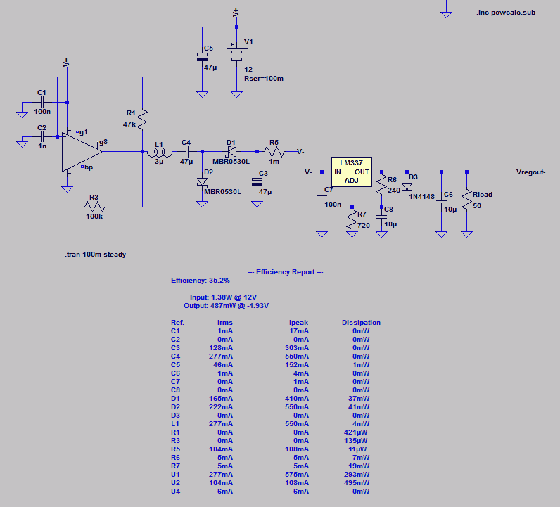

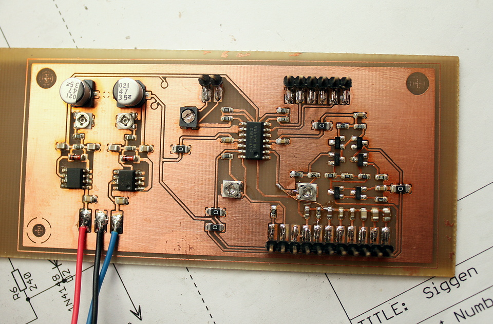

Reduced basic design, beside the bit uncommon sine-shaper. An quad opamp (LMH6644) is mainly doing all the magic, an LM386 is used as a charge-pump to generate the negative supply voltage. Resulting output ripple on the V- rail is about 2mVpp after the LM337. The output swing may need a bit of compensation, will see.

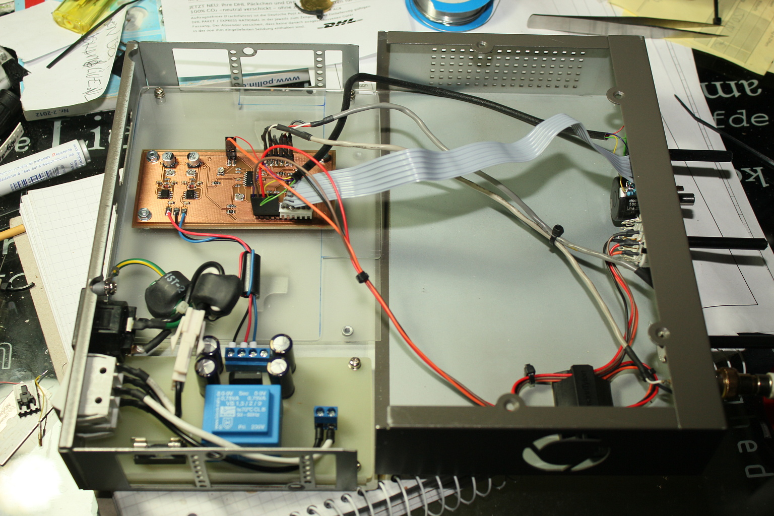

A first prototype (with dual transformer supply):

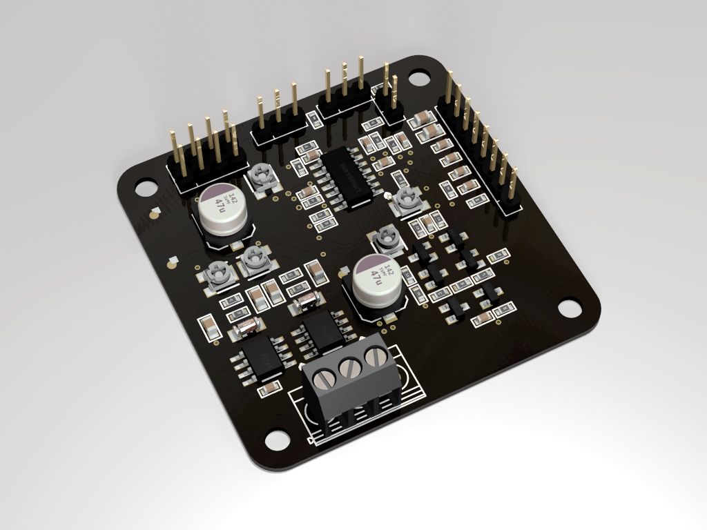

The new one will be 50x50mm in size.

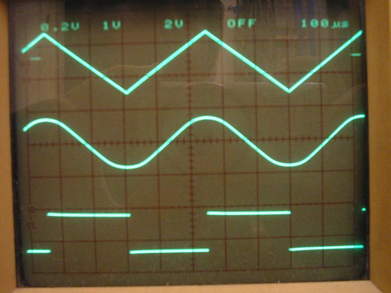

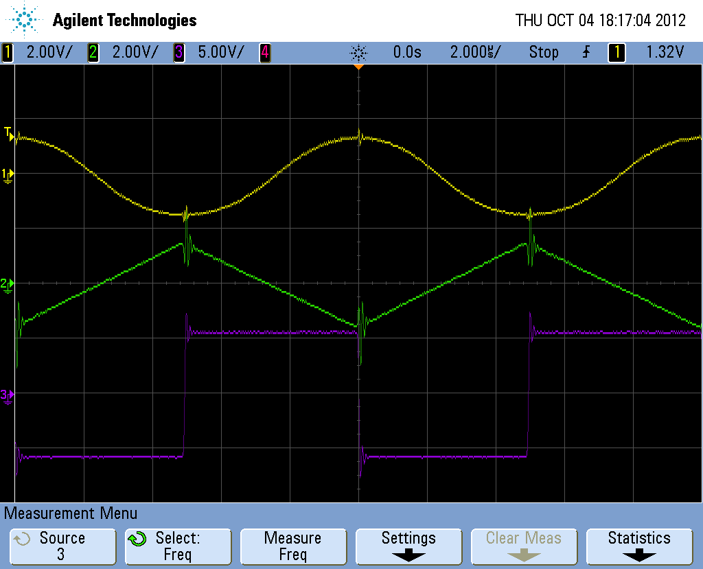

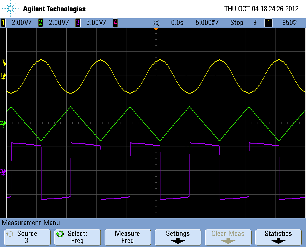

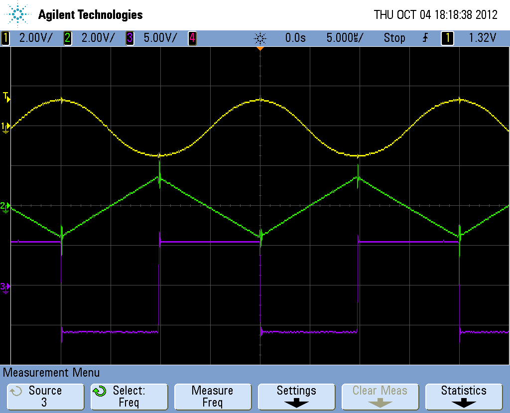

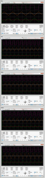

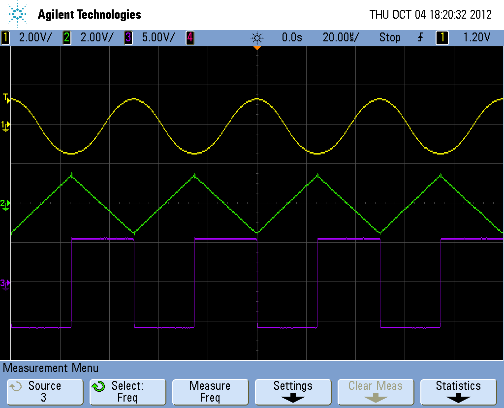

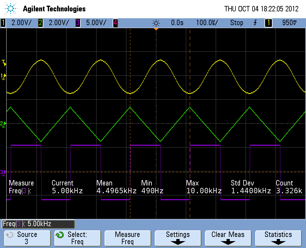

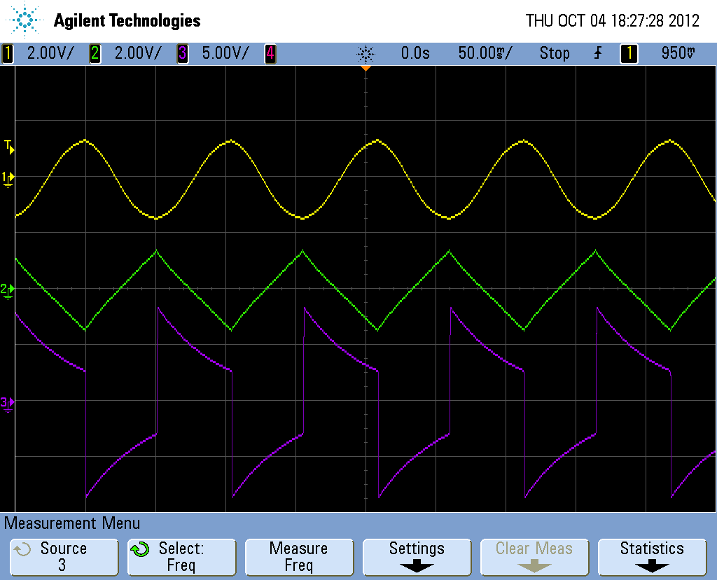

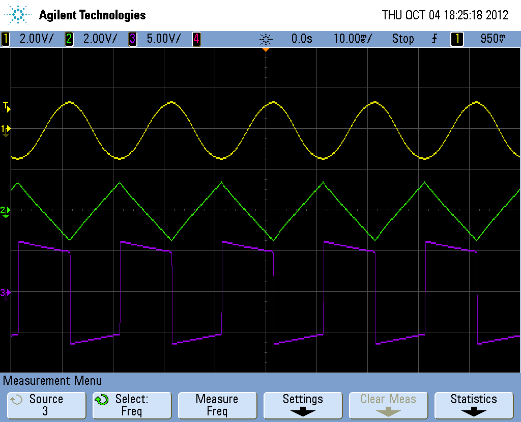

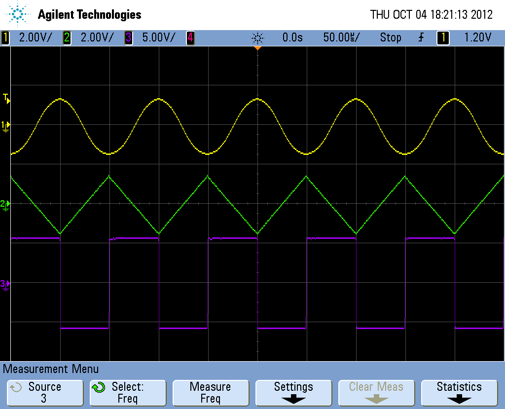

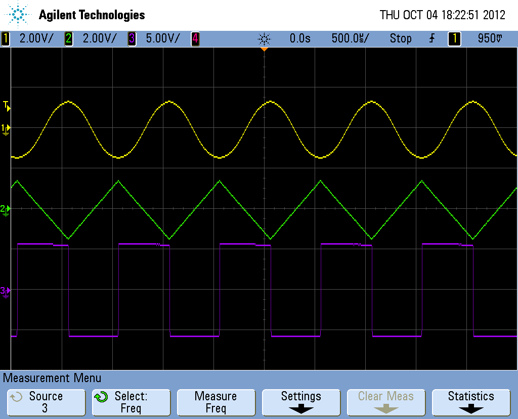

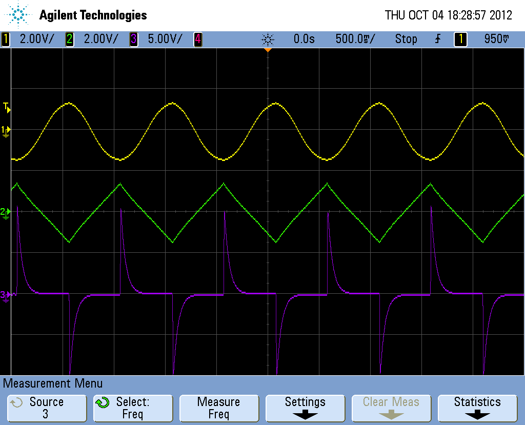

Some measurements on the prototype shown next (Don't mind the distorted square-wave at low frequencies, the scope-inputs where AC-coupled). The distortion at higher frequencies (100kHz+) comes from limited slew-rate and missing output-compensation. Will get this fixed.

If you are open to criticism I would say that this design is way below from what I would describe as basic sound generator.
I would suggest you to pause this project and to seek for an more advanced circuitry in which you will finally instal in your metallic box.
I do understand that this is your training project, if you are not interested to improve it regarding specifications, just have fun and ignore my message.

Looks very nice. Triangle waves really don't do much for basic measurements as an FFT analyzer even one based on a PC will show more detail. But as you use it for the input to the sine shaper the output is free.
Square waves are nice but for audio a good clean square wave doesn't need to go much above 20khz.
The important issue is the sine wave output level should not vary with frequency. It is also useful to go above 200khz. I would try a 390pf capacitor across R24 to clean up the triangle switch noise in the sine output.

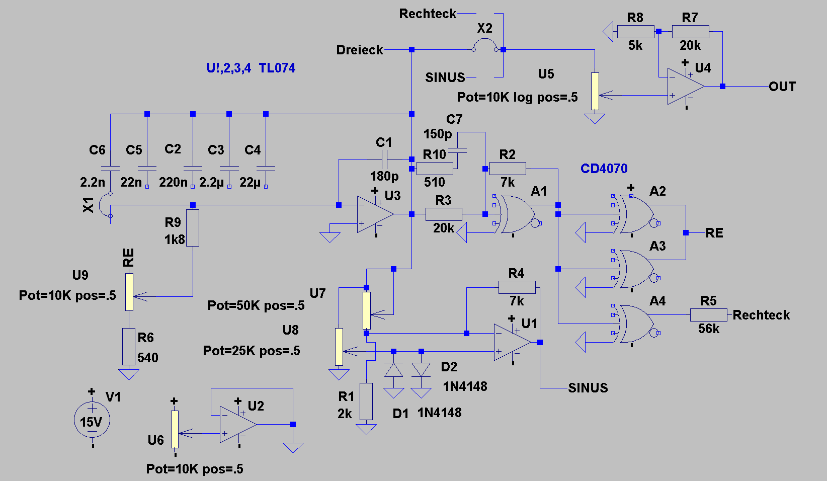

Hi Kriakos,
thanks for your reply. What problems do you see with this circuit? The power-supply-part could be more simplified, with just some virtual-ground using another opamp.
doc
The circuit-design is a derivation of a design done by a friend of mine.

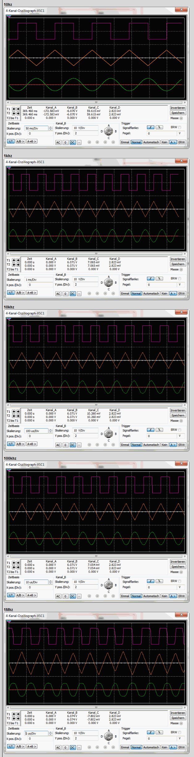

This gives the following waveforms:
Specs are:
F-Range: 1Hz .. 200 kHz (1 Mhz with small errors)
Sine Distortion: < 1,5 %
My initial design in Multisim shows this (using LT1365):
Specs are:

For start lets say that when I am measuring the impedance of my generator by a multimeter it measure up as 50 Ohm or as 600 when is selected.
Your Oscilloscope is at 1G Ohm impedance, therefore there is no chance getting a measurement which will be considered as accepted by this setup.
Aight, that's what I meant. While tested, the scope inputs where AC-coupled by a mistake, resulting in wrong signal display for the square wave.
The transistored sine-shaper is meant to be less than 1% THD at 1-10khz. (Not high tech but nearly all sine-generators which are not fixed frequency and/or wien-configuration aren't any better, or needs much more effort)
It also is temperature/voltage self-stabilized.
