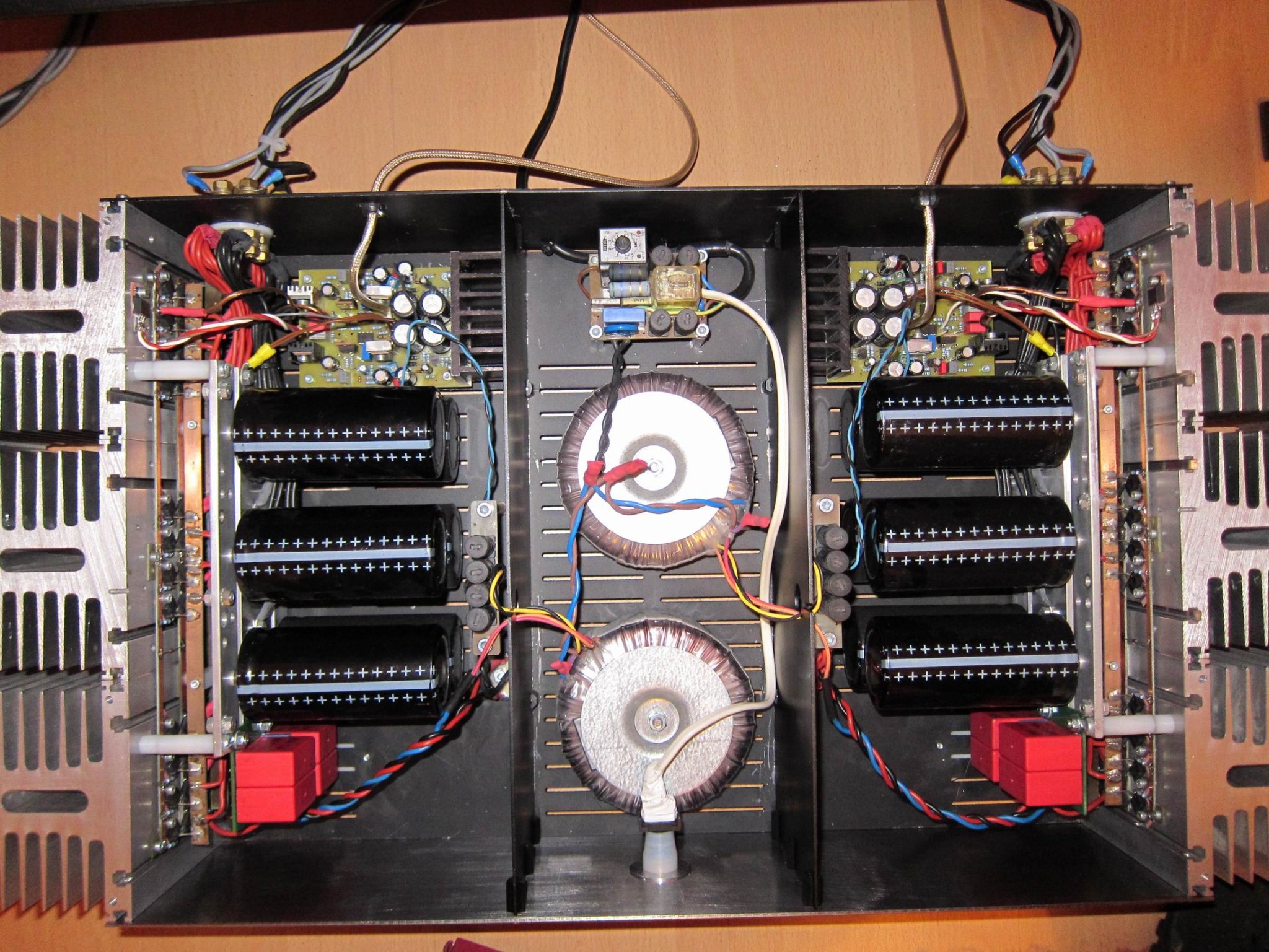

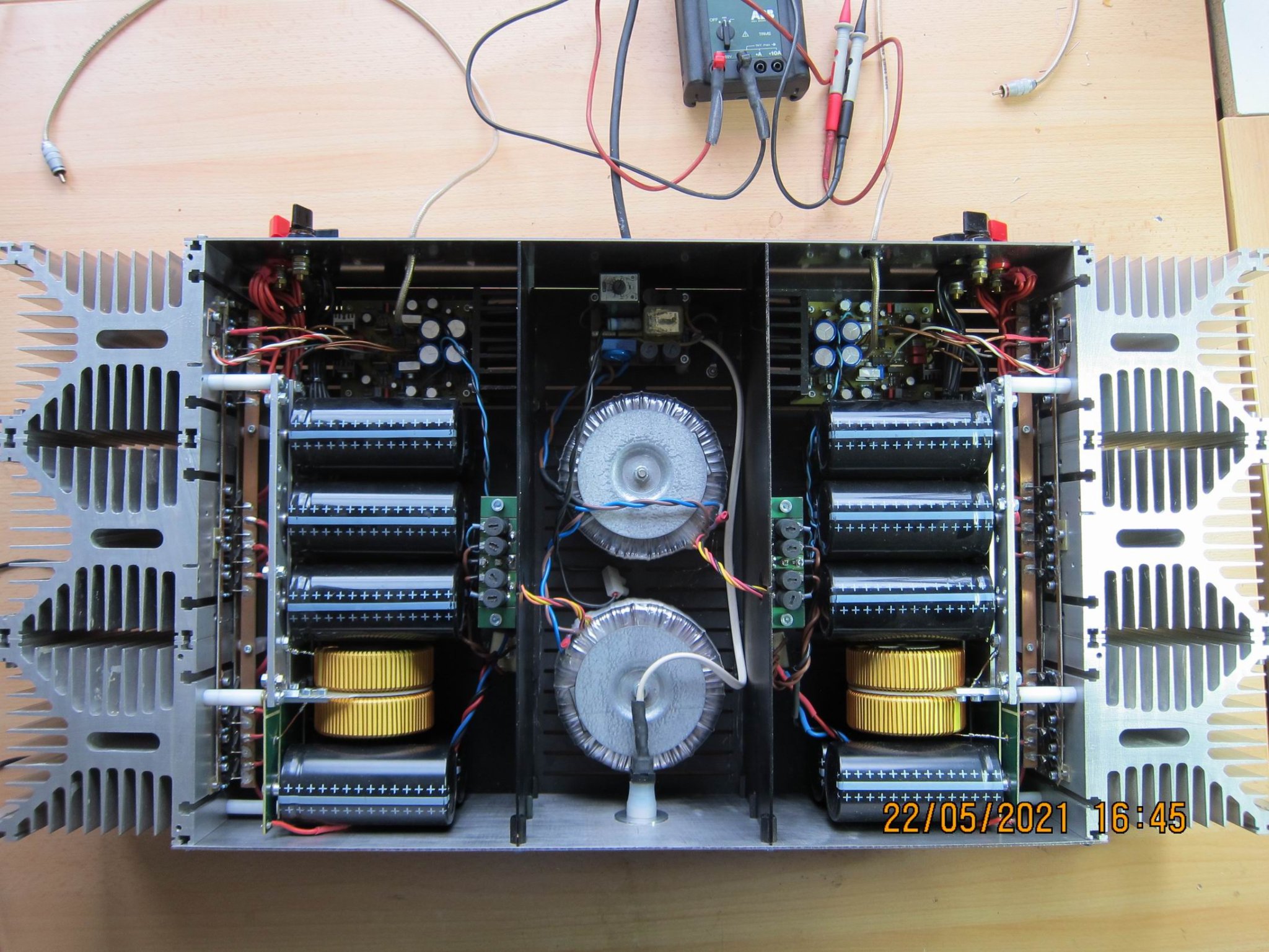

@norbMy A75 underwent CLC-surgery 4 years ago after working with standard C-only (66mF per rail)) PSU for 11 years. Ripple voltage went from 0,22V RMS to 0,011V RMS (1,7A bias) by adding 1mH(160mOhms) and 22mF per rail (+/-40VDC).
The only instantly recognisable difference was the increase in weight (app. 4 kg) after carrying the amp downstairs back into the living room.
There have been some changes in my audio system over the years - A75-setup (folded cascode, feedback), speaker position, acoustic dampening, different CD-players, new turntable, harddisk/network players, ears getting older - with by far greater sonic consequences than CLC.
Conclusion: I can only tell that my A75 has CLC by lifting it.

Fastron TLC/5A-102M, 1000µH, 5A DC. Datasheet says "Rated DC Current Ιsat, based on the Inductance Losses (Lo/L Load) where the Inductance decrease 30% max. (TLC/5A: 749µH). The core material is an iron-powder mixture optimized for high saturation currents"only if they are slit magnetic strip toroid cores (made for DC) there is use of them

These are measurements i wrote down in May 2021, when dealing with "crackling" output MOSFETs, made with Agilent U1253B (V) / Metrahit 18s (A):
L channel +/-39,60VDC, Bias 1,7A, Ripple before L 0,22Vrms, Ripple behind L 0,010Vrms
R channel +/-39,55VDC, Bias 1,7A, Ripple before L 0,22Vrms, Ripple behind L 0,011Vrms

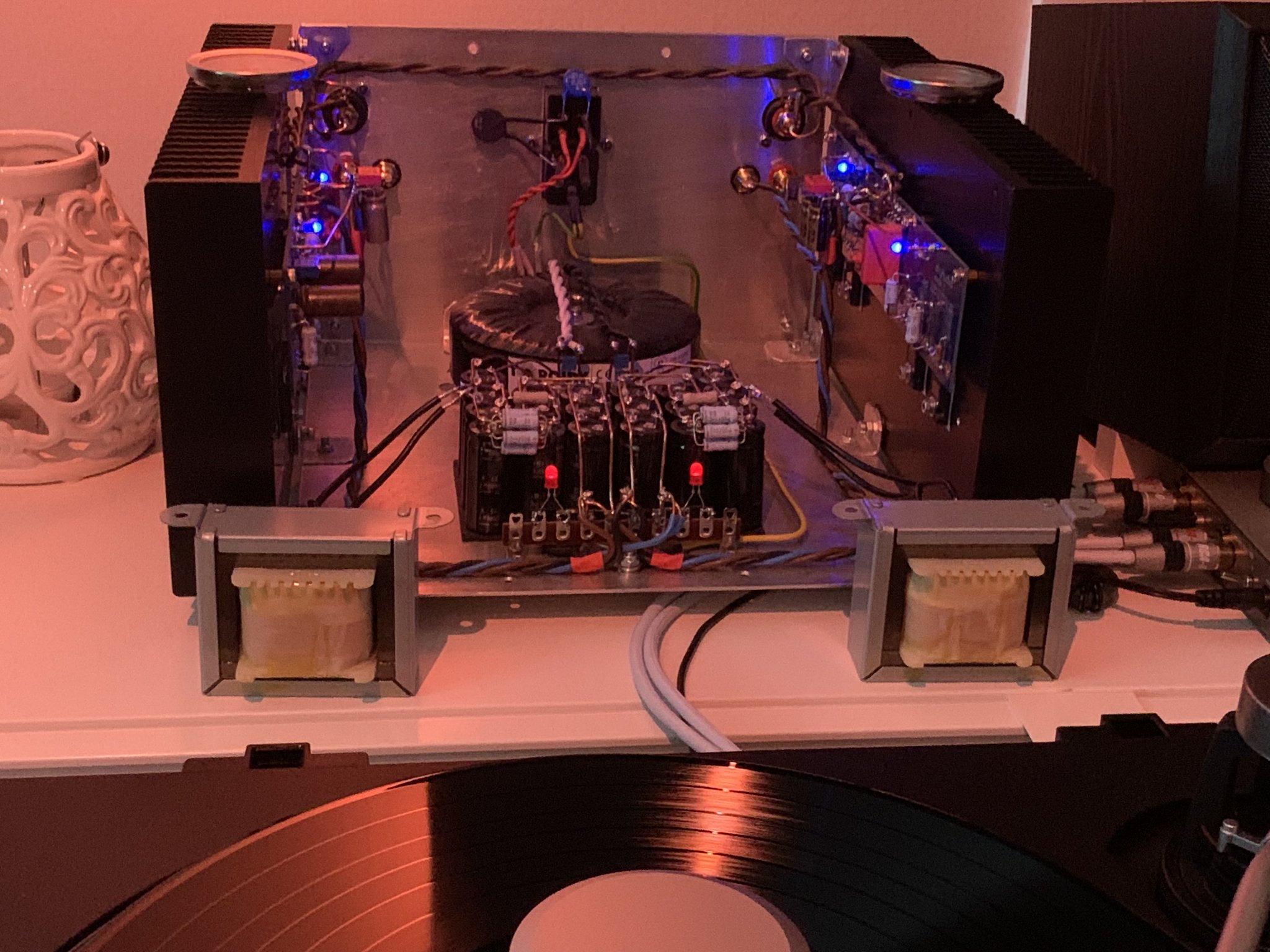

This is the L:s inserted in one of the Aleph Js running in parallel. Forming CLCRC filters. Both L&R amps have got them added Ls.
I have been running them now for a couple of weeks, and my preliminary conclusion is:
A calmer, smoother and even more clear, inviting and unharch sound. The bass seems to have even more juicyness and substance. The bass grip and power sounds starts somehow further back in the silence.
I really like it so far. 🤘🙂🎸

Good idea, surely gonna test it. Since I loose ballpark 0,5V rail at the L and ca. 0,5V at the R.
But i am of cource in no real musical enjoyment hurry. 🙂🎸
The only downside with this arrangement is that the sound is more clear and (could be to much) chill.
Well? That easily mitigated: Simply Turn it the F up a notch or two or five! 😎❤️

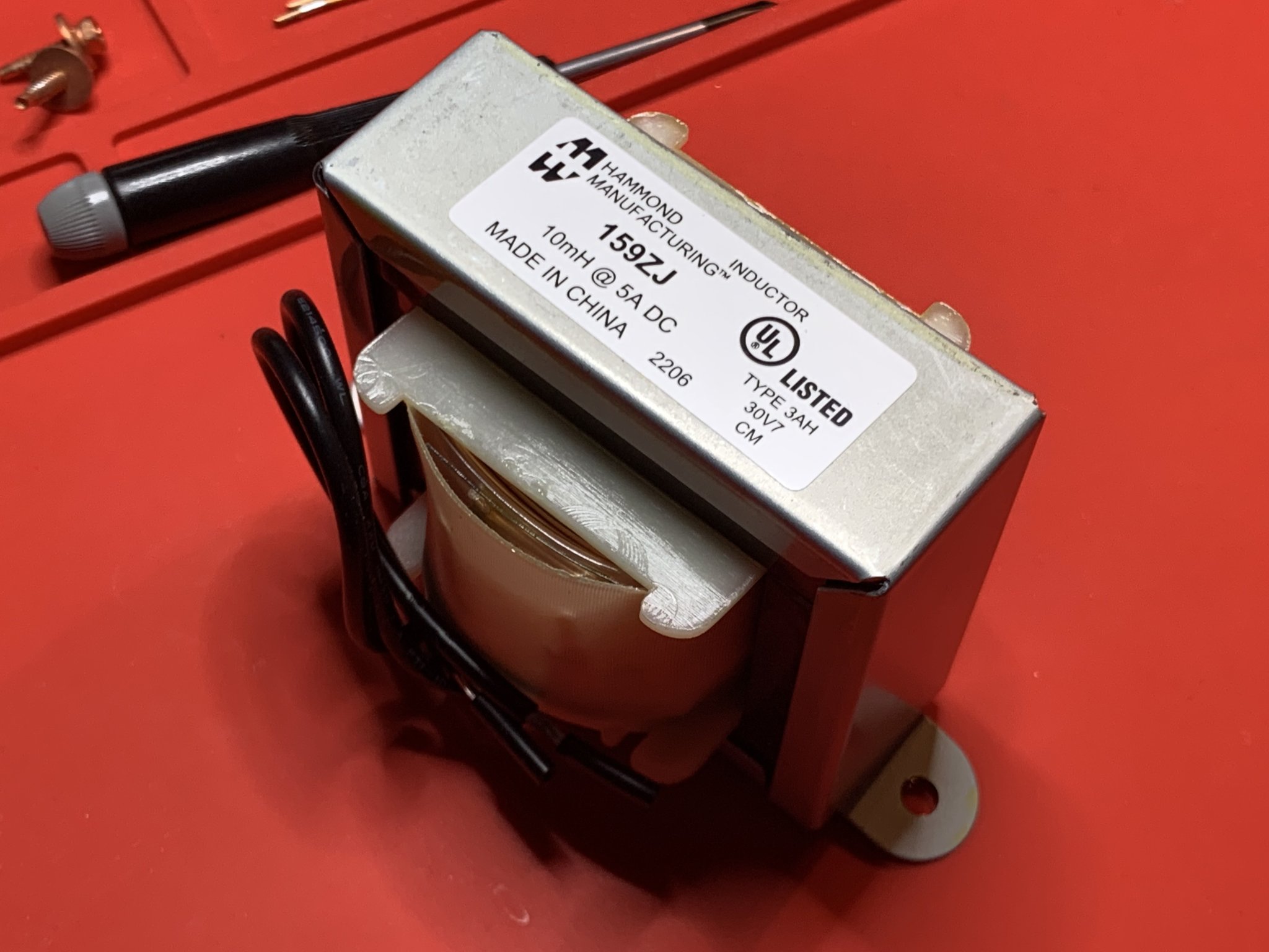

I like using separate CLC filtering for each channel with Hammond 159ZJ (10mH, 0.16 ohm) chokes. The CLC filter consists of 44 mF capacitance, Hammond 159ZJ, followed by another 44mF of capacitance. This gets the ripple to the millivolt range...

I like simple. My typical CLC of 44mF - 159ZJ - 44mF measures well and there is no audible noise from my 103dB sensitive speakers.
