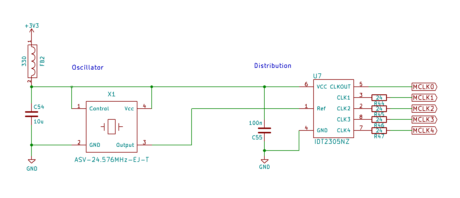

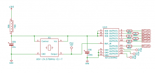

freeDSP-CLASSIC-SMD-B-master uses IDT2305NZ like this.

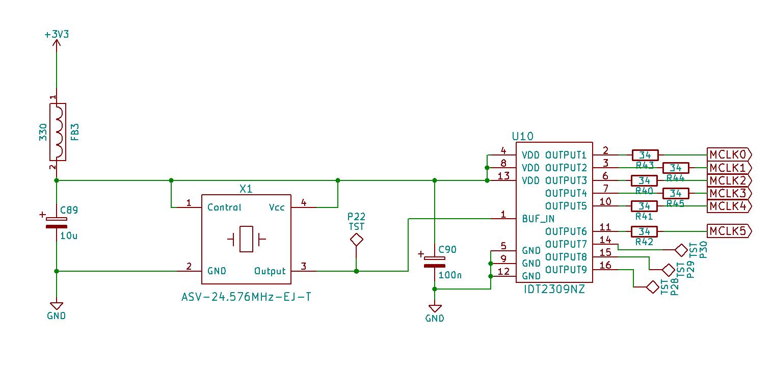

freeDSP-ALLinONE uses IDT2309NZ like this.

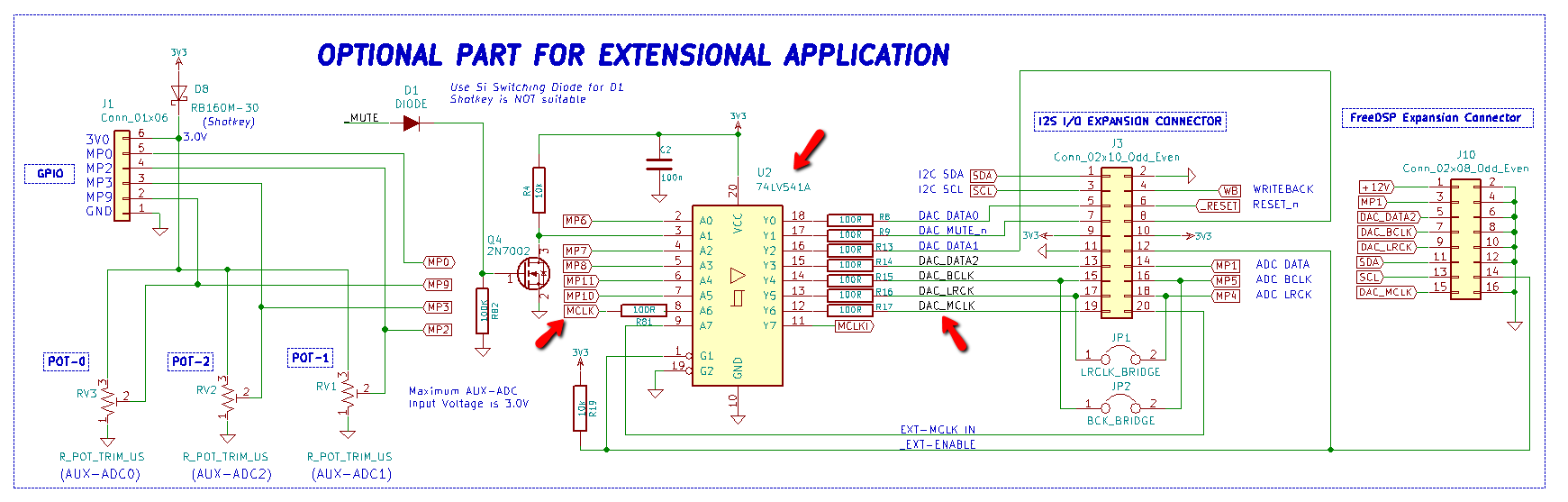

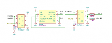

freeDSP-aurora seems to be using the NC7SZ157... Like this. Although the datasheet is very technical and I'm not positive what this is doing.
In fact, I'm not sure that it's distributing the clock as much as just maybe strengthening it?
I'll probably just follow the lead from the freeDSP-CLASSIC-SMD-B for my project. Or I'll look into the NB3L553. Seems simple.

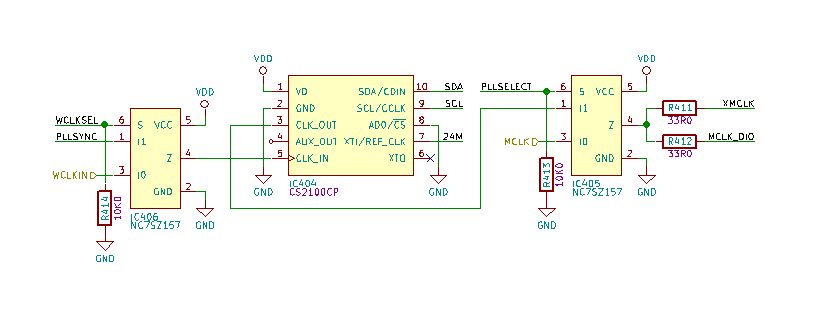

It is providing multiple copies of the clock that can go to different parts of the circuitry. In that case, its often good to have low skew (the timing difference between the different clock copy outputs) and low jitter from various noise sources including power supply noise due to all the output channels switching at once, and whatever other noise may be on the power pins of the clock buffer.

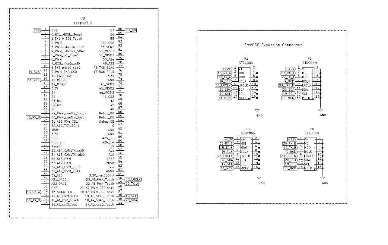

After thinking more about what I'm trying to do, I wonder if CyberPit's method is the right way to do it. By adding a Digital Buffer to the I2S lines (including clock, and all other lines), I should be able to transmit/drive/receive a cleaner signal. Yes?
So I have the following schematic. What if I added an Octal Line Driver/Buffer to this circuit, so that each expansion port has a stronger signal. What do you think?

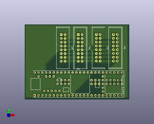

Here is what it will look like without any buffer.... But I'm planning a power supply, and I'm debating what driver I might need to ensure that the signal carries to all 4 ports, and over ~6 inches of IDE cable.
Basically the Teensy 3.6 has 2 I2S lines. The lines share the BCK, LRCLK, SDA, SCL, & MCK. Then there are two I2S RX and TX (receive and send) buses. The point of this project is to expose the two buses, so that pairs of DAC/ADC parts can be connected.
