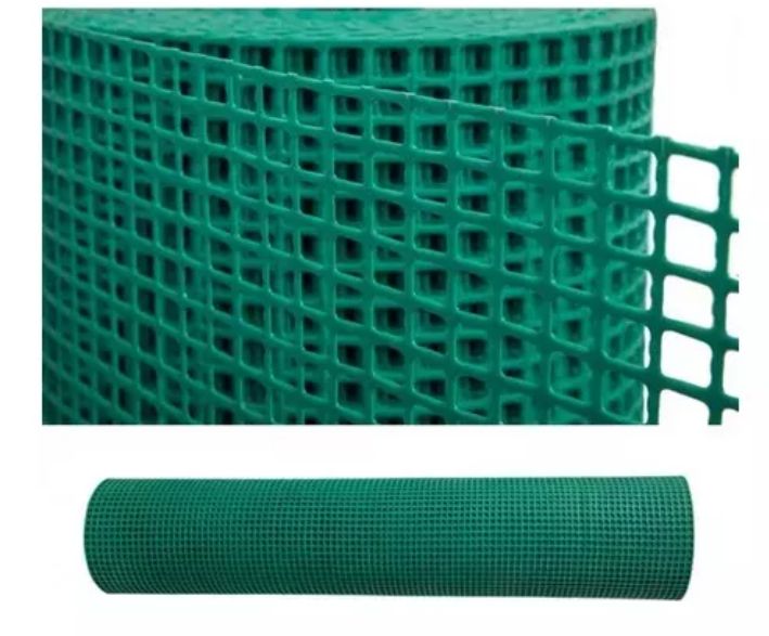

wonder if there's a ready-made grate disc to fit inside a this standard 4" round drain grate ? - maybe a piece
of 1/4" grid hardware cloth would suffice to hold a layer of damping material - ?
https://www.amazon.com/NDS-11-Plast...3f-b6bd-da4aa56a9f74&pd_rd_i=B000BO8OAI&psc=1
You can get a piece of thick-ish chicken plastic grill for cents at the hardware store and cut it to size with regular scissors.
Use it to cover fiberglass or nylon batting and add a bead of adhesive around so it stays there.
Or cut an oversize square and staple it in place.
