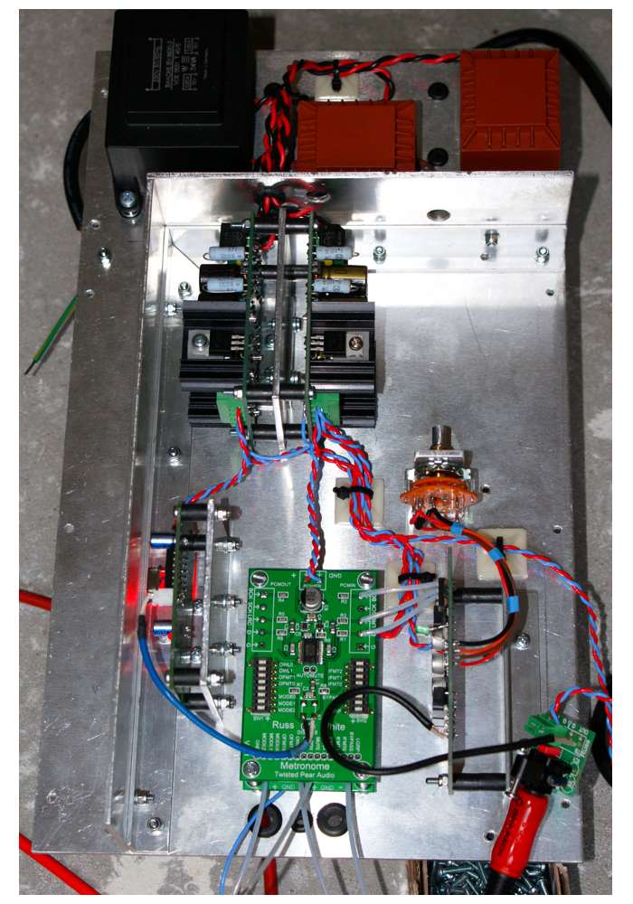

BrianDonegan said:Is your mains ground connected to the chassis?
Not yet. I'm just testing the digital part now and that has no connection to the chassis. That is what made it weird. I was thinking some antenna effect...
I will post a pic later...

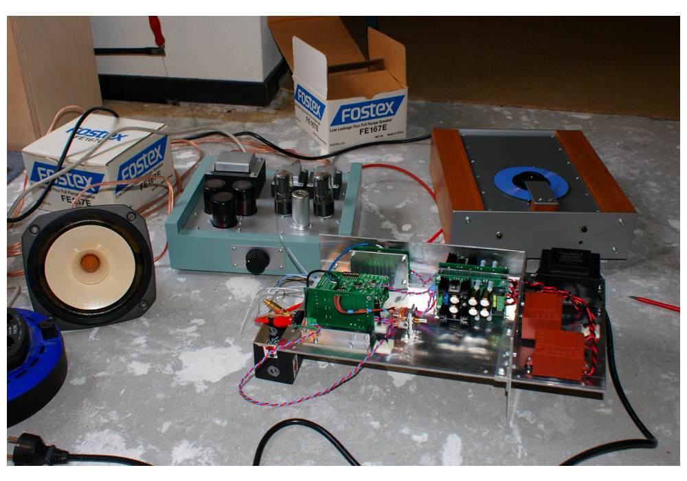

Top view...
Left Tent, middle Metronome and COD, right MUX.
BrianDonegan said:I think it is static discharge from your hand with no place to go.
The issue is still not solved... When I touch the frame there is a hum/buzz and when I connect the frame to safety ground there is also a loud hum/buzz. Sounds like a 50Hz... I measured the AC voltage between common and frame and it was a whopping 16V!!!
Can it be that because I have mains wire going through holes in the frame that the whole thing becomes in fact a sort of transformer?

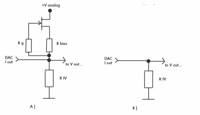

I have one Q in general,
but refering to sabre ES9008 output...
Which one of theese two shoud be better at passive IV?
And, what is the lowest value of R iv that I coul apply,
and not to damage dac chip?
Is the lower value of RIV lowering the distorsion for ES9008, same like in
for instance pcm63 and tda1541 dacs?
Or not?
I put, just for the test 1K (at each Iout )
the chip remain the just slight warm...
thanks
Thanks,
Jeroen
I got some help. The common, safety ground and chassis were not yet connected. After doing this all the hum and buzz was gone, also when touching the frame.
As I did measure a potential difference between frame and common, are there now currents flowing through the frame?

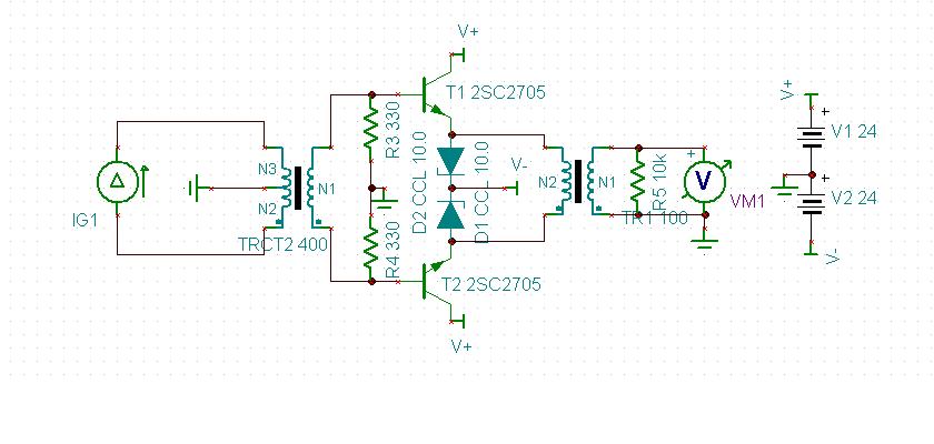

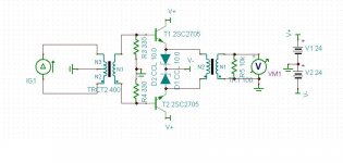

OK, thanks. I forgot that the same DC offset is on each out pin on the DAC.
So, maybe something simple like this would work after all? The diodes are CRD's. The THD would be what ever the transformers have, maybe 0.001% if I'm lucky.
