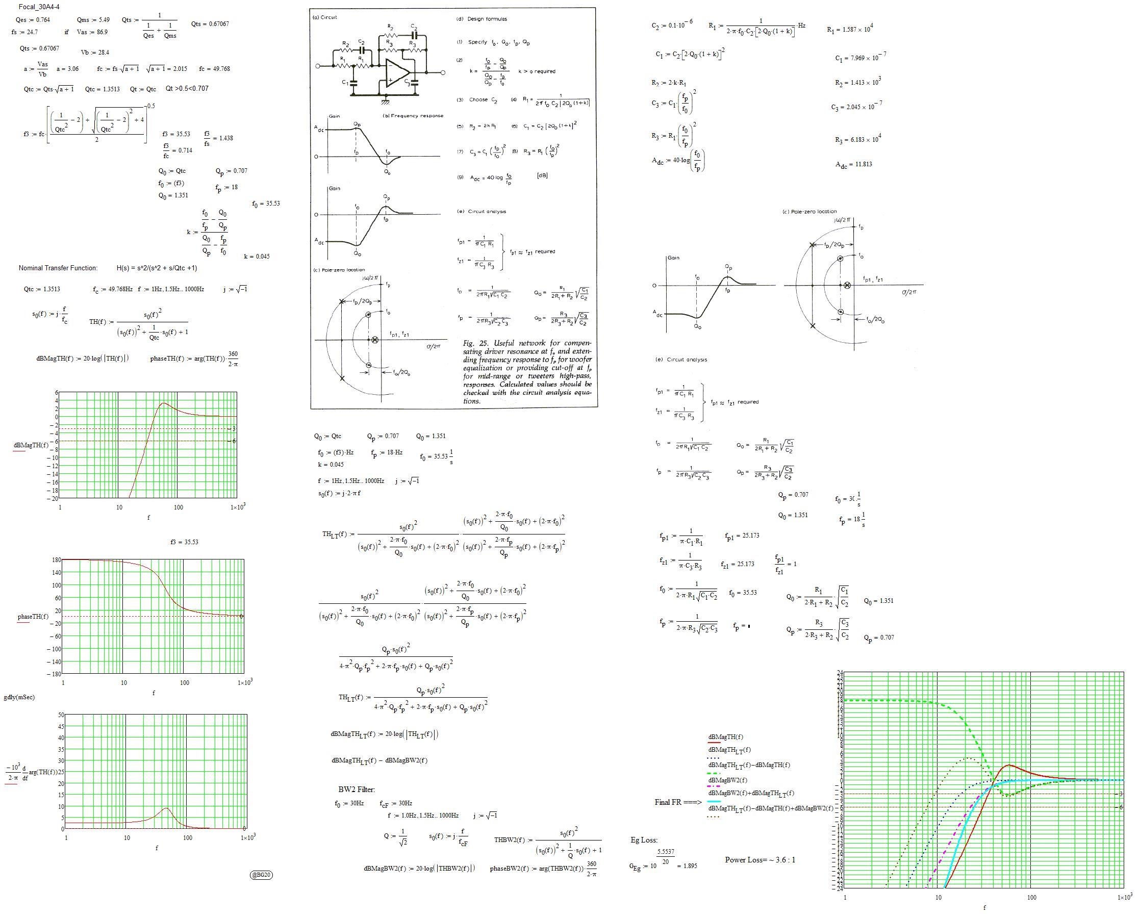

Have you considered a small sealed box with a pair of 10's, or a pair of 12's using a Linkwitz transform ?
I think it could work well for your application.

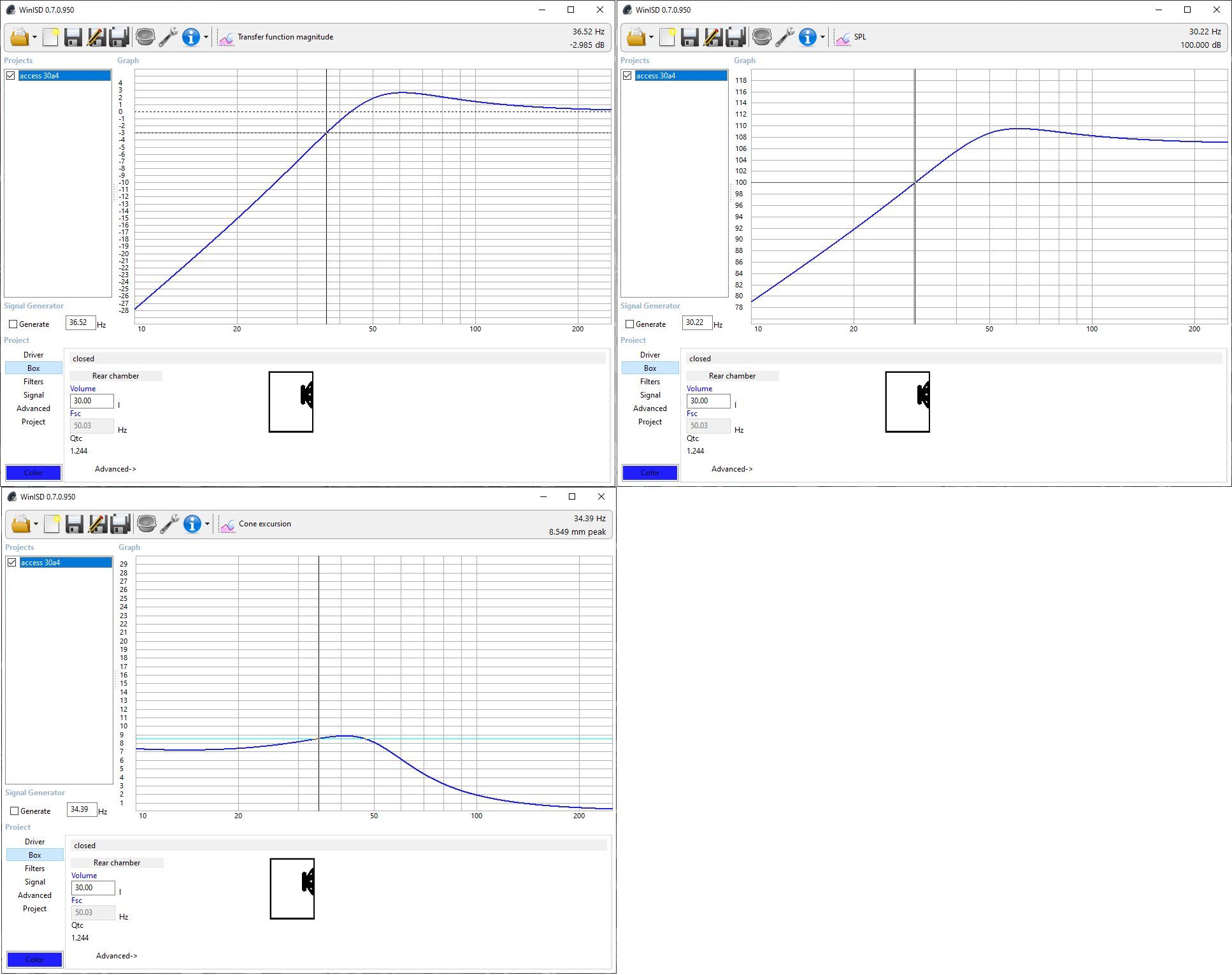

I tried to apply a linkwitz transform in winisd but it drove cone excursion off the charts. I'm guessing having to reduce input power to stop cone overexcursion is the price I pay for extended lowend?

Yep the trade off for small and deep is low output at deep frequencies. If you think over excursion may be a problem at the lowest frequencies you could always apply a high pass filter to limit excursion. Don't forget you may get some room gain in the small room which will help real world results.

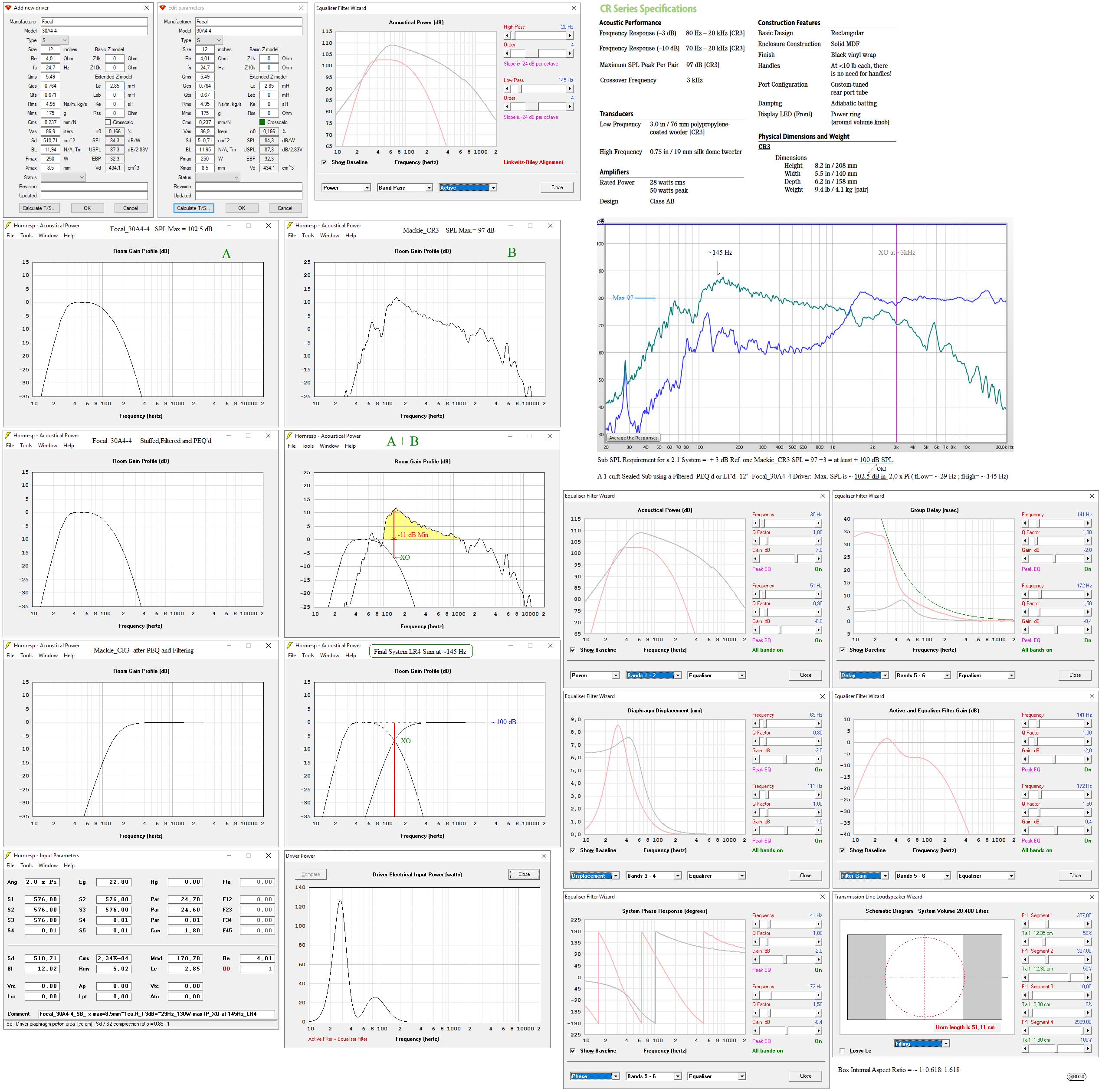

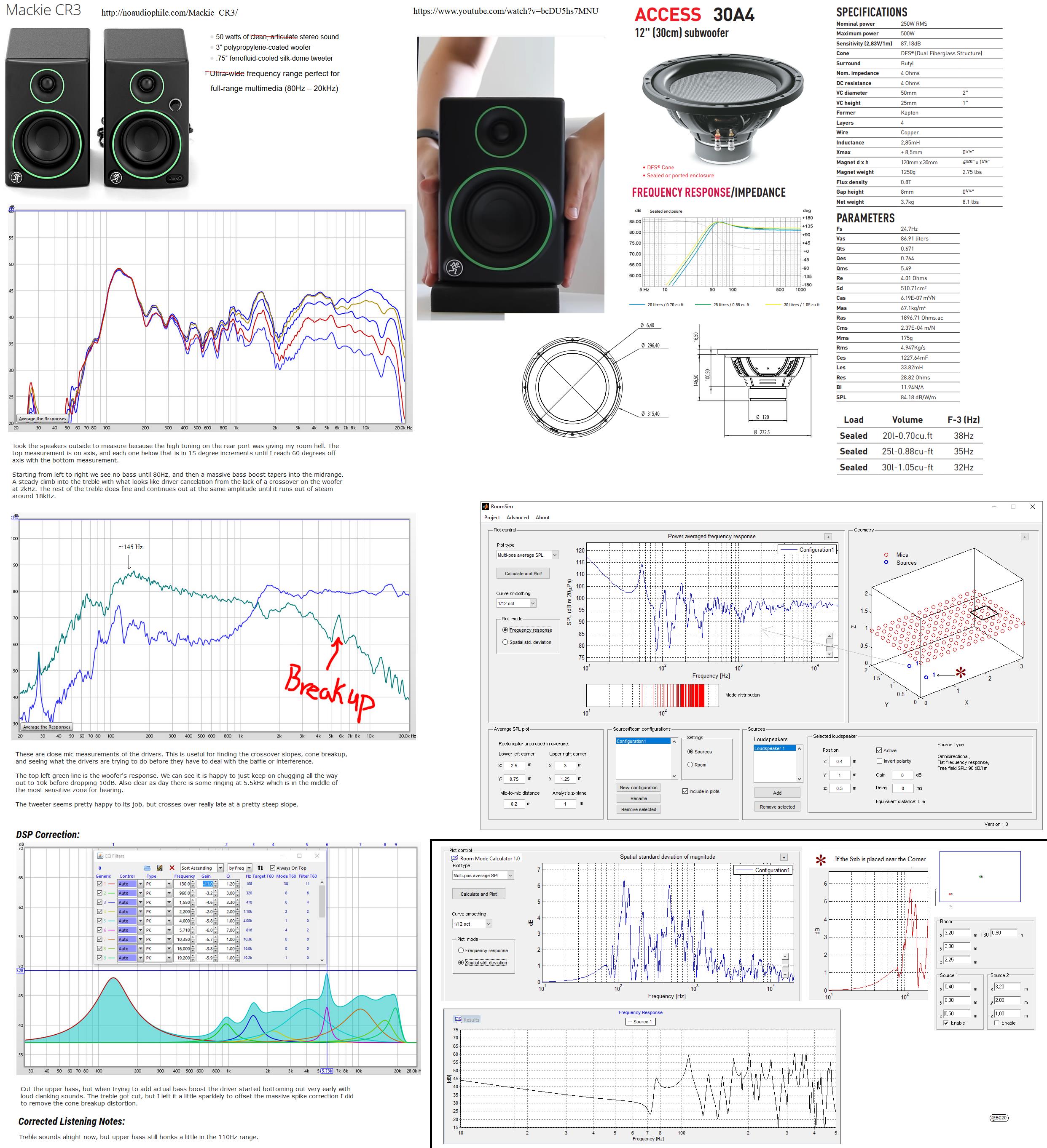

Hi Swizzy,All
FYI, Proof of Your suggested 2.1 System is in the Pudding(IMO OK) as can be seen in the submitted Pictures:
b🙂
