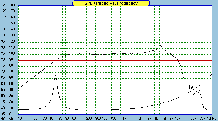

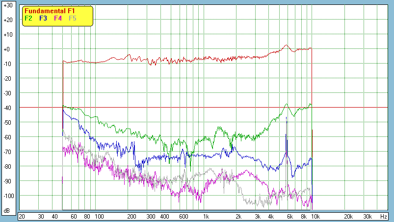

At this point I am 90% decided on using the SB15NBAC30-4 as the mid driver. For the price, I have not found anything else that equals its combination of smooth frequency response, low distortion, and clean CSD/ step response performance.

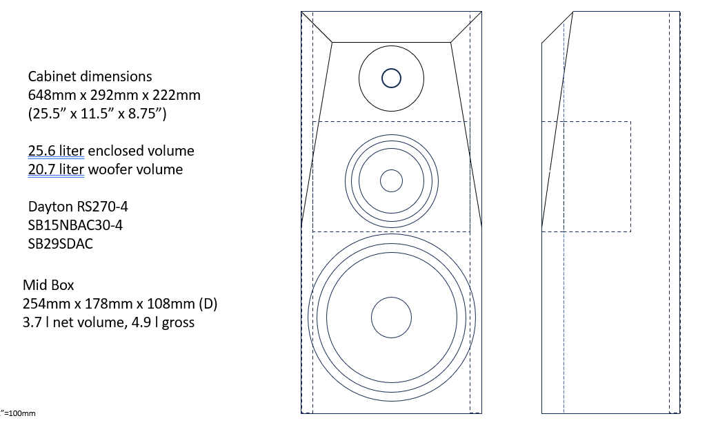

This is the current concept sketch, showing the size/position of the midrange enclosure.

Jim, will you be machining the frame of the RS270-4? From your drawing and my calculations the frame will overhand the 1/2 inch chamfers on the sides. I made this mistake on my most recent build, but that was because I screwed up and cut the chamfer on the bottom edge of the enclosure. I just lived with it, but you can just make your enclosure a little wider.
The sketch might be misleading... those dashed lines on the side of the cabinet show the internal cabinet wall, not the chamfering. The tapered bevels end well above the woofer.From your drawing and my calculations the frame will overhand the 1/2 inch chamfers on the sides.
