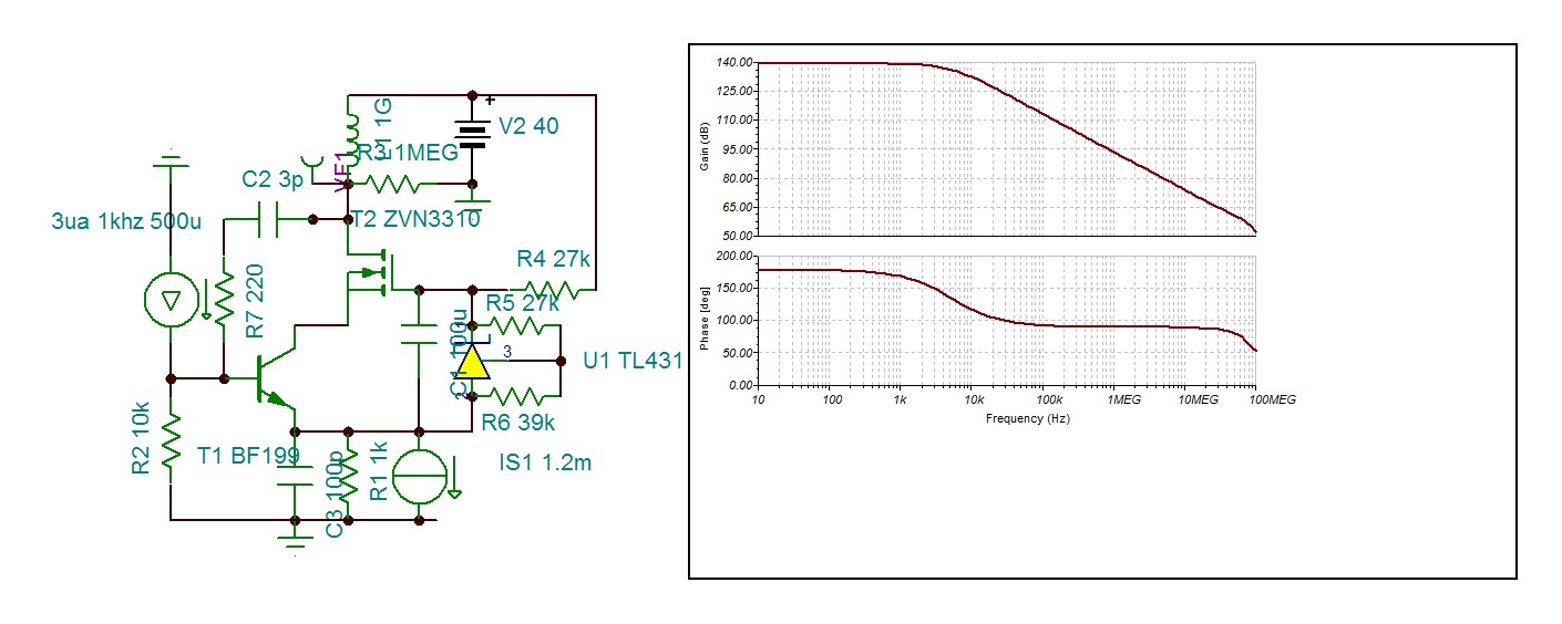

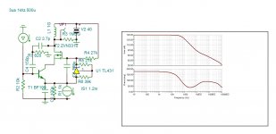

Why to use 2 poles instead of one? On the contrary what people think , it has nothing to do with the stability, but the purpose is to widen the open loop bandwidth. Very grand majority of designers don't give any attention to this aspect, after all there are one thousand and one opamps with open loop bandwidth of few hertz and they have the reputation of excellence. So why to bother about open loop bandwidth?
The first aspect is to have a uniform NFB applied to the whole spectrum, same treatment to all 20-20khz without segregation.
The second aspect comes from tube amplifiers. In Williamson for example the OL bandwidth is 10khz limited by the OPT, 20db NFB is applied . With large OL bandwidth , on the transient of the input burst , the phase starts nearly what it will be on steady state . Whereas in very low OL bandwidth , it starts with -90° phase shift to reach gradually to that of steady state. This phenomena , provokes transient distortion if multiple voices burst at same time interval. To hear what I mean ,listen with a low OL the requiem of Verdi YouTube . With my aging ears I can clearly hear enhancement to 30khz OL bandwidth my be a sensation to 40Khz but above I don't think is necessary , but if can why not.
The VAS circuit that will be submitted to all kinds of 2 pole compensation techniques has OL bandwidth of about 4khz, to widen it to at least 20khz.
There are four different types of 2 pole compensation I found . TPC,TMC,Cherry NDFL and dadod's OIPTC. I will try all of them , and evaluate comparatively.
If you have suggestions to try out this or that , please be welcomed .

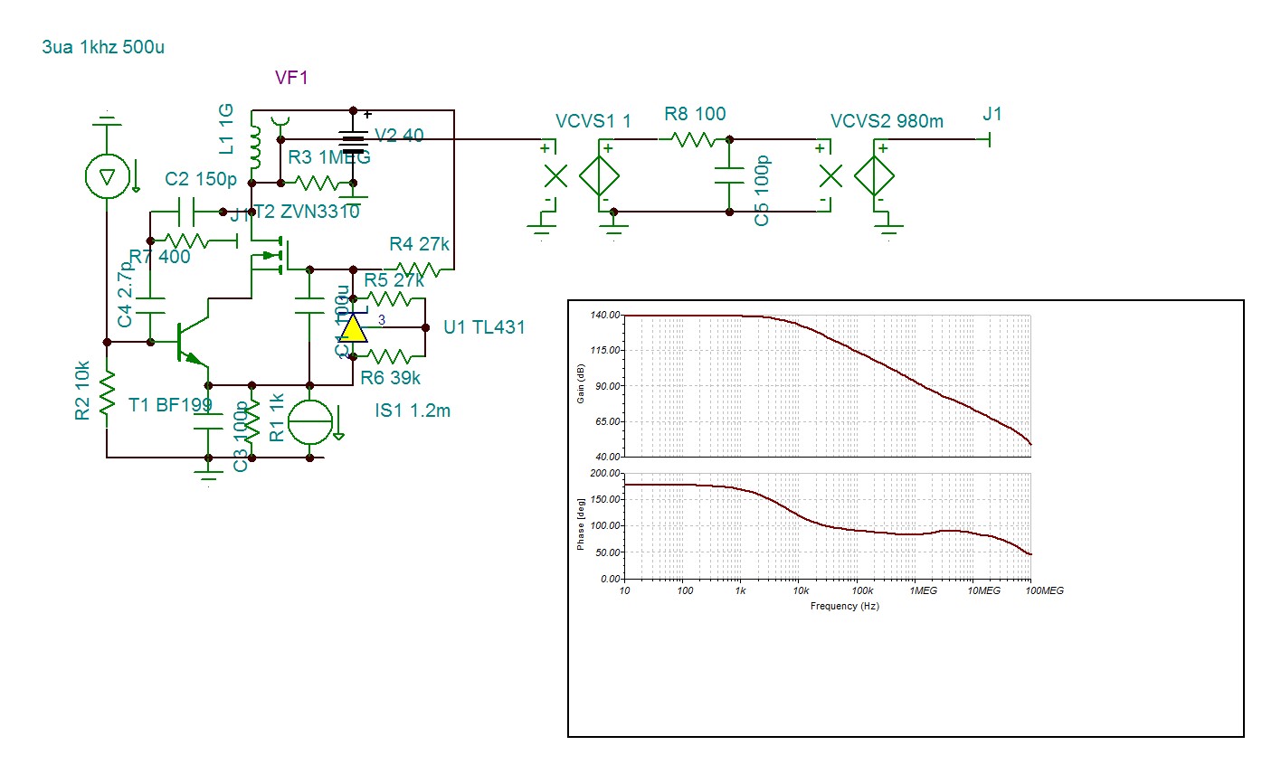

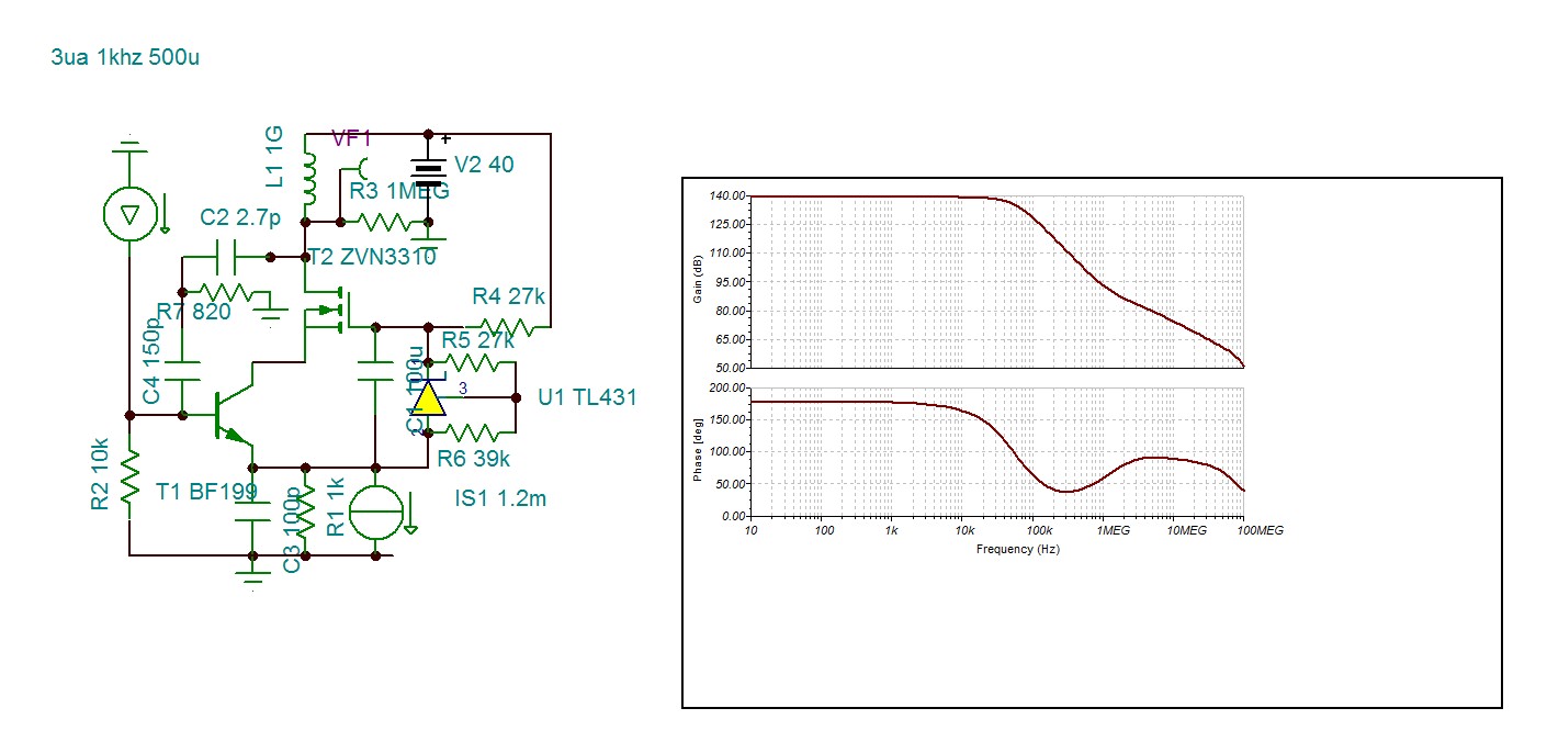

TMIC looks to be 1 pole . How does it extend the bandwidth. The literature you propose to bimo, is Bob cordell book TPC and TMC. If you are the author can you as dadod for his OITPC give instructions how to conceive.
Following the instructions/formulae given by Harry Dymond & Phil Mellor in AES Convention paper Nov. 2010 , I could very easily obtained 50khz bandwidth with identical high frequency character.
C2 adjusts the Dominant pole C4 adjusts the high frequency audio band cut 50khz, R7 adjusts the knee , the Q, if you prefer. The phase margin is 30° only at 300khz . If the fc is 20khz the phase margine is about 50°.

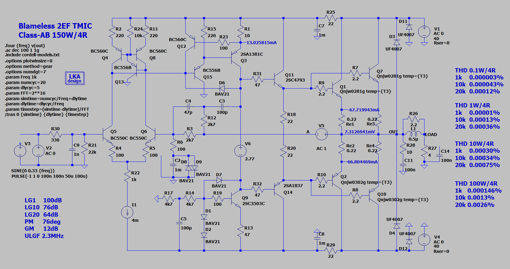

"MIC can be combined with TMC to reap the advantages of both techniques. The TMC network is merely returned to the input of the IPS instead of the VAS." BC
I agree. TMIC is two pole because the loop gain has two pole.
But my favorite is OITPC, because the THD characteristic. In OITPC, more small level output voltage, more less THD. THD increase with level output.

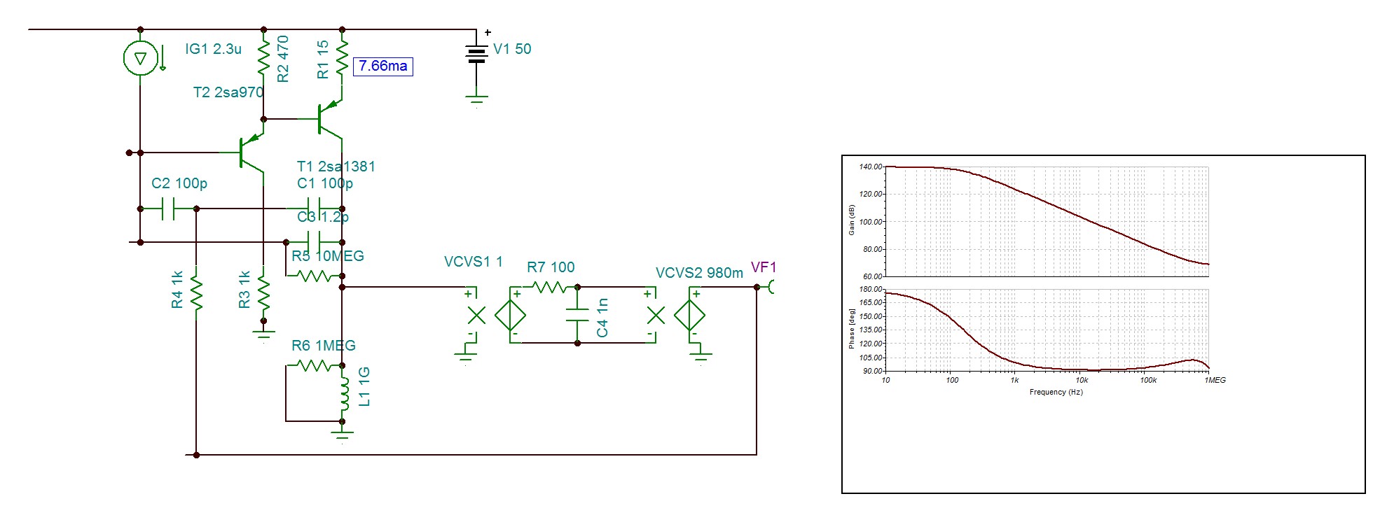

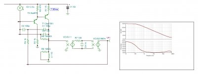

What phase margin you get on minimum about 30khz? The bandwidth is about 1.5khz how much it becomes if you bring the phase margin of 30° ? Just to compare with TPC. Do you think I can have any hope to bring the OL bandwidth 50khz?

Tomorrow , I simulate your VAS , and see where is the error. For me the 1K R30 is in parallel to C6 100pf except at high frequencies. I doubt about serial generator open loop measurement.
The same result you will get with Tian probe.

OK guys, we have gone over if TMC is a two or one pole compensation before. This is the conclusion:
- From the perspective of the input stage and the overall open loop of the amplifier (AOL), TMC is single pole. It is essentially a Miller compensation (single pole) that at lower freq. is wrapped around the second stage and OPS, and a higher frequency is wrapped around the second stage only.
- From the perspective of the OPS, it is 2 pole. This is a lot more difficult to see intuitively. I'll post an intuitive explanation once I come up with one. In the meantime, attached is an analysis I hand-wrote some time ago.

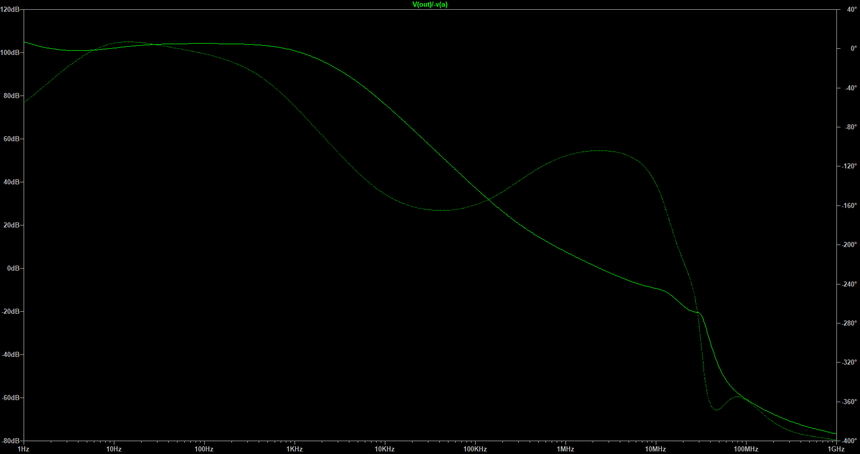

Damir, where is the second pole? For your measurement, you are breaking the loop before the 1k R30 VAS feedback. The VAS feedback makes part of the open loop function. The series generator must be inserted after R30.
