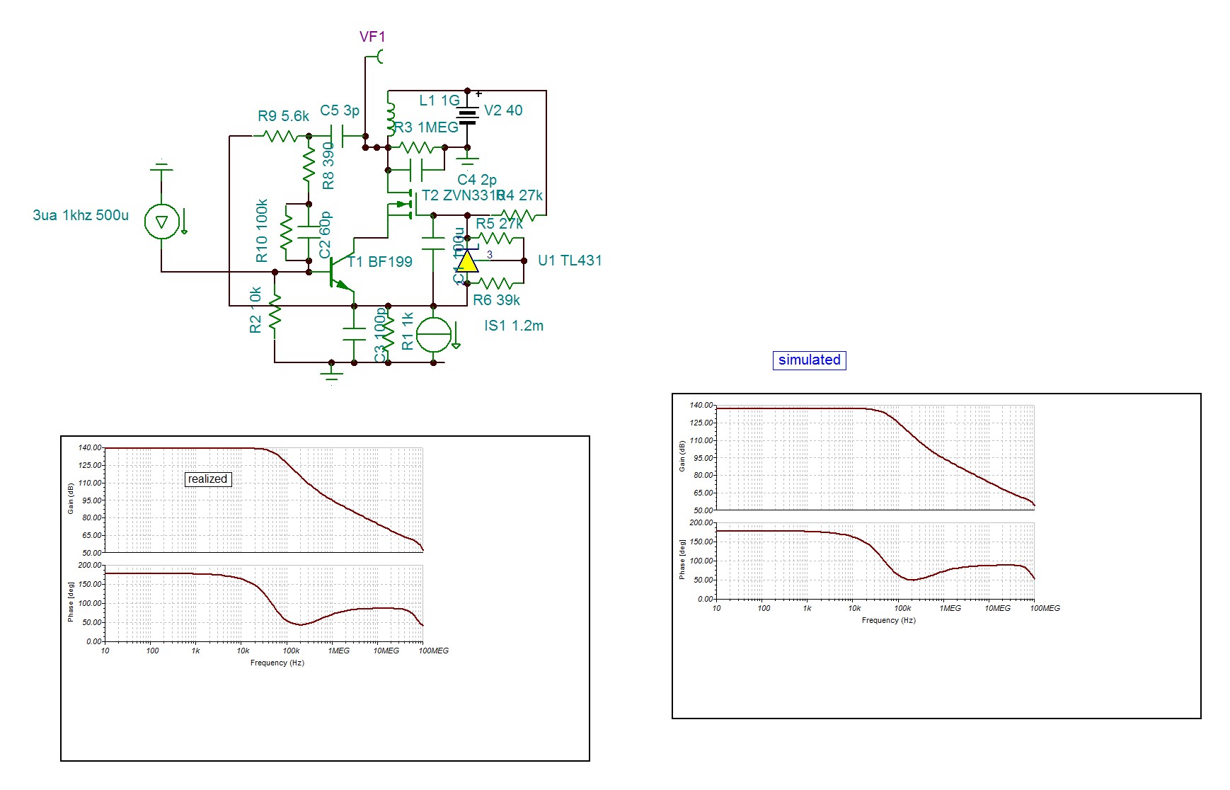

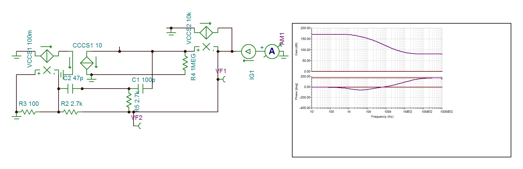

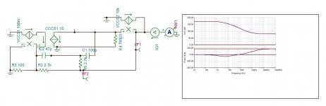

This is the approximate model of the amplifier. Unlike what explained to dadod , the 100pf capacitor is not a Cherry. Along the series 2.7k it shunts the input output of the power stage . When I measure the open loop response, I get similar behavior withe about 1.5khz first pole but minimum phase margin at lower frequencies and a second pole. The circuit not being easy to make precise estimation what is due to overall feedback what is internal, I measure the open loop character by the output impedance. There is the deception, the second order low pass function desapeared.
The curve shown is inverse of the measured voltage.

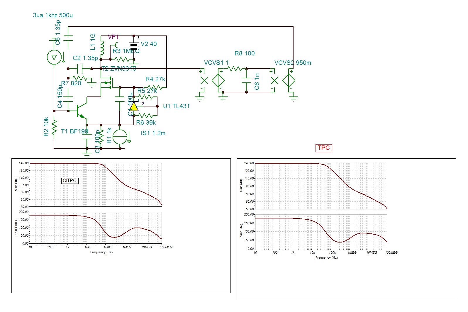

The 2.7pf has been split into two equal as instructed here OITPC - Output inclusive TPC (not TMC)
No comments.

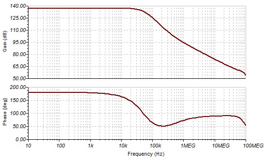

The future 2 pole compensation

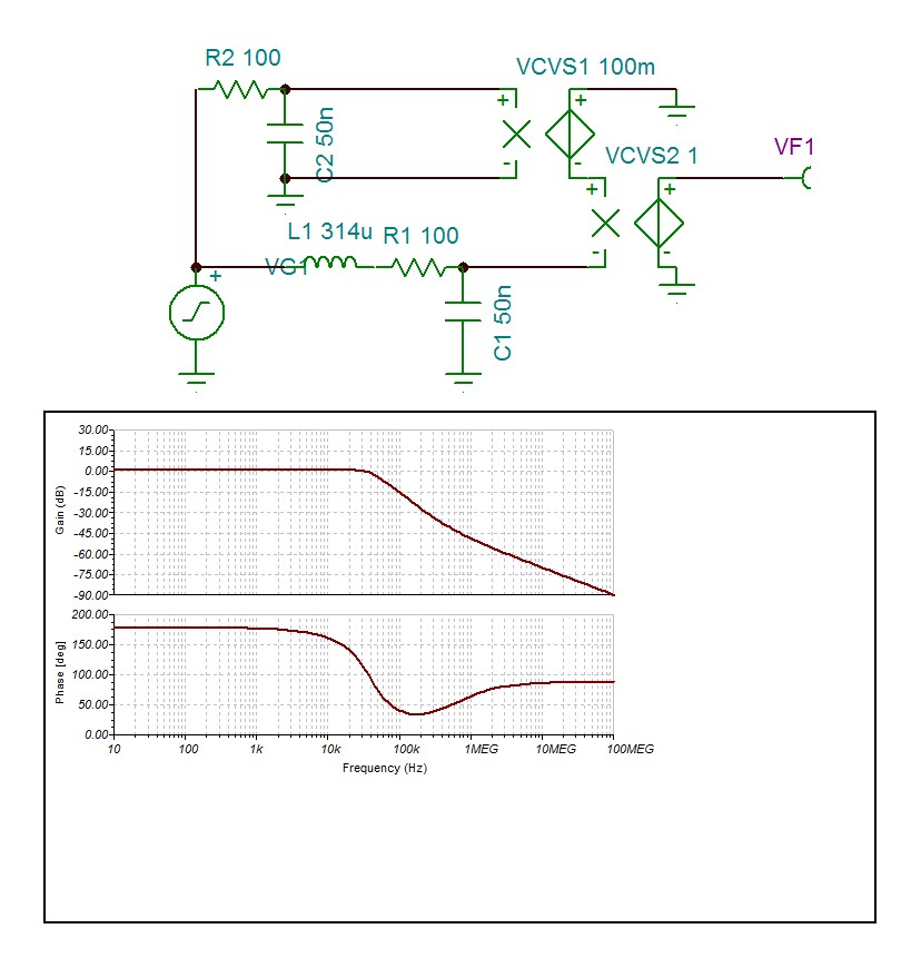

I started to design my own way of 2 pole. For me, a two pole is nothing but a second order low pass ,but degenerated to first order above a certain frequency. Second order means it is resonant with Q. Mathematically speaking a degenerated second order is 1/(s²+k₁s+w₁²) +k₂/(s+w₂). This function is simulated by LCR components
I tried a LCR network on the initial non compensated circuit , I could get a very good adjusted 46khz with 50° phase margin.
Now I will implement this transfer on the transimpedance VAS circuit using feedbacks .

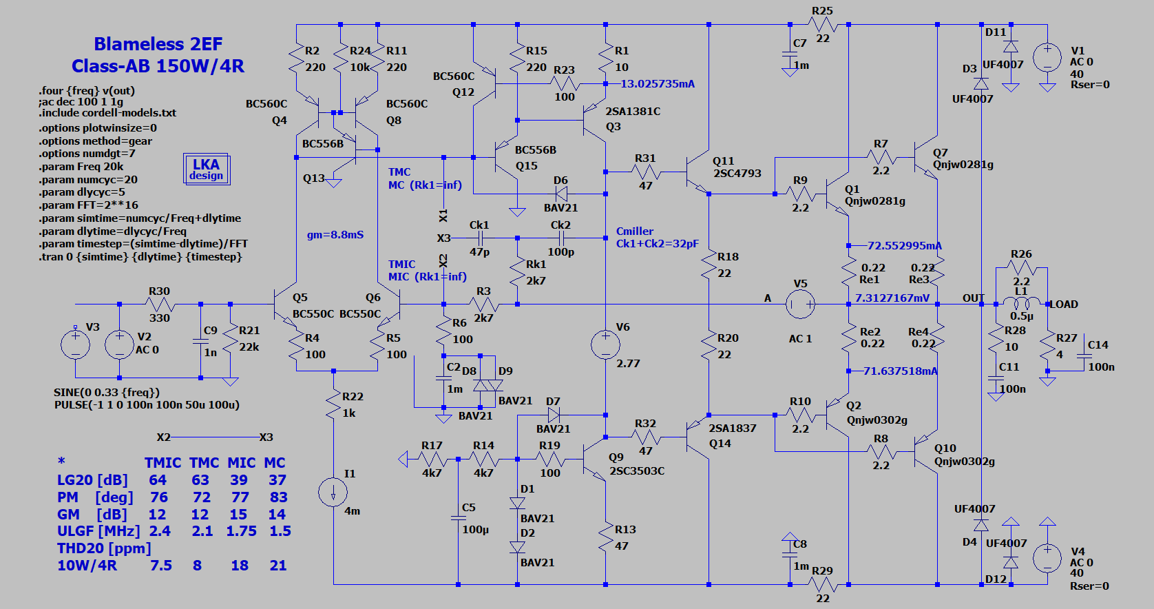

I made comparison between four compensation schemes TMIC,TMC,MIC,MC. Compensation capacitors values Ck1,Ck2 were preserved. THD20 follows the loop gain at 20kHz as expected.
Hi LKA, so let me start with making sure I get the acronyms:
TMIC: Transitional Miller Input Compensation
TMC: Transitional Miller Compensation (The one in Bob Cordell's book)
MIC: Miller inclusive compensation (The one that some call Cherry)
MC: Miller compensation
Questions:
- Do you have a good resource that describes TMIC?
- Given you tried TMC, did you try TPC (two pole compensation)?
I am interested to see how TMC, TPC and TMIC stack against each other.
Thanks!

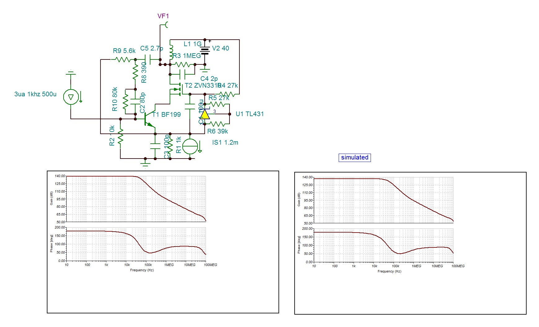

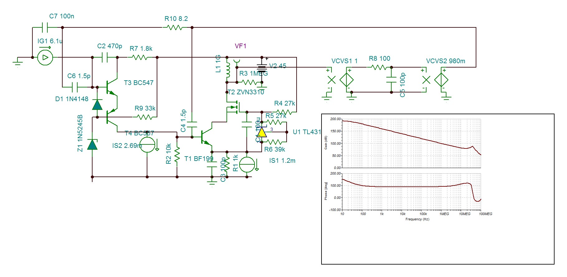

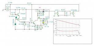

I started to implement the transfer function. This is the first result. It is slightly less than 50° phase margin but 50khz.
C2R9 adjust the cut frequency ,R10 adjust the Q, C3 the dominant pole and R8 the phase advance at 20Mhz. I added C4 2pf on the load to represent the input capacitance of the output stage.

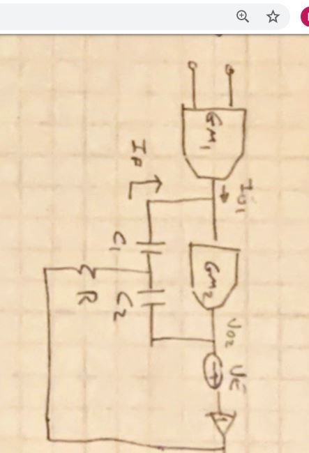

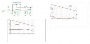

OK guys, we have gone over if TMC is a two or one pole compensation before. This is the conclusion:
- From the perspective of the input stage and the overall open loop of the amplifier (AOL), TMC is single pole. It is essentially a Miller compensation (single pole) that at lower freq. is wrapped around the second stage and OPS, and a higher frequency is wrapped around the second stage only.
- From the perspective of the OPS, it is 2 pole. This is a lot more difficult to see intuitively. I'll post an intuitive explanation once I come up with one. In the meantime, attached is an analysis I hand-wrote some time ago.
Enjoy!

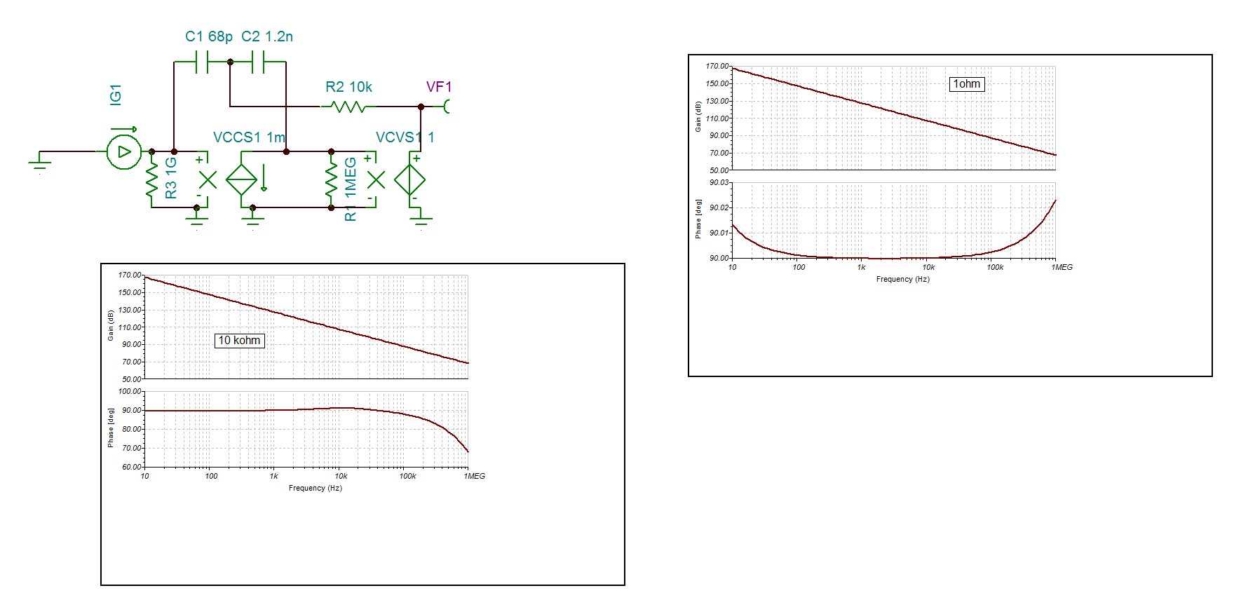

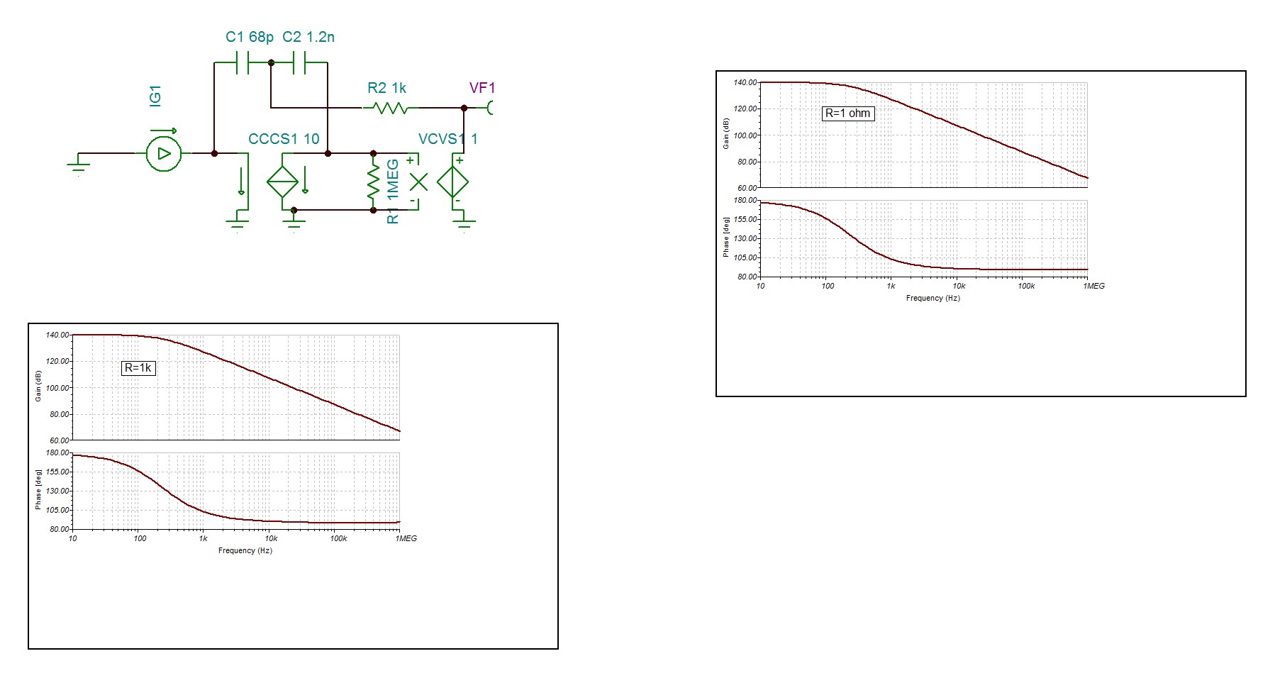

I looked carefully your calculation of TMS. First you consider the VAS as low impedance voltage amp , but it is high impedance 1M current amplifier. This is important because the cut frequency which will become the dominant single pole depends on C1 and the current gain. Second error is the calculation of the feedbacking network impedance . As assumed the C2 and R see the Vo. Then the impedance is 1/C1s +R//1/C2s that is
1/C1s +1/(1/R+C2s). You can see from this equation that at audio frequencies 68pf measures very high and 1/R is very high bringing the second term negligible . This makes it simply a first order low pass function. I simulated for you with R =1K and 1 ohm you see there is no any difference. If I bring the current gain to 1 the frequency is ten times higher.
Try to enjoy
Hayk
Hi Hayk, the ideal GM block has the following characteristics:
- Infinite input impedance
- Infinite output impedance
- Voltage in, current out.
- Voltage to current gain = GM
so your claim is wrong. Maybe you use different electronic symbols.
Also I have no idea what is TMS.
Second, the equations are correct and were verified in simulation. Try again.
These results have been published in the past in the forum, so results are not new. Search posts by Michael Kiwanuka. My value add was to show the equations.
Try harder.Try to enjoy.

This is the circuit of your calculation.
I am unable to understand how someone pretending of engineering minded doesn't see the resistor and the capacitor are paralleled.

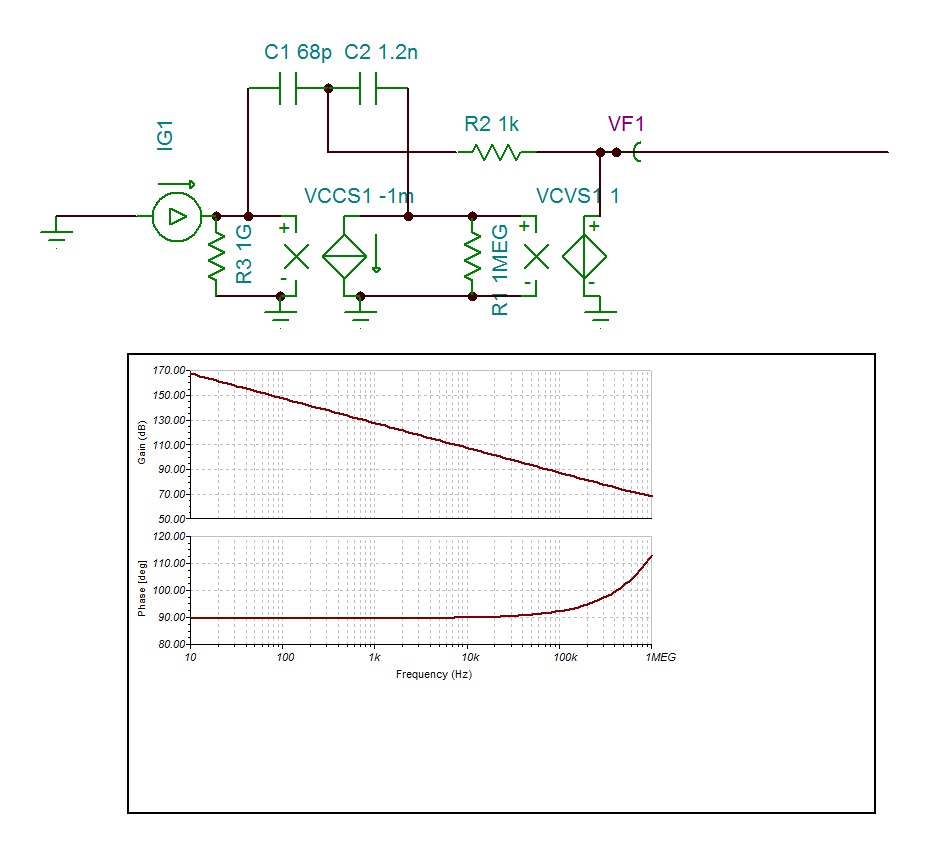

In your description Gm is positive. That is on the contrary of a mosfet , it sources not drains current. Here what oscillator it becomes. Most VAS, use grounded emitters , why you didn't chose inverting current multiplier?
