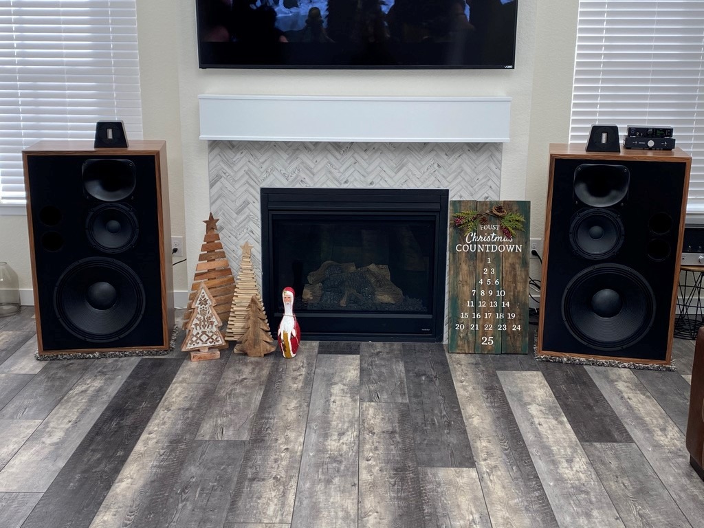

To continue my speaker building hobby I’m posting a complete pair of Troels Gravesen’s “The Loudspeaker“ TL-1 which you can look into easily with a simple web search if you are not familiar. This version uses the Hypex plate amplifier for subwoofer duty and based on its efficiency only requires a handful of watts to drive the top end. I’ve been happy driving it with 300b tube amp as well as solid state amps including a DIY Pass Aleph-J. They also sound great with several class a/b amps. Describing sound is very subjective so I’ll just make a few observations based on my opinion. The crossover as designed by Troels seemed a little mid range centric to my liking so I very slightly padded the midrange (in midrange cabinet easily removable). Overall the presentation is the most dynamic I’ve heard to date from any speaker. These speakers are very smooth sounding and capable of playing to ear bleeding levels. Of all the speakers I’ve owned it seems friends and family connect with these more than anything else I’ve had because they are easy to listen to yet present detail and dynamics in a way few other speakers can. I’m a FOH engineer and regularly get to mess with PA gear and can say with confidence that the 18N862 is the best sounding woofer I’ve encountered!
Here are some additional details on the build:
- Crossover uses superior caps on the midrange and alumen-z on horn and super tweeter.
- The Hypex used is bridged 252 instead of 501 as provided in kit (original USB program for woofers is included as well as plans)
- The build is out of 1“ Baltic birch built by me
- I contracted out the finishing in rosewood with black painted baffle. The quality of finish is like 8/10; I wasn’t thrilled with what I got compared to previous finishes obtained using a different furniture maker but it’s decent. I’ll add some additional photos to show you what I mean. I have ~$1500 is the finishing not including my cost to build the cabinets which easily is $500+ (1” Baltic Birch where I live is very expensive now)
- Current cost of kit without any fees/shipping is $2513 USD + cost of drivers from Lean Business UK is $2529.09 again not including any fees/shipping

Thank you for the compliments! Reselling primarily because I’m a dipole fan and want to fund a somewhat high-end dipole build and really enjoy speaker building process and am always looking at “what’s next”. I don’t think I’ve ever kept a build very long
So one of the primary reasons I built the TL-1’s is because I have been playing with, building and enjoying lower wattage class A amps. So for me, having the bass split out allowed me to try out various low wattage amps on the top with great success. Prior to TL-1s the LX521’s I built were fully active using an analog signal processor. I personally think there is an audible difference between different ADC/DAC solutions and prefer analog up top. For the LX521’s I went from miniDSP to an analog signal processor and vastly preferred the analog solution. Running fully active has its advantages and disadvantages so just make sure you know what you are in for.
My next build will mostly likely be fully active (unless miracles happen and passive crossover is possible). However, I’m also using a DSP that has ESS 9038 pro DACs and sounds good to my ears (ZAPCO HDSP). That was not my observation with the miniDSP 4x10. I’m sure there are some on this forum that would disagree with my observations but hey you do you. I have used DBX drive racks before in a pro environment but can’t comment because the application and quality of other components in the chain were so different……
Overall, if you like the sound of the passive version then you free yourself to play with other components later. While I have 0 eq on them right now, I do run an ADI-2 pro DAC which does have EQ so that you can tweak the response slightly without much of a downside(not crossover of course).
I’m not sure where you are on the loudspeaker design front but getting to the passive crossover’s level cohesion could be done actively but it’s by no means a trivial task as Troels is a very skilled designer.
So I’ve pallet shipped across the country a few years ago and it was $400-600 if memory serves. I’m guessing it’d run about $1k or so given crazy inflation lately….. I’d consider keeping the 18N862 to cover shipping cost as I’d love to use them on another project?! If you get serious let me know and I’ll get a real quote but it takes a few hours of work on my side to sort out as it’s a bit more complicated than shipping a box. Of course you are always welcome to vacation in Colorado as the mountains are beautiful this time of year (I actually sold a pair of speakers this way in the past!)
