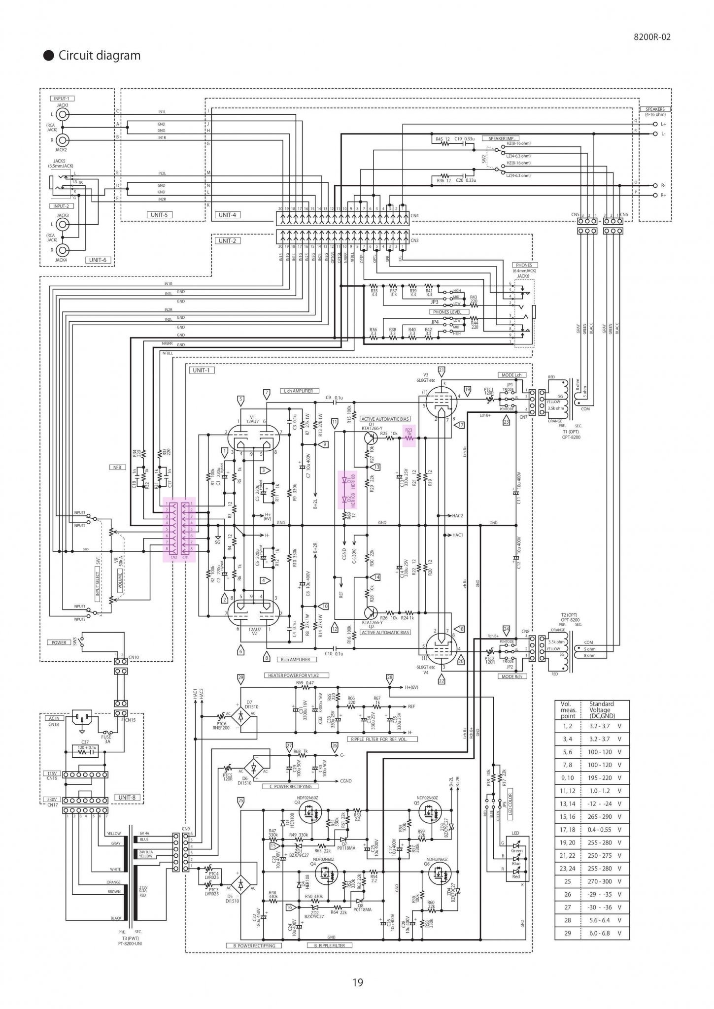

I built Elekit's TU-8200R tube amp last week and instantly became a tube convert. In triode mode the 4w output was wonderful (and loud) on my S2TLK speakers. Unfortunately I had got the speaker output socket colours mixed up and took it apart to correct them. The amp has three circuit boards inter-connected with multi pin connectors. I didn't connect the final main board pins and on power up got a hum in the left speaker and no music. I probably should have shut down straight away but messed around checking the input feed. After correcting the mistake complete silence from the speakers though the tubes were lit up and I got sound from the headphone out. I ran over the boards with a DMM and got dodgy readings from the two diodes D1 & D2 and the 12ohm resistors R19,R20,R21&R22 were reading 6.1ohms. I assumed that the diodes were more likely to be part of the problem and I have ordered replacements. I noticed that R23 was 12ohm and should be 1Kohm and have replaced this.
Taking the resistors and diodes out I checked them again with my DMM and a component tester and got differing results with the tester failing the diodes and resistors that the DMM was happy with. I double checked with a second DMM. I have included the circuit diagram and marked the connector and components in pink.
I will be grateful for any help. I coming round to doing a voltage check as the diagram and circuit board have all the relevant points and voltages marked.
What I am finding difficult is identifying correct replacements and ordering them. Is there a kit or advice about creating a personal store of components. It's very expensive ordering the odd few resistors or diodes. I have been using Mouser.

Hi Chris,
Thanks for the schematic. It's very helpful.
You mention mesauring 6.1 ohm at R19 through R21, presumably measured in-circuit with power removed. This sounds about right--- R19 and R20 (and R21 and R21) in parallel make 6 ohms.
Would you be more specific about "dodgy" readings on D1 and D2? Note these components are shared with both channels. If one channel works properly, this bias source is probably not the problem in the other channel. Measuring operating voltages is probably the most efficient trouble-shooting technique. Remember that the working channel can be a guide to expected voltages in the defective channel. Be safe, one hand in lap while probing, etc---
It's possible the amp is working but signal path is open. Depending on your interest in this hobby, an oscilloscope can be invaluable.
Good luck!
Good luck!
If you were testing D1 and D2 in-circuit with a multi-meter's diode test function, these readings may be reasonable because of adjacent circuitry. If you observe about 1 to 1.2 V with circuit in operation, the diodes are likely behaving as intended.
