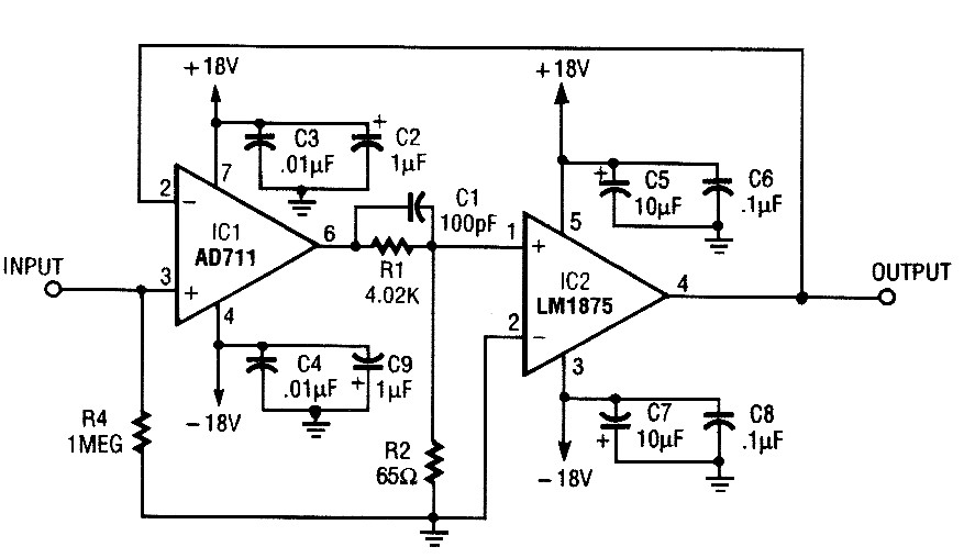

Thanks, I'll definitely follow these leads (the link works). Reviewing some of the composite amp papers I have, I haven't found anything similar to what this schematic shows. Maybe I expected it to jump out and bite me, so I'll have another go at it. The original article does have a table showing several alternate values for the filter, but I'm unsure about what does what eg how is the R2 value determined? The math was probably too deep for a RE article; it could be too deep for me. I figured I could sub some "tweak values" and analyze the o'scope results.
Sorry for my ignorance but I just discovered the concept of "composite amplifiers".
For audio power amplifiers the idea, in short, seems to be the use of a high-quality OP-AMP for control of a less good power amplifier such that the overall performance is dominated by the high-quality OP-AMP?
I found an AD711/LM1875 design on the net.
Is it correct that the power amplifier needs a high bandwidth to keep the overall bandwidth reasonably high?
Is it possible to use a class D power amplifier or is the bandwidth to low to keep the "outer loop" reasonably fast? Does the inherent 300KHz-600KHz ripple perturb the outer regulation loop?

I've been making composite amps for quite a few years now. See my Modulus-series of amplifiers.
The basic idea is to perform error correction on a power amp by using the loop gain of a precision opamp. The topology has been used for decades to get DC precision on high-speed opamps. At the bottom of my Modulus-86 page, you'll find a list of references that you'll probably find insightful.
Composite amps are relatively straightforward to get to work if the output stage has much higher bandwidth than the control opamp. For audio applications, the output stages are pretty low bandwidth compared to the control opamp, so stability becomes a serious challenge. It can be done, though, as I show with the Modulus-86 and beyond.

As far as using it on something like a TPA3118 or so, well, if you look at the overarching topology of the Hypex modules, then we're not too far off. It's going to be pretty tough to get much extra loop gain into the outer loop, even deep into conditional stability and will require pretty high order filters to pull the loop gain out of the outer loop over a narrow bandwidth if you don't want to waste your time.
IMO, this may be a case where an error correcting amplifier will work much better to decouple the respective bandwidths. (acknowledging that they're tied together AND that I have essentially zero experience doing so)

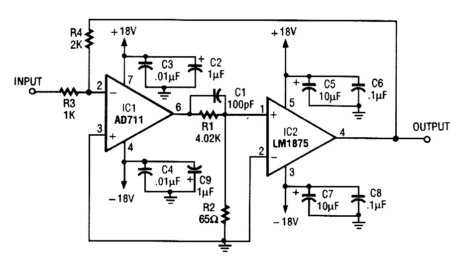

Anybody build any of these?
I am tempted, since I have the chips.
Are there any advantages of one or the other? Inverted, non-inverted?
I've read a claim (somewhere on diyaudio years ago) that for a general op-amp, inverted has less distortion because the + and - inputs stay at essentially the same voltage relative to ground (and the power inputs), whereas moving the inputs up and down as in non-inverted changes the bias slightly, this'n'that, making more distortion.
Headphones amp are almost "too easy" otoh so I'm not sure it's really worth going there. It's no big deal to find a high output very fast one to put inside the loop of a slower, higher precision one. The challenge of composite power amps is to manage a big slow amp as the output.
That's why I linked the error correction post by jcx
That's known as common-mode distortion. It's a thing for some older opamps. More modern parts perform better in the non-inverting configuration as they don't have any/much common-mode distortion and, thus, benefit from the extra 6 dB of loop gain that is available in the non-inverting configuration.
