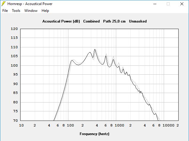

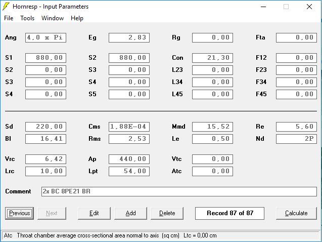

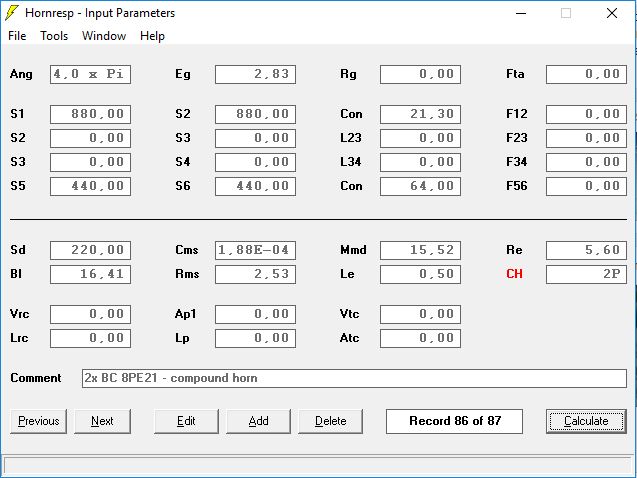

I was inspired by this thread and also the debate at the FB group to try to find out in HornResp what a pair of 8PE21s could do in this arrangement. Here are some results. With a bit of EQ, I definitely see some potential. The folding would be like the C-2D split path kick bin a few posts back - but I think it will be a challenge to make the rear resonator with correct lenght. I guess I will need to make a small spreadsheet for that and play around with the numbers.
The pair of 8PE21s seems to go high enough to cross over to a reasonably sized horn with a 1" or 1.4" driver.
Anyway, I am waiting for the new super planar 2x8 to be released before cutting wood, this is just a mathematical exercise🙂

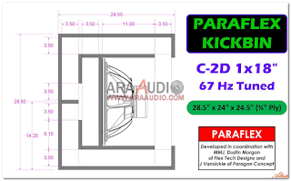

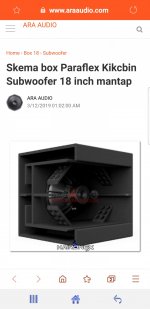

Yes, it is a Paraflex C-2D kickbin and that beautiful rendering is made by our friend Ty "Kaironex" Cention ..
Ari or Ara from Bintang Audio Indonesia likes to use Ty's 3D artwork to promote his business in Asia ..
