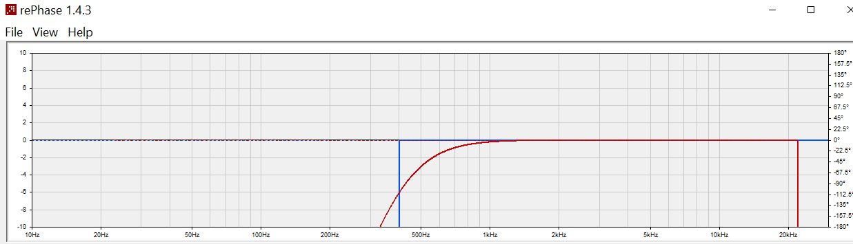

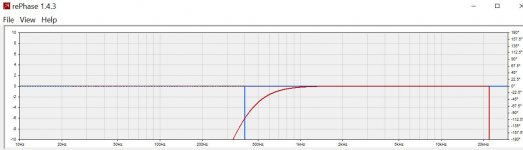

Stay aware that steep high pass corners can greatly increase loading at the corner, relative to conventional order xovers.
The red trace is a LR 24 dB/oct, which by nature is -6dB at 400Hz xover.
Blue is a 400Hz brick wall.
The brick wall's 6dB higher level allows double the voltage and excursion at the 400Hz knee.....(compared to the LR24)

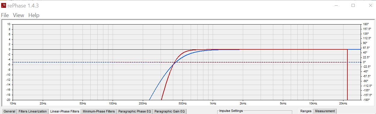

How far down will you need the CD to sum? If to say to -12dB, like in LR 24 graph posted above, the brick wall would need to move down to about 300Hz.
My take is once 12dB down, the CD probable doesn't need any more protection than the LR24 continues to give on its own, going lower..
So i think it comes back to the knee area.
I've decided a linear-phase LR 48 dB/oct is a good compromise for taking a CD low and not banging the knee area too hard.
Here's a LR48 at 400 Hz against a LR24,

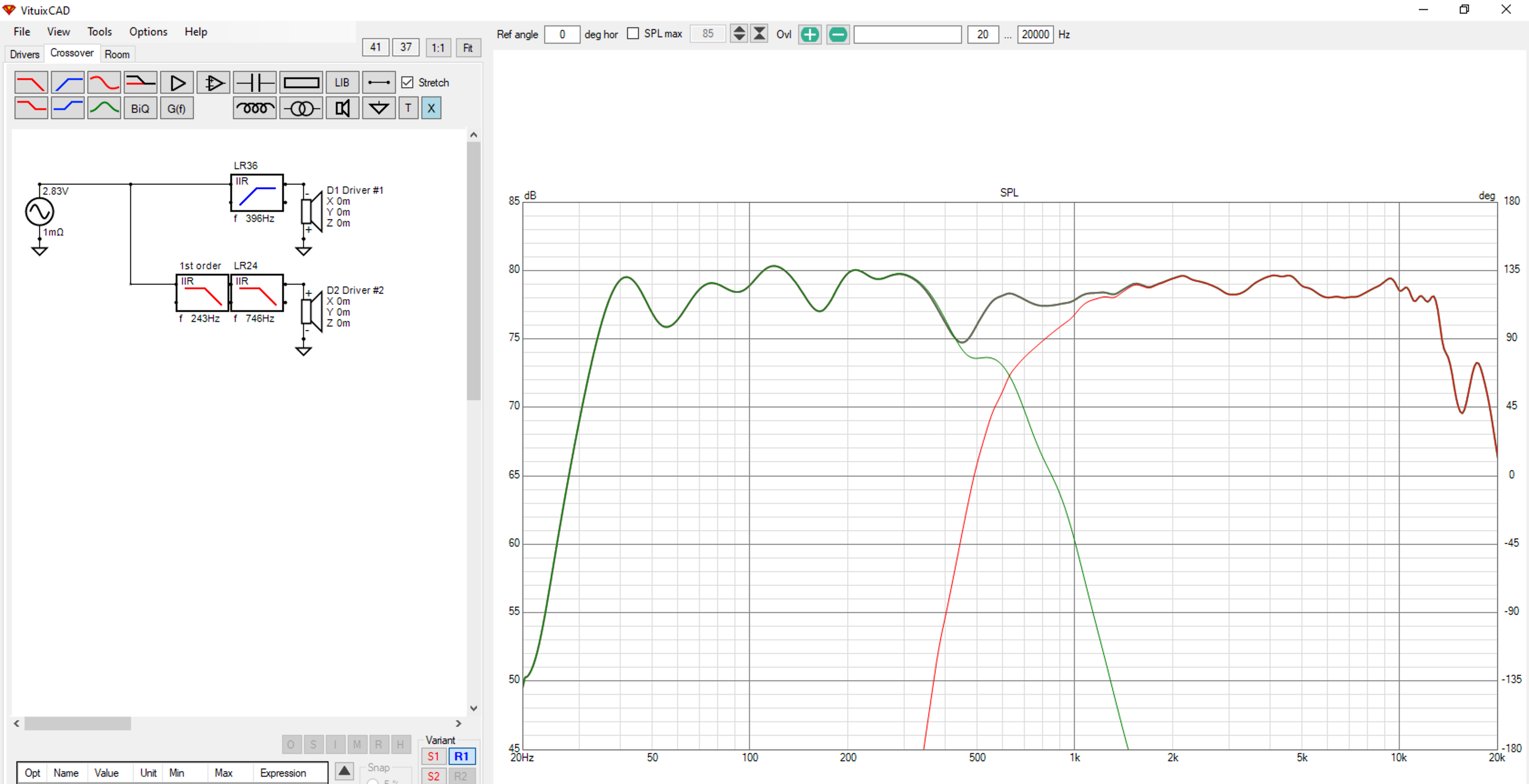

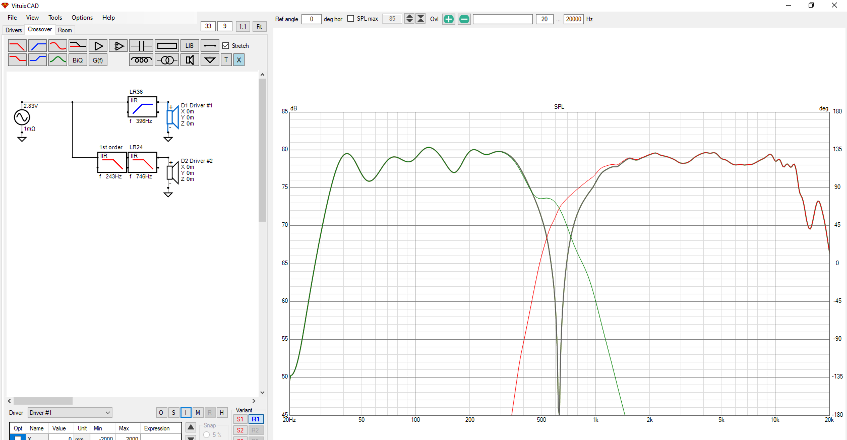

Here's an example of Faital HF142 in LTH142 using the natural rolloff of the driver for a LR4@630 Hz with a LR6 DSP filter at 400 Hz for protection:
Good idea, bad idea?
Just try it. But the drivers xyz positions are bot 0/0/0. Could you check this? Otherwise you will not get correct results. Generally, if both drivers are aligned to the fron the HF part must become negative with respect to the woofer for longer horns like LTH142.

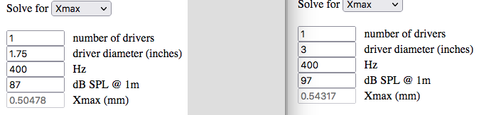

At 400 Hz, a wide angle (90 degree) "waveguide" or "undersized horn" will provide very little gain, the output level would be little more than that of a similar size cone driver with similar excursion.
Most HF compression drivers have little more than 0.5mm distance between the diaphragm and phase plug, few have more than 0.8mm.
The DE250 has a 1.7" (44mm) diameter diaphragm, at 400 Hz it should do about 87dB before the diaphragm hits the phase plug, a 3" could do about 97dB (peak) at one meter.
Polyimide diaphragms (like in the DE 250) won't sound as bad as metal when they hit the phase plug- kind of like the difference between substituting a Frisbee for a cymbal .
If the drivers don't ever exceed that level, no problem.
Just for the experience, play a 400 Hz tone through the horn/driver at a "pretty loud level", then add in a 1kHz tone, tell us what you think of the 1400 & 1800 Hz tones you hear in addition.
