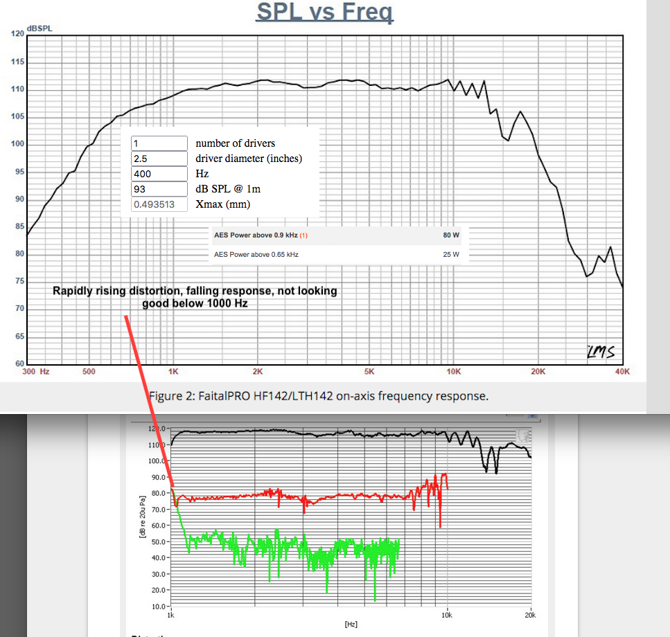

1) 97 db at 400 Hz would mean 109 db at 600 Hz (12 db higher in level), so that should work out fine one would think?
2)Regarding playing a 400 Hz tone then a 1 kHz tone; is it intermodulation distortion you're aiming at here? Or something unique to horns?
1) No, the driver is dropping at 20 dB per octave below 600 Hz, distortion is rising dramatically below 1000Hz.
2)IM is not unique to horns, but crossed too low, the horn driver will have far more than the cone driver at the same frequencies.
Even order harmonic distortion is fairly tolerable, IM just sounds lousy- "gargly", "blatty", "trashy"...

The DE250 has a 1.7" (44mm) diameter diaphragm, at 400 Hz it should do about 87dB before the diaphragm hits the phase plug, a 3" could do about 97dB (peak) at one meter.
Polyimide diaphragms (like in the DE 250) won't sound as bad as metal when they hit the phase plug- kind of like the difference between substituting a Frisbee for a cymbal .
If the drivers don't ever exceed that level, no problem.
Just for the experience, play a 400 Hz tone through the horn/driver at a "pretty loud level", then add in a 1kHz tone, tell us what you think of the 1400 & 1800 Hz tones you hear in addition.
Art
For 2.5 inch diaphragm max SPL at 400 Hz should be 93 db before hitting xmax. The SPL difference between 400 Hz and 600 Hz on the Faital combo is 12 db, which means it should be able to do 105 db at 600 Hz.
Given distortion still remains acceptably low ofc. Audioexpress' distortion measurements are a bit questionable in my experience.
1)
2)IM is not unique to horns, but crossed too low, the horn driver will have far more than the cone driver at the same frequencies. .

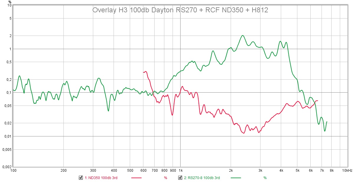

Surely only if the cone driver is actually of a larger diameter right?
Don't mean to question your insight here btw, just trying to learn

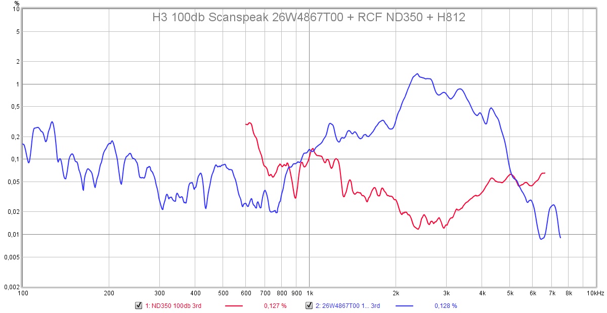

Here's some interesting distortion graphs comparing an RCF ND350 (on a Dayton H812) to a couple of cone drivers. RCF remains considerably lower in distortion up until around 800 Hz even though it's only a 1,75 inch diaphragm driver.

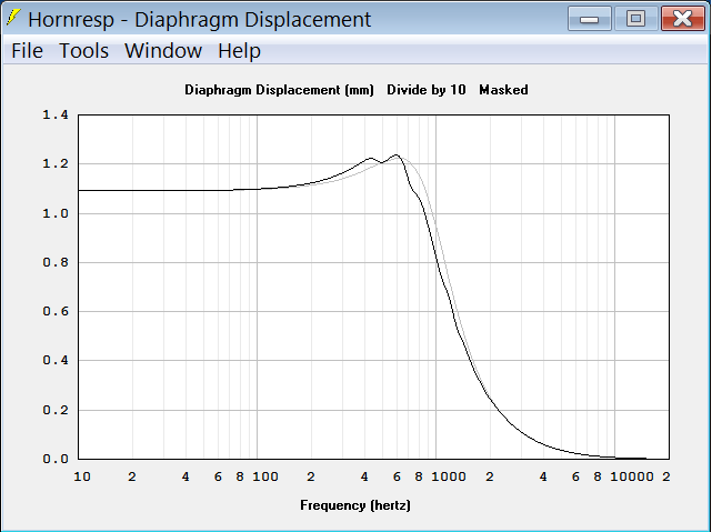

Displacement increases at lower frequencies, but is it due to horn loading around cutoff? Can you demonstrate this?
Just take two horns of the same type but with different size/cut off frequency. Measure the distortion. At the smaller one it distorts up to a higher frequency.
The acoustical impedance shows the acoustic coupling of the air to the membrane. Below a certain frequency - depending on the size of the driver - the coupling gets worse, the sound pressure level drops in a slope.
Acoustic impedance - Wikipedia

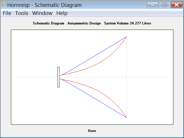

As you wish. Here are two horns. They have very different cutoffs, more than an octave and a half separation of the acoustic impedance slopes.
Interesting. I thought:
Mouth area = cutoff
Depth = loading/gain
