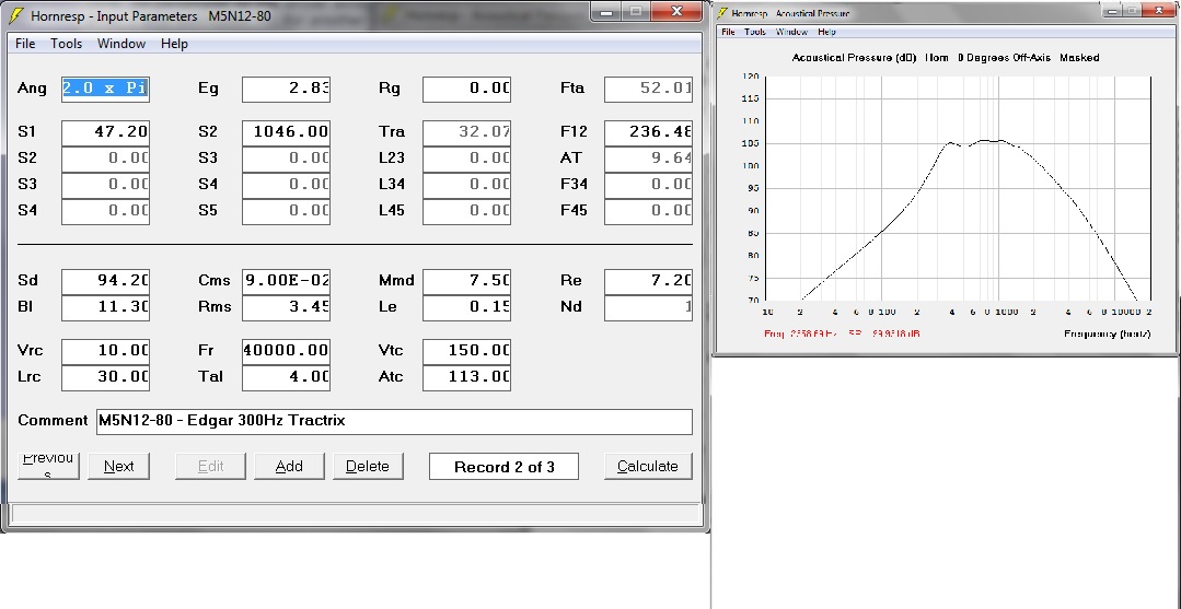

Estimating Atc brought me to a confusion about the definition of Sd. I believe Sd is the cone area plus dust cap area. Like if we cut the cone out of the driver, lay it flat on a table and measure that surface. So Sd has to be larger than Atc. But when I estimate Atc (as the size of the throat = size of the cone, perpendicular to the driver axis) I get larger figure for Atc than Sd...Could you please explain?
BTW, I also estimated Atc for another driver and also came up higher than Sd. Must be a misunderstanding on my part.
Increasing Vtc and Atc (larger than 0) worsened the simulated frequency response. Maybe I should compensate by increasing the Sd:S1 ratio to 3:1?
Sd is speaker displacement area, generally the diameter of the cone + about 1/2 of the surround diameter, the outer portion of the surround hardly moves so Sd is always a bit smaller than the cut-out area.
Atc should be the area equivalent to the diameter of the entire surround, a bit larger than Sd.
The HF rolloff will probably be less than the simulation shows (no cone breakup is modeled), but by all means compare different compression ratios and compression chamber size.

Thanks again. The drawing was clarifying indeed. I had a wrong understanding of Sd.
New run, with adjusted Atc and Vtc. To reduce the latter from 200cm3 I envision a recessed fit to the horn. I need to draw it.
If the HF is likely to really roll off slower than simulated then I should be pretty good for 300-2500Hz. Right?
What is Hornresp assuming in terms of shape of horn mouth? Round? Does it matter if I want to model a rectangular Tractrix like Edgar's? I would imagine it does matter. But how can I reflect it in Hornresp?

Any tricks to make the top end drop at a slower rate than what was depicted on my last post?
The lower end looks good to about 350Hz. Smoothness from 350 to about 1800Hz looks good too, around 105dB. I wish I were -3dB at 2000Hz.
Simulating the M5N12 vs 605Nd shows the latter achieving a higher sensitivity, but dropping faster at the higher end. I'm skewing towards M5N12.
Generally speaking, you might try a smaller throat. I should add that using a higher compression ratio might indicate the need for a phase plug. Beamwidth may also be quite narrow at the top end.

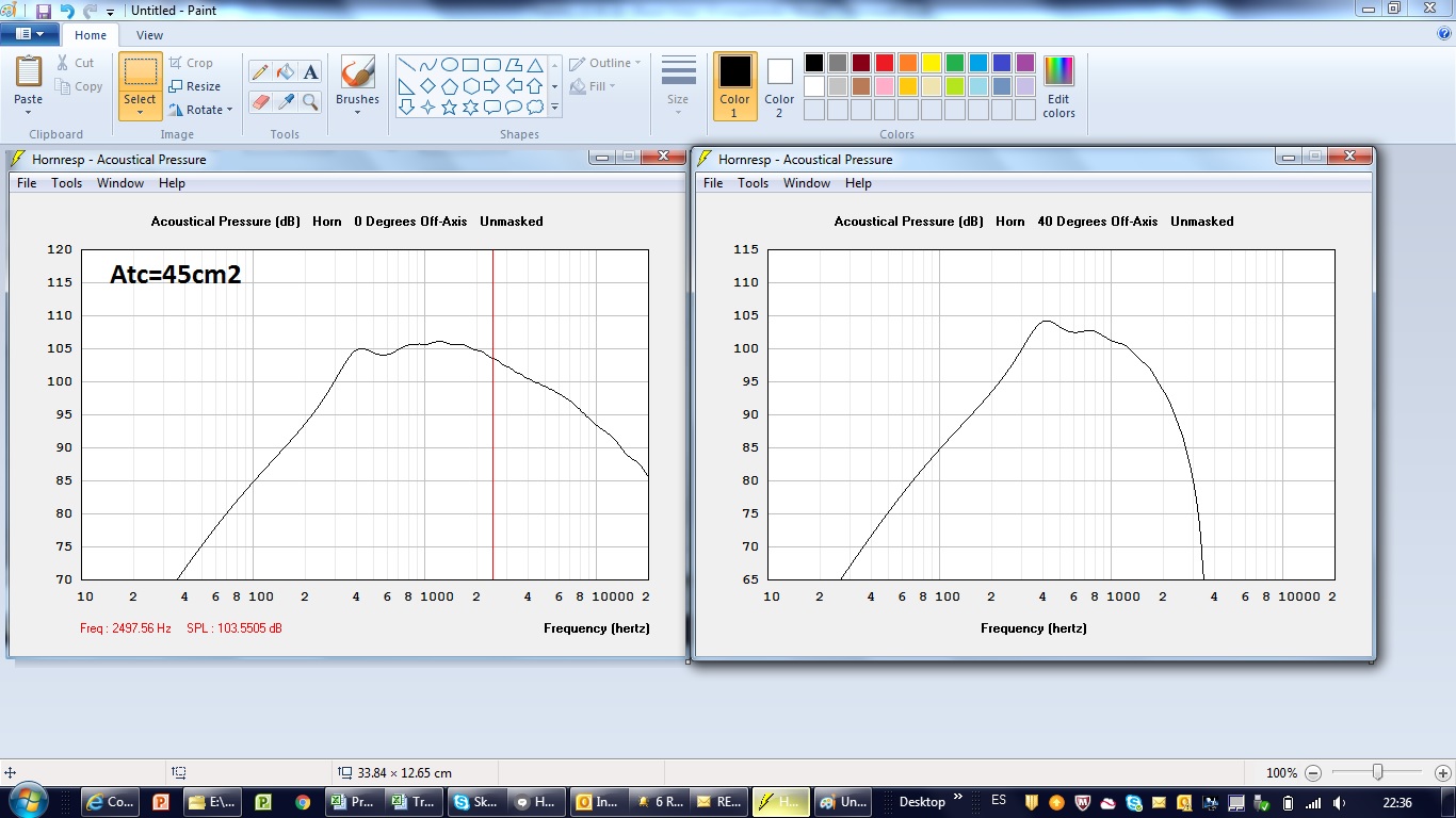

Excellent. Indeed, dropping Atc from 113cm2 to 47cm2 (Sd/2) improved the higher end significantly. Beyond Sd/2 resonances seem to show up - I'm guessing they resonances...wiggles in the SPL response.
Off axis at the higher end is not looking too good. But it hasn't worsened when going from Atc 113 to 47cm2. I find this a little odd. A 5" direct radiator shouldn't have such a narrow dispersion at 2500Hz as this horn seems to have. 53° at 2500Hz...Puzzling.

The horn would be constricting the beamwidth. Along its length where the horn becomes large enough the primary mode of the highs will continue with the angle as thus defined, and influenced to some degree further along including diffraction. Compare a beamwidth plot for tractrix, and a conical horn.
EQing a conical waveguide is acceptable/necessary, and the flip side of the narrow beamwidth for a tractrix horn may be that EQing for flat power makes it too hot on axis (not that I'm implying anything).

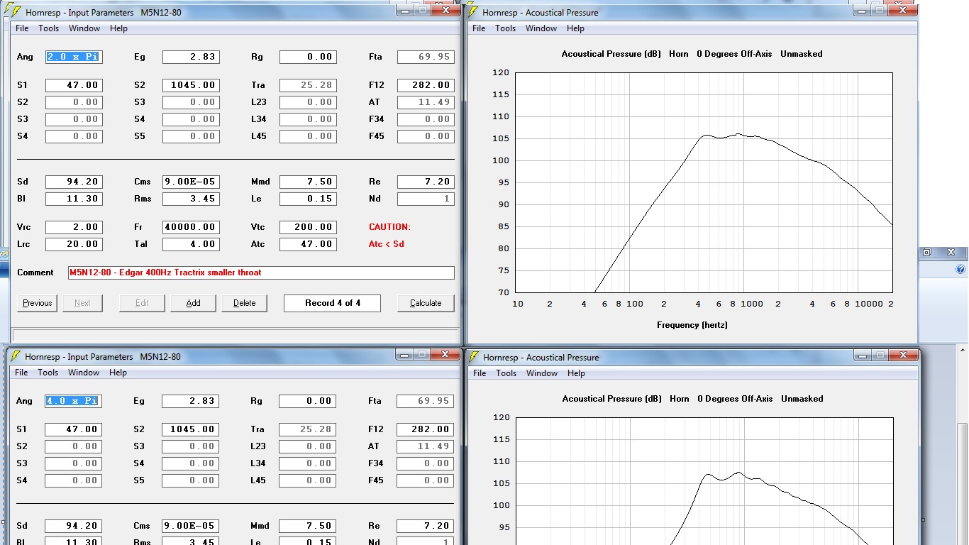

I continue to read papers and play with Hornresp. I am not sure if I should be modelling using 2xPi or 4xPi for the radiation angle. I can rationalize 4xPi because the midrange horn will be far enough from any walls and floor...and can also rationalize 2xPi because at these frquencies the horn itself prevents any waves to go around the plane of the mouth of the horn...
Bottom line, I'm confused :confused:
And it has a significant impact on the simulation, per the attached.
What you say is reasonable and it would probably lie between the two but as far as I choose to assume, the radiation space parameter applies a generic loading condition. I'd want to ask David to be sure.
The way I see it I prefer to go with well defined terminations and boundary conditions although they aren't always essential. This may for eg. mean taking conical and hyp/ex horns to a baffle when appropriate, and running LeCleach horns far enough around, and using walls properly when corner/wall loading.
What works for the highs may be different to what works lower down. The natural termination space of some horns isn't clear, ie: a tractrix curve appears geometrically to end in a baffle but perhaps it should be as the LeCleach.
I prefer to examine each case at each frequency to decide how the mouth should be loaded. For example: by controlling the directivity index.
