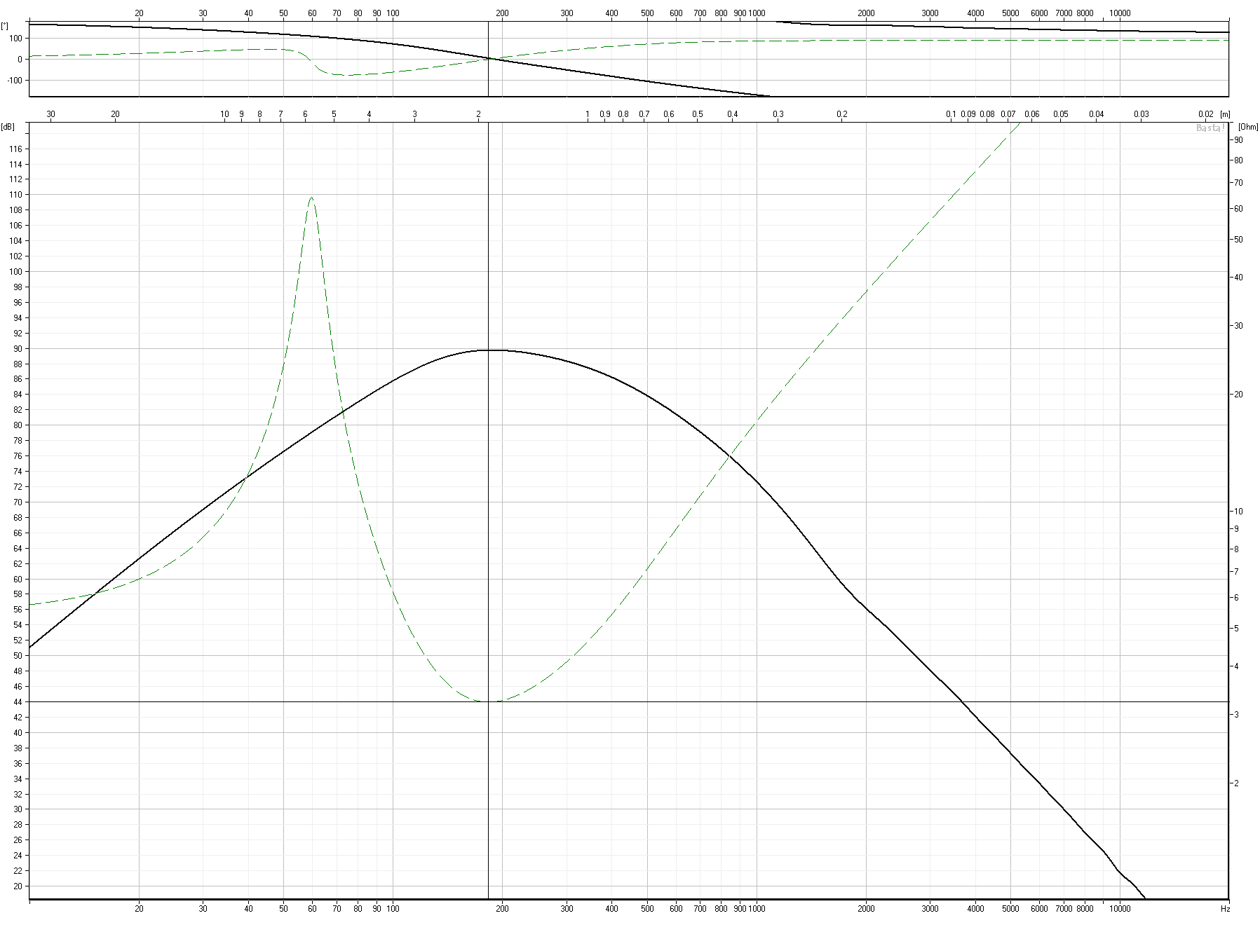

Im new to building speakers. I already read the "Handbuch der Lautsprechertechnik" and rn im on The "Loudspeaker Design Cookbook". I tried to get my info there but didnt find what i was looking for. So: I bought a driver B&C 8BG51. I want to use it in a closed Box (Frequencyband 100-500Hz) because i already built a Bassreflex Speaker for underneath.
Online the Frequency Graph on B&C site looks like this

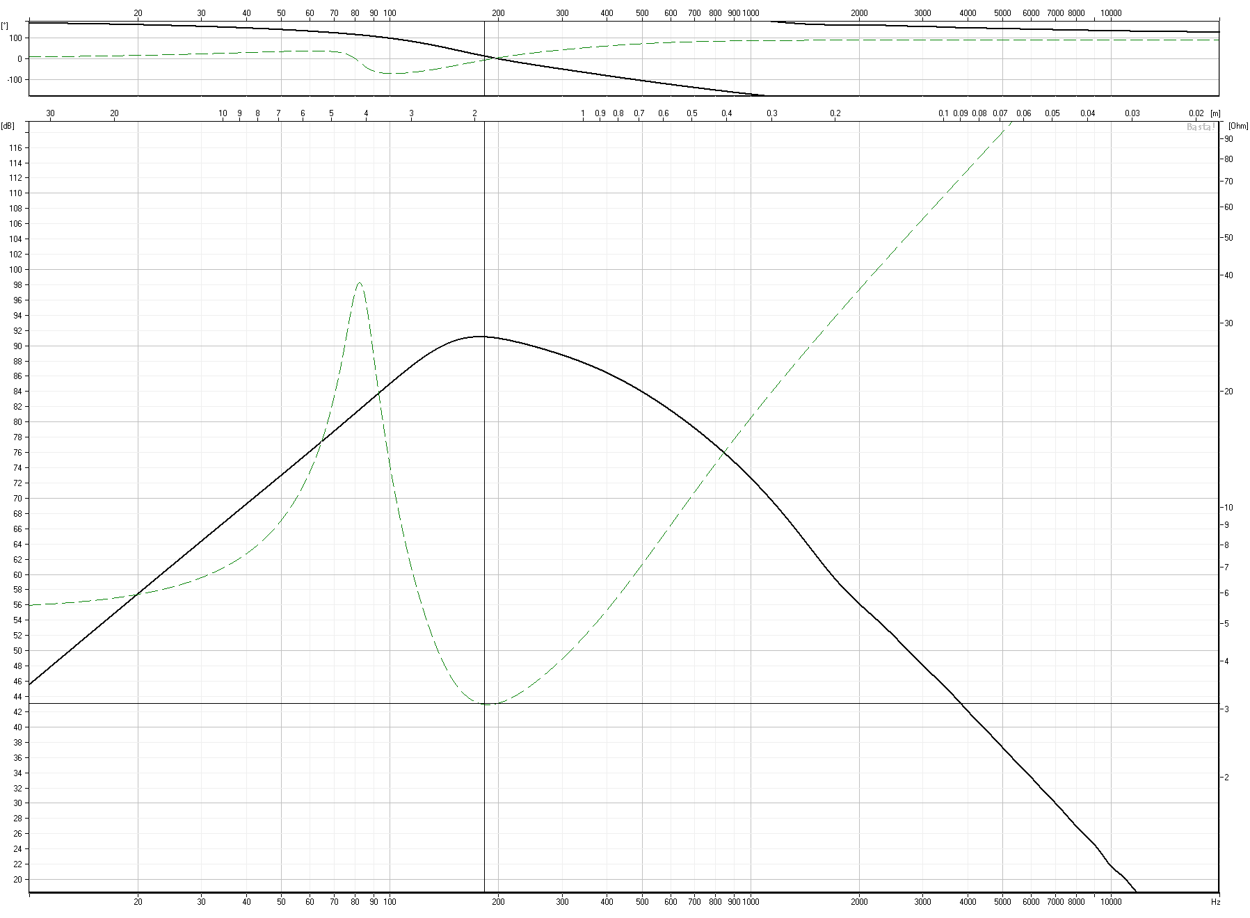

Now I calculated a box size for Qtc beeing 0.707 of 8.484l. If i now enter all the Data into AJHorn
i get this Graph:
which looks pretty underwhelming.

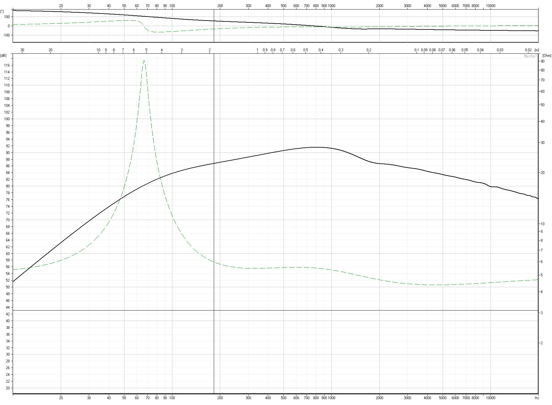

Now i found out, that the main Reason the Graph looks like this is that i Dialed in Rdc/Re of 5.1Ohm. If i was to dial in 8Ohm it would look like this:
which would be much closer to what i would have expected.
Can you guys tell me if i did a mistake in the Simulation or is that a common behaviour of Drivers under certain circumstances.

The value is correct. I notice AJHorn is taking other factors into consideration which may be appropriate but which could be obscuring what you're trying to see. Have you confirmed this by using a different box modeller? While there you could model damping material since this is going to be your safety net once the box is built.

You have to use the actual, measured R of the speaker. This is what you get with a multimeter in low Ohm position.
The graph of the speaker is measured in a very large box, typical around 3000 liter, which means free air.
When you put it into a smaller volume, the Fs rises, just like Qtb. The smaller the box, the higher the bump before the level drops off.
The nominal Ohm value of a speaker is just near the measured on. Like 6.6 Ohm DC will make an 8 Ohm speaker or 3.1 a 4 Ohm chassis. Never mix that up!

I just simulated your driver in a 8 liter closed enclosure. Got a nice response, straight and slowly dropping at 100Hz.
Just enter correct TSP and anything will be fine.

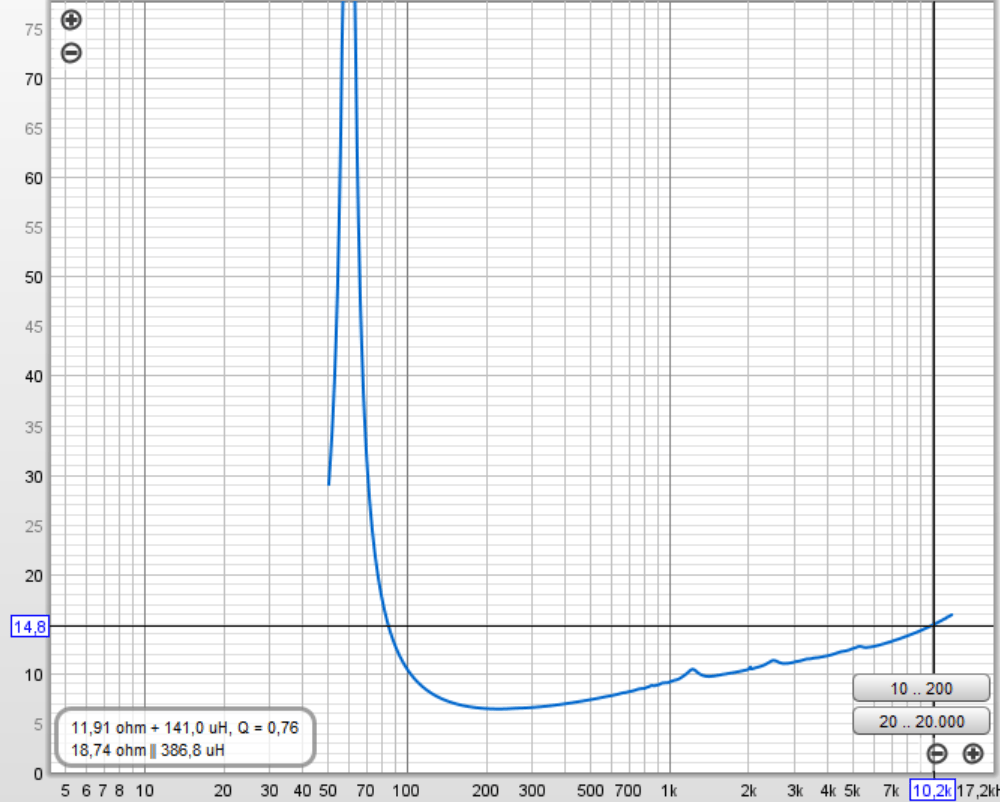

Hey Thank you very much for the loudspeakerdatabase! In AJ Horn they ask for Impedance at 1kHz and 10kHz. If i read it from the Datasheet provided by B&C it says 8.9Ohm at 1kHz and 14Ohm at 10kHz.I just simulated your driver in a 8 liter closed enclosure. Got a nice response, straight and slowly dropping at 100Hz.

At the loudspeakerdatabase it is 5.8 and 31.8 Ohm.
I dont know why they alter that strong or if i made a mistake but now that im using the new provided Data the Driver looks decent in the enclosure.
PS: In the same Turn it makes me wonder why this is not classyfied as a 6Ohm Speaker since in his operating range it is pretty close to 6Ohm
Ok, i measured the Driver in REW and thats the Impedance Graph:I just simulated your driver in a 8 liter closed enclosure. Got a nice response, straight and slowly dropping at 100Hz.

As you see, the Impedance Graph from loudspeakerdatabase seems wrong. And here i am again, wondering why the Frequenzyband looks so bad
I dont understand what you do. I can tell you that simulations in the programs that have been mentioned are spot on, if the TSP are right. B&C is no Chinese company and the TSP match reality. If you only want to prove anything and anyone wrong, first learn a little about this stuff. Otherwise, use the data, then buy a driver, measure it's TSP after preconditioning, then do your own simulation and build a cabinet. Calibrate your gear and measure the resulting response. You will find them to be as simulated. We have 2024, not 1980... some stuff has become pretty normal.

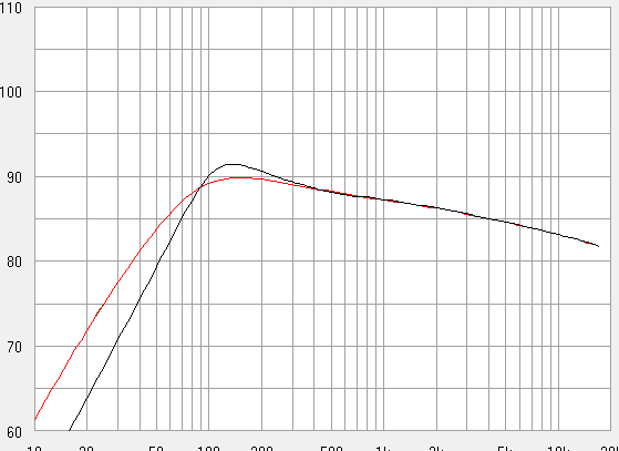

I'm not familiar with AJHorn, so I can't help with that. I use Tolvan Data's Basta for this type of modelling. It's pretty easy to learn.
Here's the response I get for your driver in an 18 litre sealed box with 300mm square baffle, no crossover.
It's as you'd expect, I think. Response rises because of the baffle step. Here's the response with a simple 2nd order electrical passive crossover, aiming at 500 Hz. You'll note that the impedance has dropped quite low.
