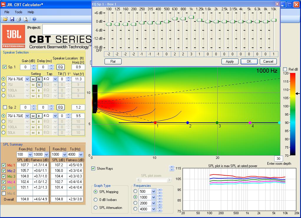

I'm going ahead with the purchase of a CBT70J and CBT70JE later today. I found some demo units, so the total price is about $1200, which seems like pretty good bang for the buck to me.
Again, thank-you to those who donated their expertise and opinions.

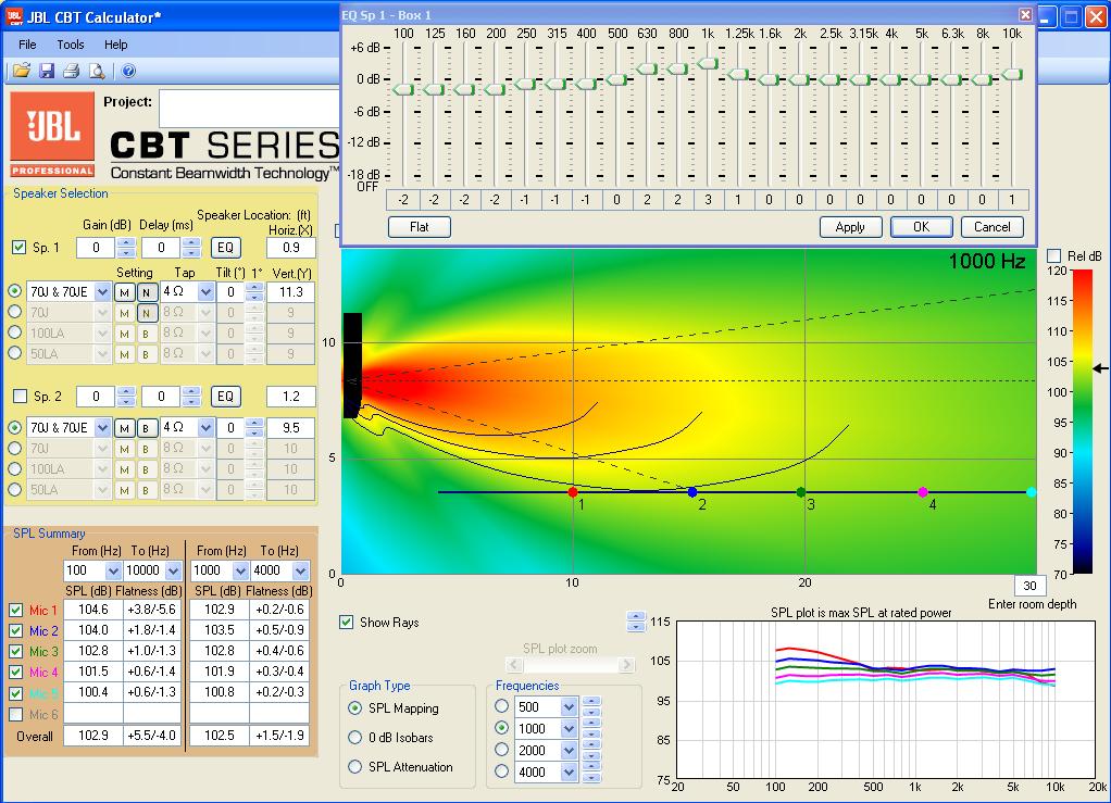

Getting back to the home audio side of things, I got curious how well a wall-mounted 70J would work in a large home listening room or home theater if its top was up against the ceiling. The CBT calculator doesn't simulate interaction with surfaces, but I figured a single 70J against the ceiling might behave somewhat like a free-space unit whose length is doubled with a 70JE extender, since the ceiling adds an image.
So here is an approximation of a wall-mounted 70J (set to narrow mode) whose top is against a 9ft. ceiling in a 30ft.-deep room. First at the seated position, and then standing. Pretty tight coverage when seated. 3-4dB spread beginning @~12ft. to the back of the room from 400Hz up. Not a bad seat in the house. When heard from a standing position, the spread opens up, and the array behaves more like a standard speaker.
Compared to the competition at the high-end home-theater level, it seems to me that the 70J might be a bargain, even at full retail price.

I'm not a line-array fanboy by any means, but I am intrigued by CBT's ability to create relatively constant SPL over a distance. I know that carefully aimed CD horns can do this--and maybe better?--but there seem to be some size and price tradeoffs.
..but I figured a single 70J against the ceiling might behave somewhat like a free-space unit whose length is doubled with a 70JE extender, since the ceiling adds an image.
That's what Don Keele says, anyway. The ceiling can work as the acoustic mirror just as the floor does.
Maybe I'm not sensitive to comb filtering (I don't notice it on multi-cell horns) but I didn't hear any on Don's prototype CBT array - either very close or very far away. They seemed very smooth and uniform.
