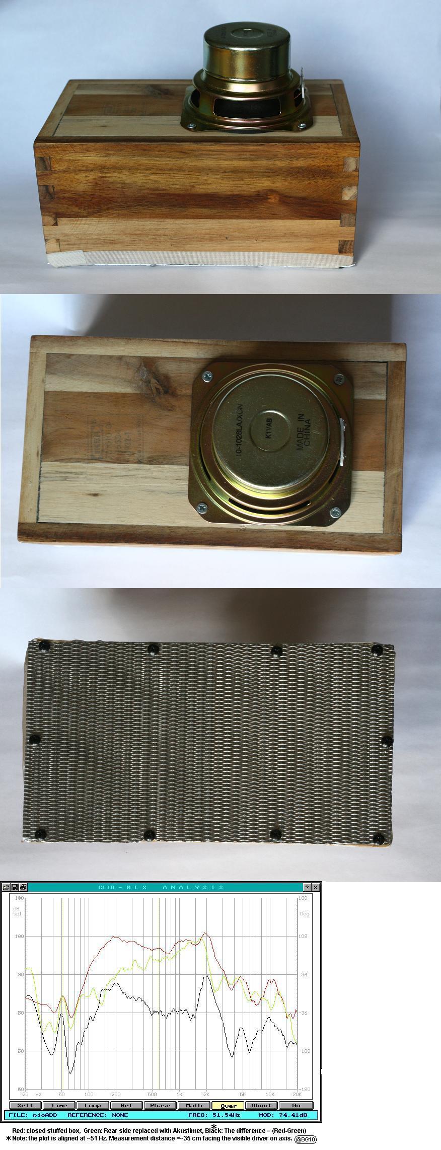

A little but prommising test :)
/Forsman

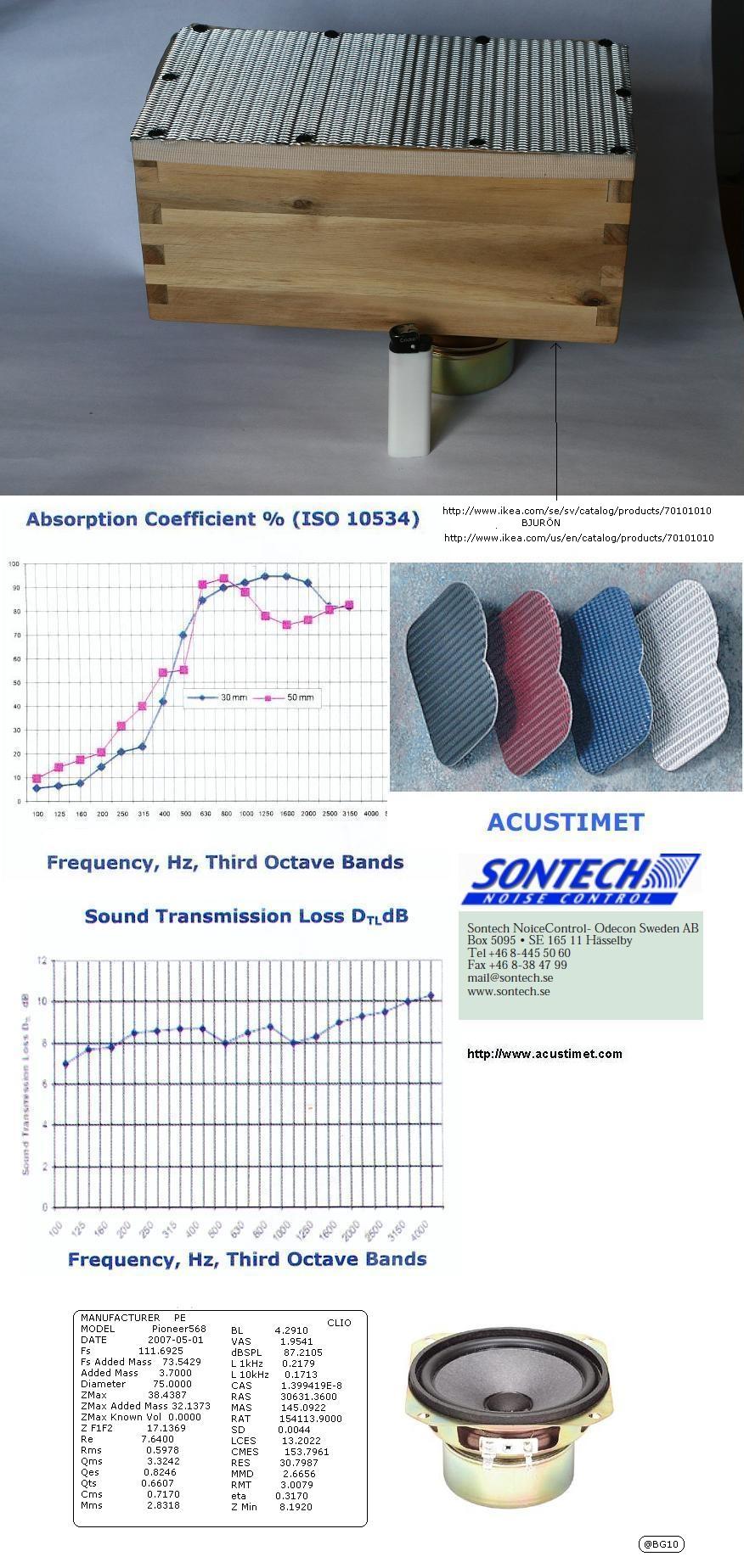

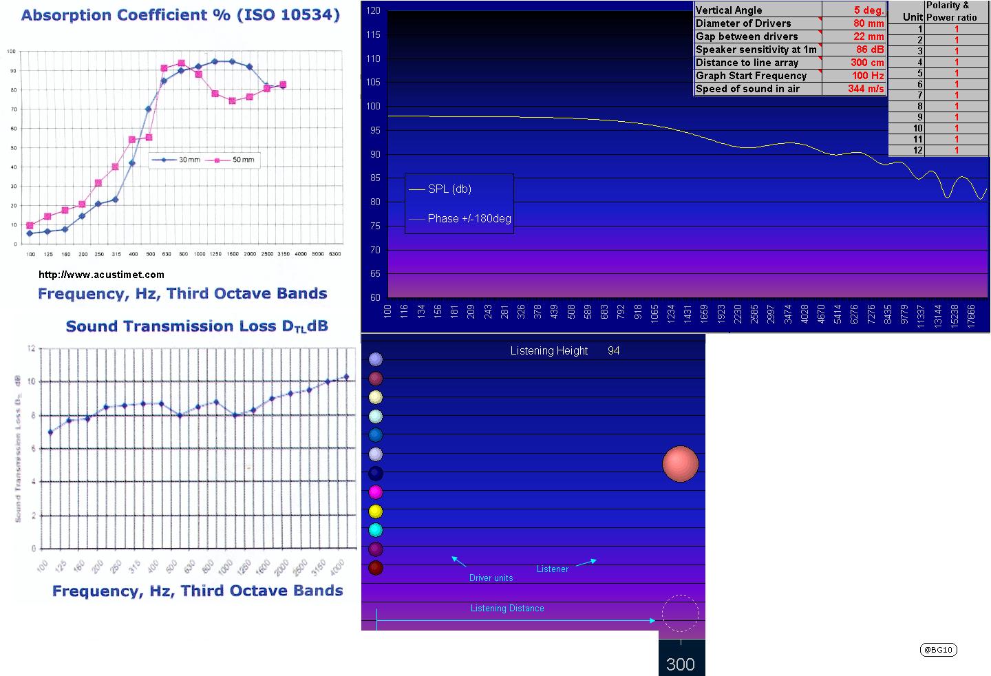

Ps: I have more than 500 of the 49 cent NSB:s, See the test results of an one driver experiment I made this summer for an semi open array to be placed near a wall:
I bought a case of those for a Boy Scout project, and one of the other Dad's and I measured them against some Audax 4 inch drivers (cost: $49 each) and the NSB's actually had a better Frequency Response!
They're not a bad driver at all dispite the cost, although the flange around the driver could be a bit wider. A donut shaped flange made out of 1/8 inch masonite can actually take care of that and you would end up with a great eco-driver.
