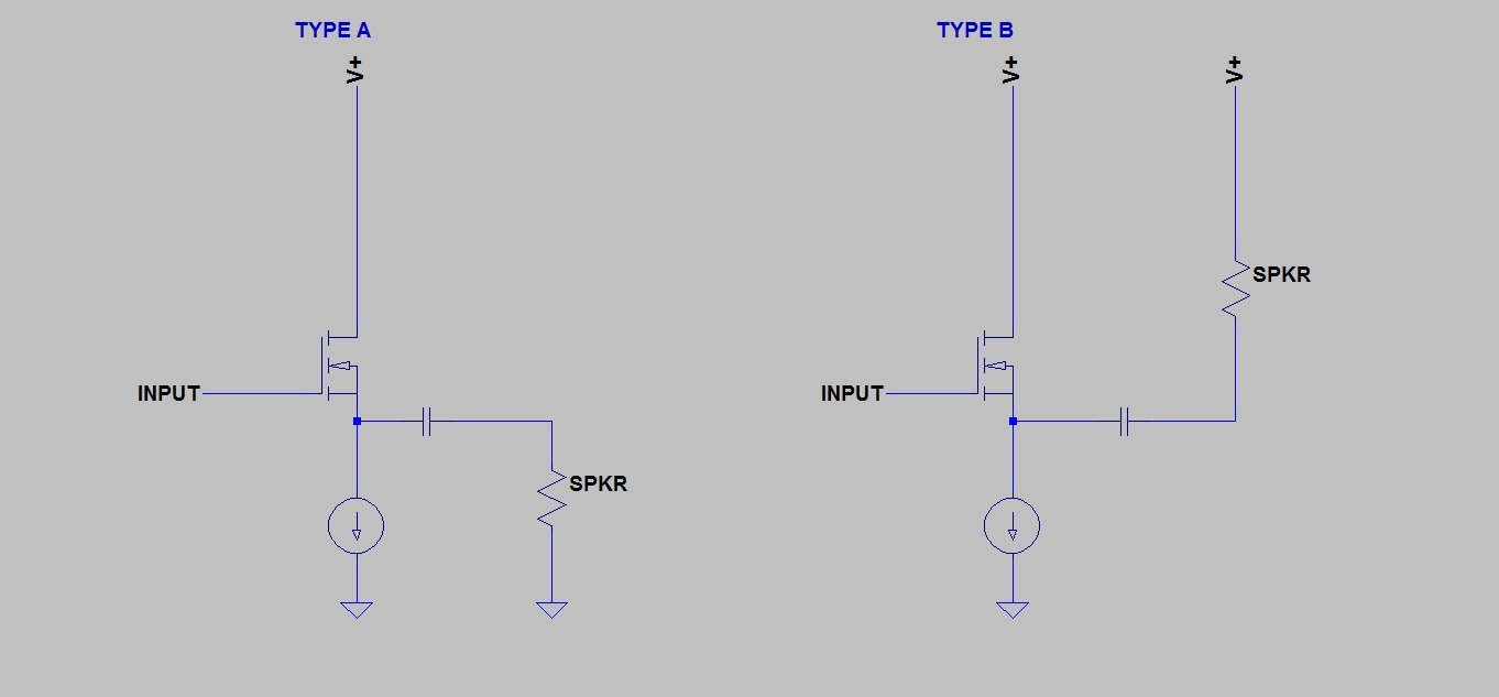

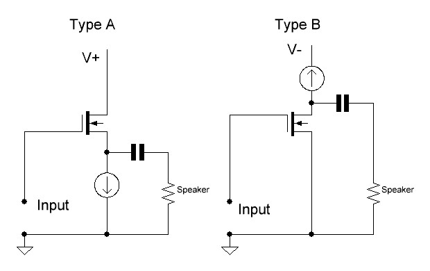

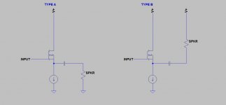

AC means currents and voltages that change direction and polarity, respectively, over time. Any point in a circuit that does not change potential, like the power supply rails, is an AC ground.
Electrons don`t care about pompous concepts and don`t read schematics, they only will return to their source.
