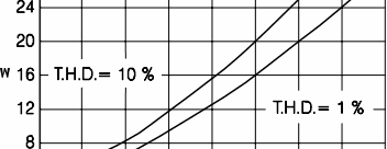

20W@10%THD (16W@1%THD) to 8 ohms monobloc Parallel amplifier
Hey, solid state gurus! The contest parameters are posted in the chip amp forum where it is popular to use 10% distortion figures when expressing output power of lower voltage chips. So after a few hours and much help (thanks!), I've listed the same power specs, described more appropriately at post 1. And, there is the option of building a more interesting, higher powered, higher quality monobloc with parallel chip or parallel output devices. See also the following extract from the TDA7265 datasheet.

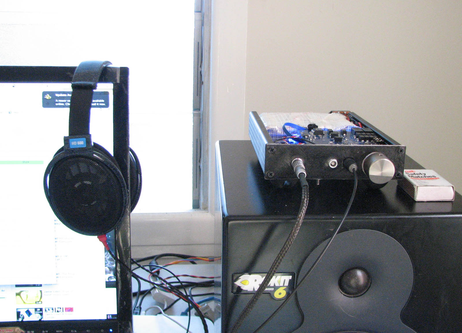

that battery powers a portable Balanced ES9018 dac, balanced headphone amp with ~2.5Wpc @ -110dB THD+N for ~8hrs and the whole thing including batteries, >10 linear regulators, transformer coupled electrical spdif (mini BNC), toslink spdif, battery monitor and digital volume control fits in a case 25 x 120 x 160mm, while weighing significantly less than 1lb.
overkill? yeah but not in the way you thought. its overkill in the manner that I built a very high quality home dac and headphone setup into a portable unit. (pics linked below)
