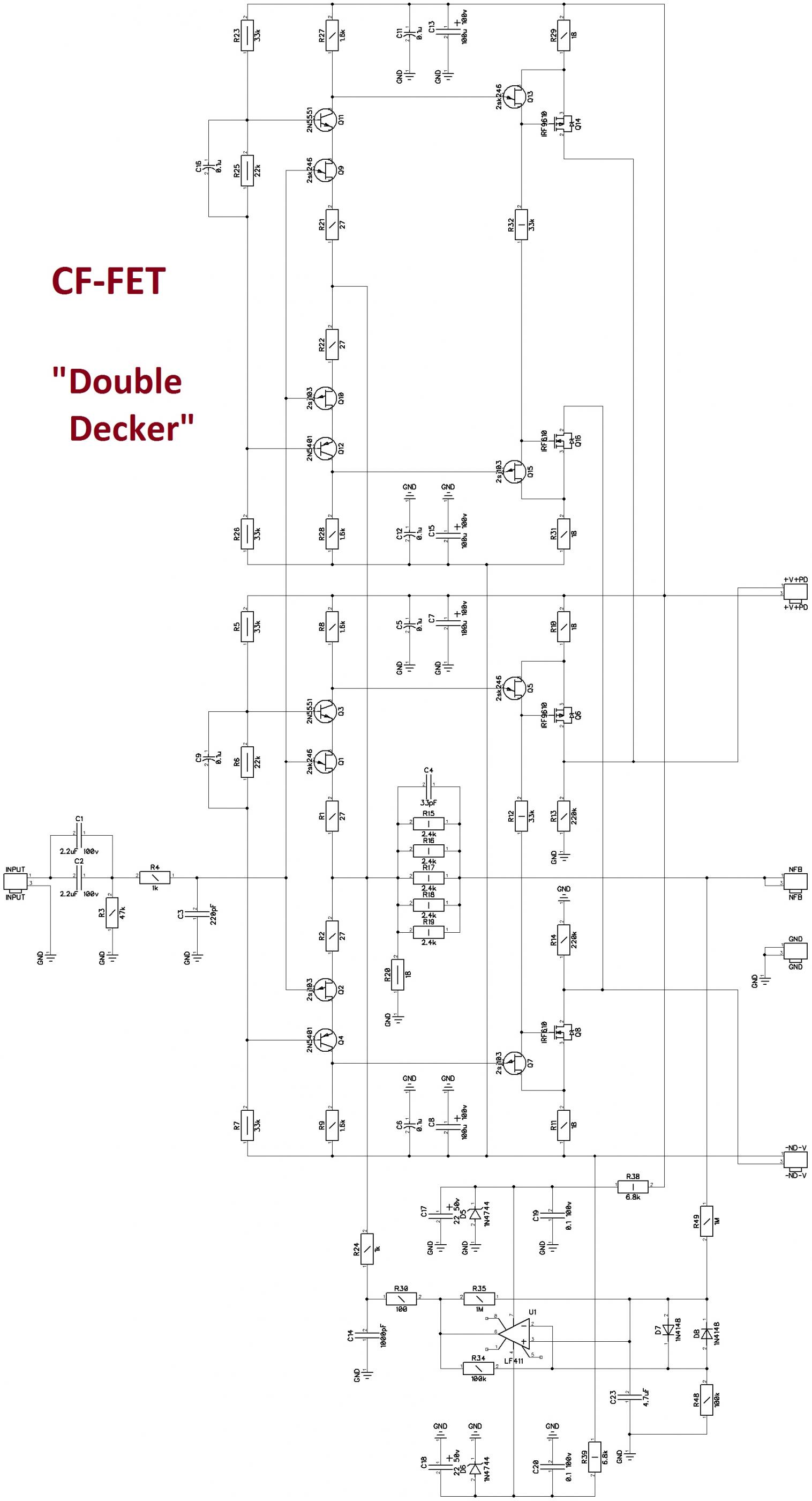

And now to think about to put it on double sided all SMD PCB. Try to find better VAS SMD mosfets which will be cooled down on PCB copper polygon, etc. for some more up-to date solutions.Double Decker schematic "as built".

Testing my CFA-CFP boards today and I have some issues. Did either of you do a schematic with voltages or an asc. file? I'm going over my parts again one by one to make sure they are correct but it would also be useful if I had at least a few places I could measure to help locate my error.

Hi Guys,
False alarm. I used TL072 instead of TL071. All is well in the universe. I will give it an audio test in the morning.
Blessings, Terry
Edit:
I have about .5V offset on initial turn-on which settles to 0V once the servo gets through. Is this normal?
Hi Terry - ok, cool. 0.5V before the servo jumps-in is OK for this kind of heavily-symmetric CFA topology. Different tolerances lead to certain disbalance (you never know in what direction) - that's why the servo is very recommended here. It's possible to balance-out the offset with a trimmer, instead of using a servo, but over the time it may certainly drift. With the servo you can just forget about it.
One precaution - it is not recommended to connect/disconnect the input cables with the power on. Such a high-speed, wide-bandwidth amp can have pretty evil harmonics-rich transition noises at the output. Potentially not good for the speakers, in some cases leading to ptotection trip-out.

Hi Terry,
Optimal quiescent current for this amp is around 35mA per pair - this is a specialty of CFP output stage topology. It runs pretty cool.
Valery

Terry, you're right - it's 15.4mV over a pair of 0R22 resistors.
BIAS plug is there for connecting an over-current sensor of the control board, but you can measure the above voltage drop right there.
The amp provides the "standard" 29db voltage gain with R9 = 18R.
Actual THD is very low. I will try to play with your model to see what's wrong with it.
Valery
