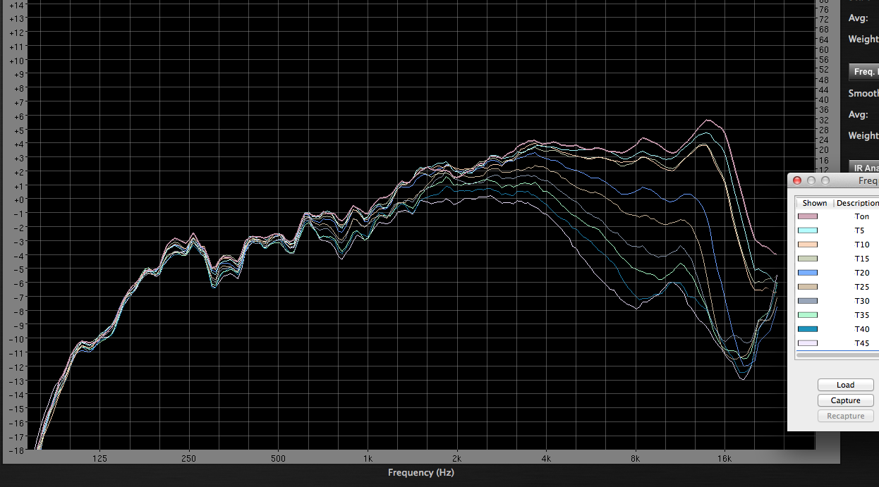

The TC9 also upper frequency range directivity is so narrow that it is not hitting your side walls- little "spaciousness" above 5kHz.A lot of emphasis is on horizontal directivity, which in my opinion is misplaced. Our two-ears and brain are very good at separating sound sources in the horizontal axis. Toole has shown that in fact side reflections add a sense of spaciousness. On the other hand, our ears and brain cannot separate out floor bounce and ceiling bounce. It changes the perceived frequency response and also localizes the speaker reducing the depth illusion.
Think about the issues carefully. There are many positives to line arrays. Toole pretty much says that this is the ideal speaker for home sound reproduction. Regarding the comb filtering. It is pretty high up in frequency and if you sit far enough from the array, is a non-audible issue.
The TC9 has only 30 degree dispersion (-6dB) at 16 kHz, it's -17 dB at 45 degrees off axis.
The narrowing dispersion results in less HF boost required for flat on axis response, and makes your baffle/90 degree corner waveguide diffraction "issue" not a concern.
The polars below were with the TC9 driver mounted in a 1 liter bottle, basically no baffle other than the speaker mounting flange.
Unfortunately, just noticed that I repeated the 10 degree test, so my statement above is based on the 15 degree off axis result being between the 10 and 20 degree graphs

Let's try a visual presentation of that.
Here's a wavelet at the listening position of the combined left and right array down to -15 dB in my room:
Evidently I still have some early reflections, the most severe at ~7 ms (I.m.h.o. from my back wall behind the listening position). This result is due to a combination of damping panels at (obvious) first reflection points and DRC processing.
When looking at -10 dB down on the same plot everything is a lot more clear:
![spec15.jpg](https://www.rsr-concepts.com/diyma/spec15.jpg)
![spec.jpg](https://www.rsr-concepts.com/diyma/spec.jpg)
