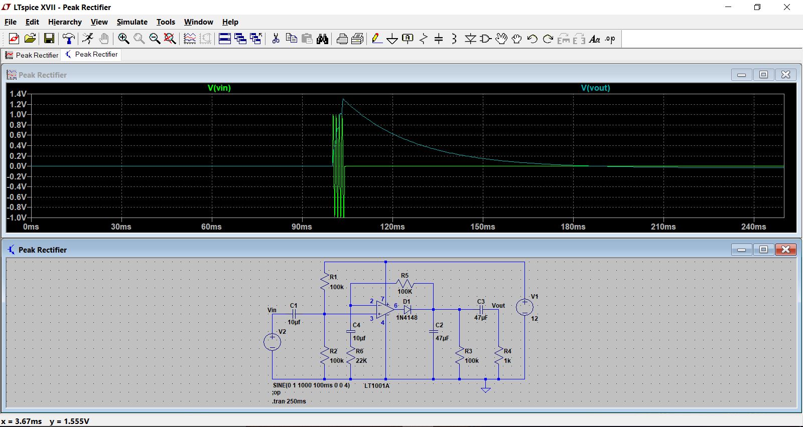

This topic crops up quite often on here and this was a simple circuit I threw together to take a short duration AC signal (such as a transient in music) and produce a DC voltage that can be used to drive a meter. You can set the decay time by fiddling with the cap values to suit the meter and the visual effect you desire.
Having the diode within the feedback loop eliminates the forward volt drop of the device, the bane of passive networks.
Its all textbook stuff, nothing original 🙂
Essentially yes although if you examine a music waveform you will see the average is zero, in other words there are similar positive and negative going peaks.
The addition of a another opamp as a buffer at the output, and changing the input opamp to inverting configuration would create a full wave version, and still only using one diode.

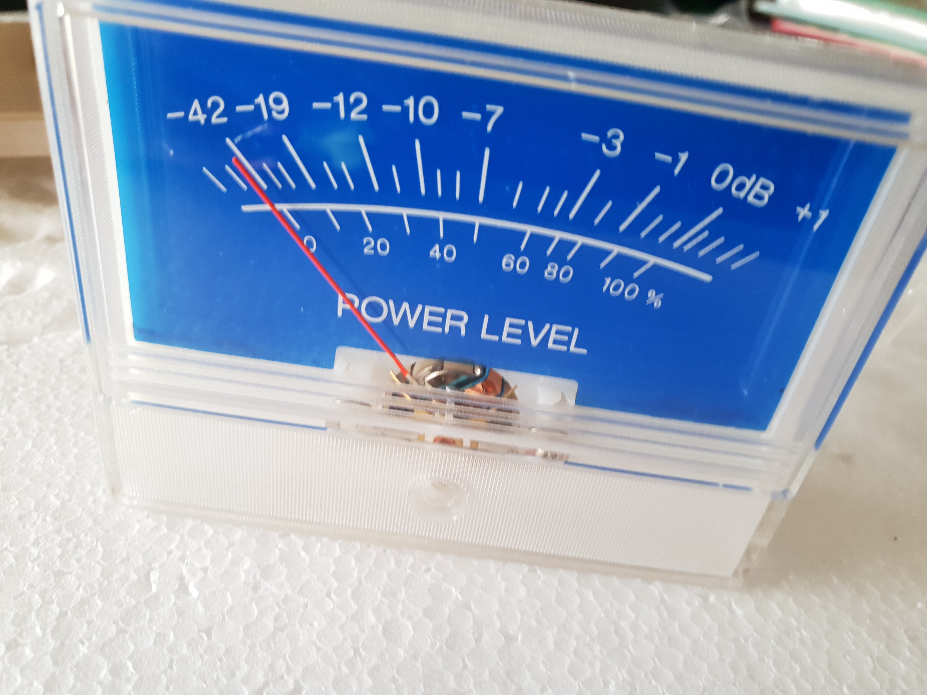

SURPRISE! It does. It is a model NISSEI TN-73 ROSH Panel VU Meter 0.8VAC. Actually designed to be used with a resistor of 3,600 ohms to give a "0" reading at 1.228 Volts RMS AC.
Second SURPRISE! It uses a full wave bridge. A drum hit is an example of a not very symmetric waveform. The average may go to zero but absolute phase really does exist.
Interesting. So it would/should make a good candidate to wrap an opamp around to overcome the diode drops. Good stuff
Good find! Nice that it has built in rectification. Put a 3K6 in front of it and connect it to the CD player outputs. Should be some action there.
The listing even says "no rectifier needed". (But then says something about 5U4??)

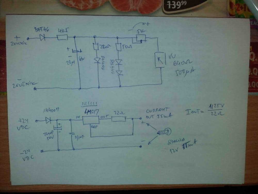

I hope they will work, I did not find the data for your instruments (resistance and current for full scale) .
Replace BAT43 with BAT46 schottky diode if you have more than 40W/8ohms amplifier.

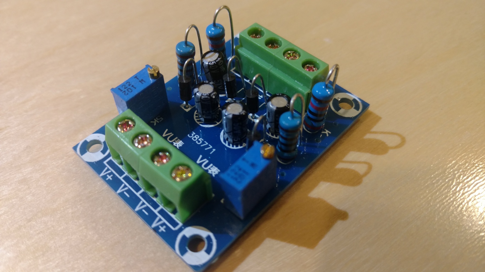

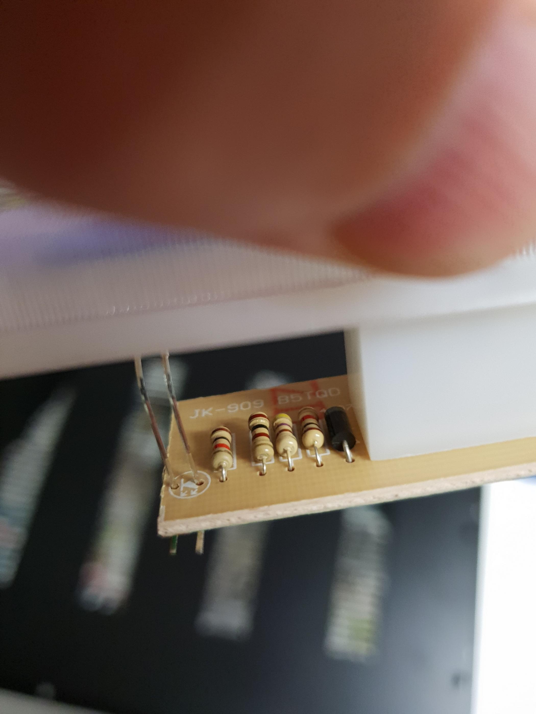

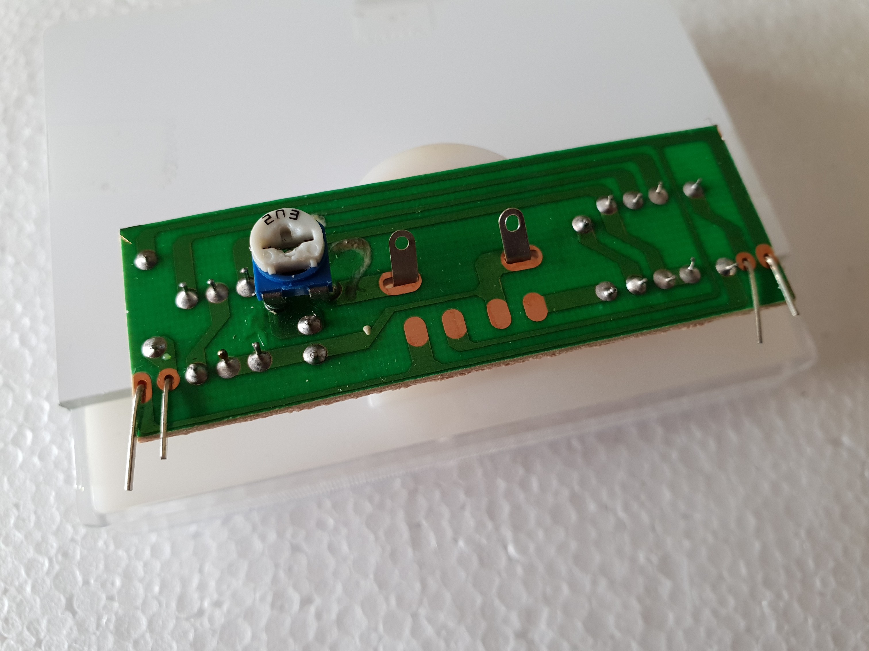

received my board
It looks very different than what is on the AliExpress page. I wonder what the schematic is for this PCB. It seems to have more diodes.. maybe an improved version?
I will try to trace the board to get the schematic
Similar type of circuit but now using surface mount parts. Perhaps the extra pair of diodes are reverse biased across the meter for protection (or to absorb eddy currents).
Have you discovered the schematic of this new PCB?
