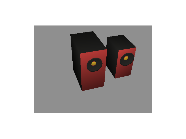

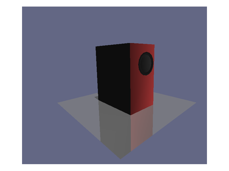

Computer Assisted Design completed
Preliminary design completed: 30 cm by 20 cm approx, and about 35 cm high. Finishing is important: I don't want it to look like a cardboard box, should look more like these:
Bifrost
(Results of a search)
Screen shots from Wings3d and G3D Viewer (with reflection).

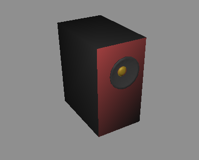

Design Changes
Some design changes were made after cutting out some of the cardboard. By the way the stuff is quite strong, la belled as DOUBLEWALL by Viking Industries, NJ.
Existing bookshelf speakers vary in width from 13 cm to 20 cm, and are 24 cm to 30 cm high for the most part. Depth is between 24 and 40 cm, as long as it is not equal to the other sides, should be OK.
Depth is an important factor I previously overlooked: hold any speaker driver ( without the enclosure) against a wall, pointing outwards of course, and it does not sound as good as when it is some distance away from the wall.
Design changes shown: now the dimensions are 14W X 23-26H X 24D. Newer design is on the right.

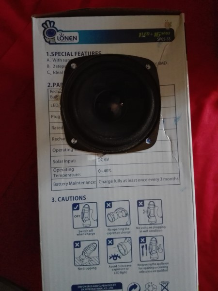

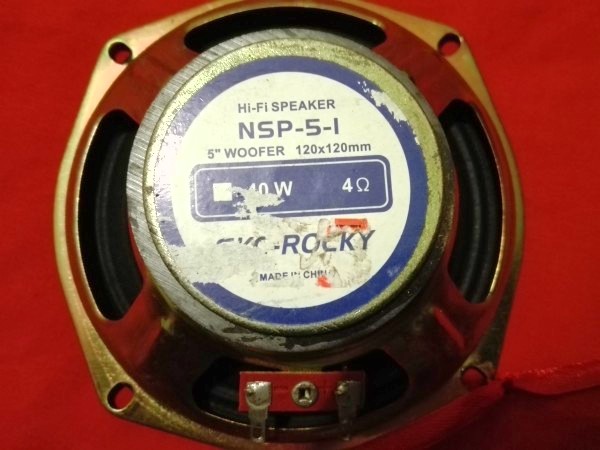

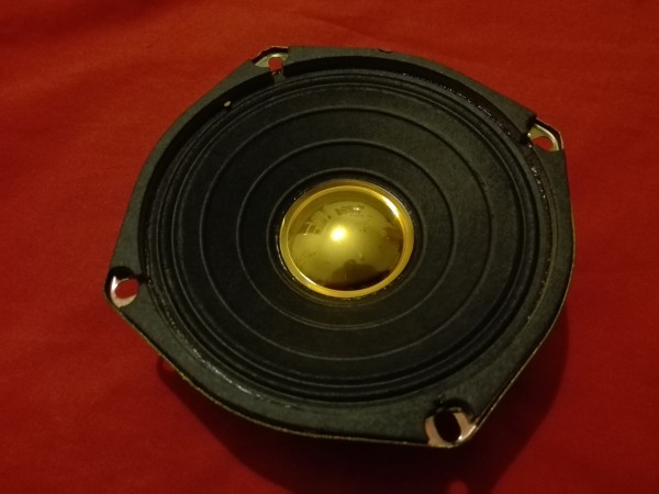

Sounds Terrible
Terrible. I installed the speaker in the box alright, but the problem is the speaker, it gives out a distorted sound, no matter where it is placed. The smaller full range I have sounds better, by itself, in open baffle mode, so that pretty much settles it.
Its a woofer (duh)
Apparently its a woofer (says so on the label) and I need a coil to keep out those bad mid to high frequencies, and that means a tweeter is needed as well. More complexities.
The lesson is:
Choose your drivers carefully and listen before you buy, or buy a reputable brand and check its reviews online. Or go for a full range.
Its a woofer (duh)
The lesson is:

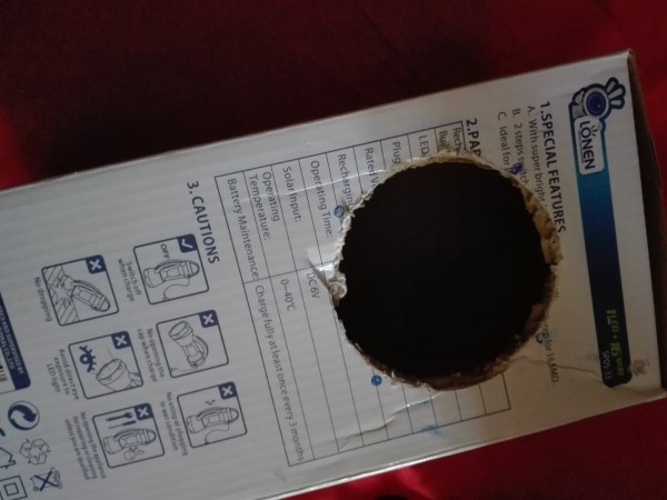

I place my PC speaker driver - by the way it is a HYH unit, very similar to what is tested here:
YouTube
In the cardboard box in which I cut out a round hole, by hand, using a router.
It sounds good, press on the top and bottom of the box to fully seal it and the bass increases a bit more, press on the sides and that increase the bass some more. I could try some bracing to make it stiffer in the sides.
Next: secure the speakers, seal the enclosure and paint it to look like wood. Or granite. I also plan to add a cloth grille. It should look presentable, and I already know the sound is good - when you listen to a speaker and think "I could listen to this forever" you have a winner.

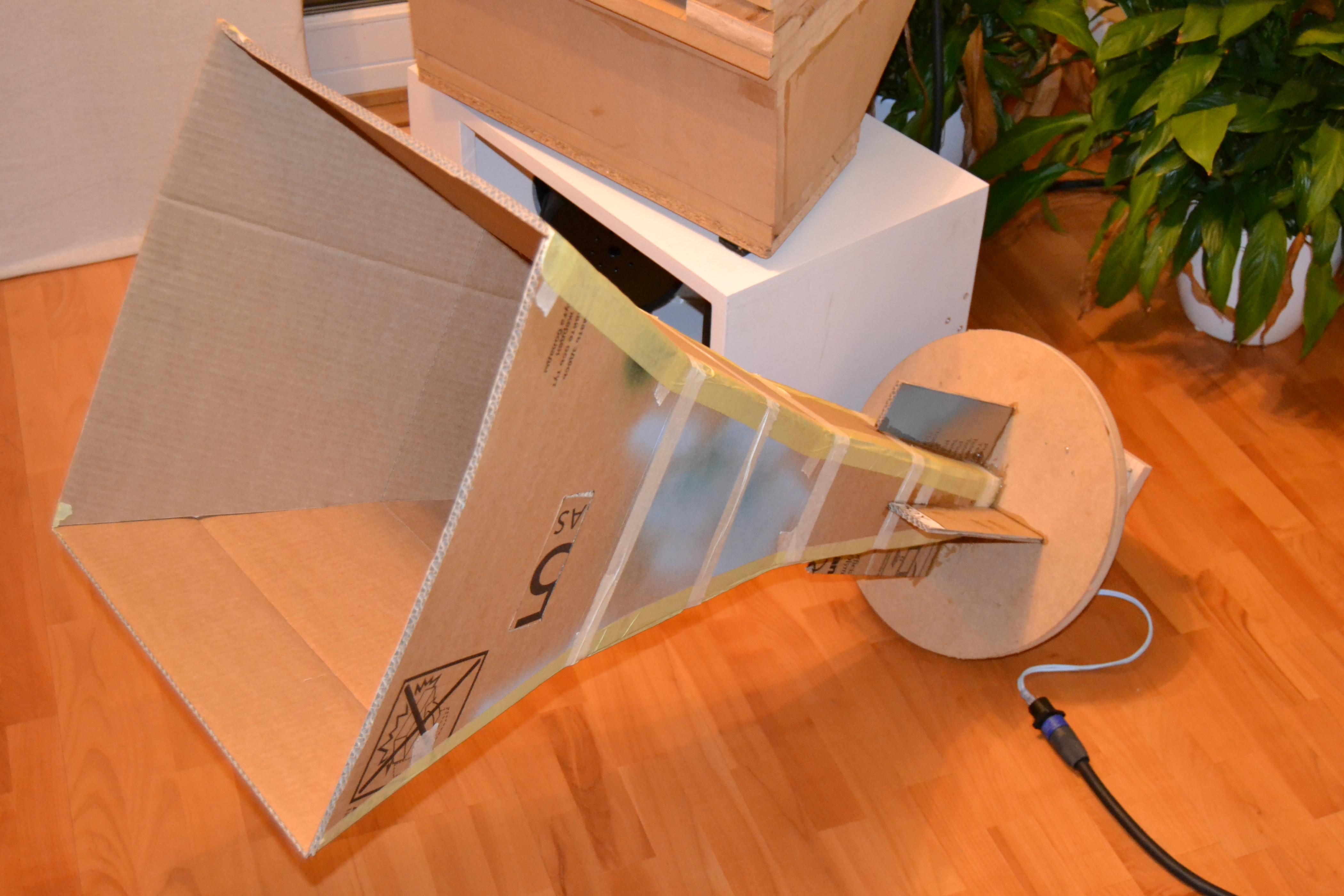

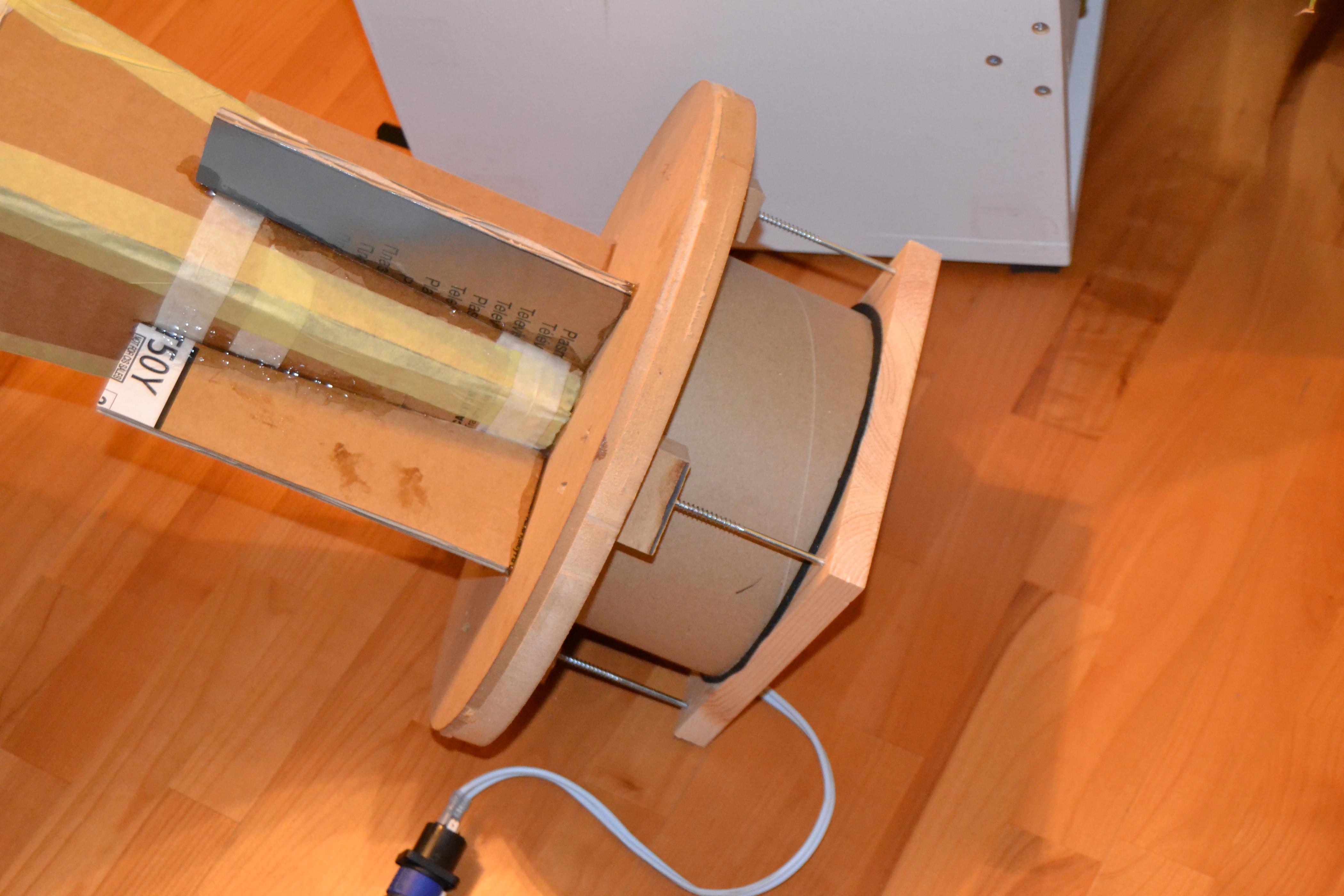

I used an old plasmascreen box to make midbasshorns.
There is some vibration when playing, and resonans around 2-300 Hz which I hope I might get rid of with some bracing, but for now I am enjoying them from 150Hz to 600Hz.
I made them similar in profile to John Inslows 135Hz horn, but I am using the JA-8008 as my driver, not the b&c unit.
The rear chamber is a sonotube that fits against the flange of the driver, giving me a minimal chamber.
I taped it together first but the edges were rubbing against eachother making a buzzing sound, that was solved with silicone.
All braces and the connection to the baffle are glued with epoxy, the throat is very stiff.
