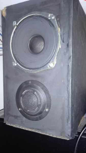

I have added a tweeter to the speaker in place of the port. So it is now a two -way system. The tweeter sizzles a little, and the bass line is barely visible, but the clarity and presence of the thing. I don't want to mess with it further but will have to reduce the power to the tweeter and also add a inductor to the woofer, somewhere in the range of 0.20 mH as I remember.

Image. Finishing is not the best, and tweeters are at ear level, hence the inverted appearance.
