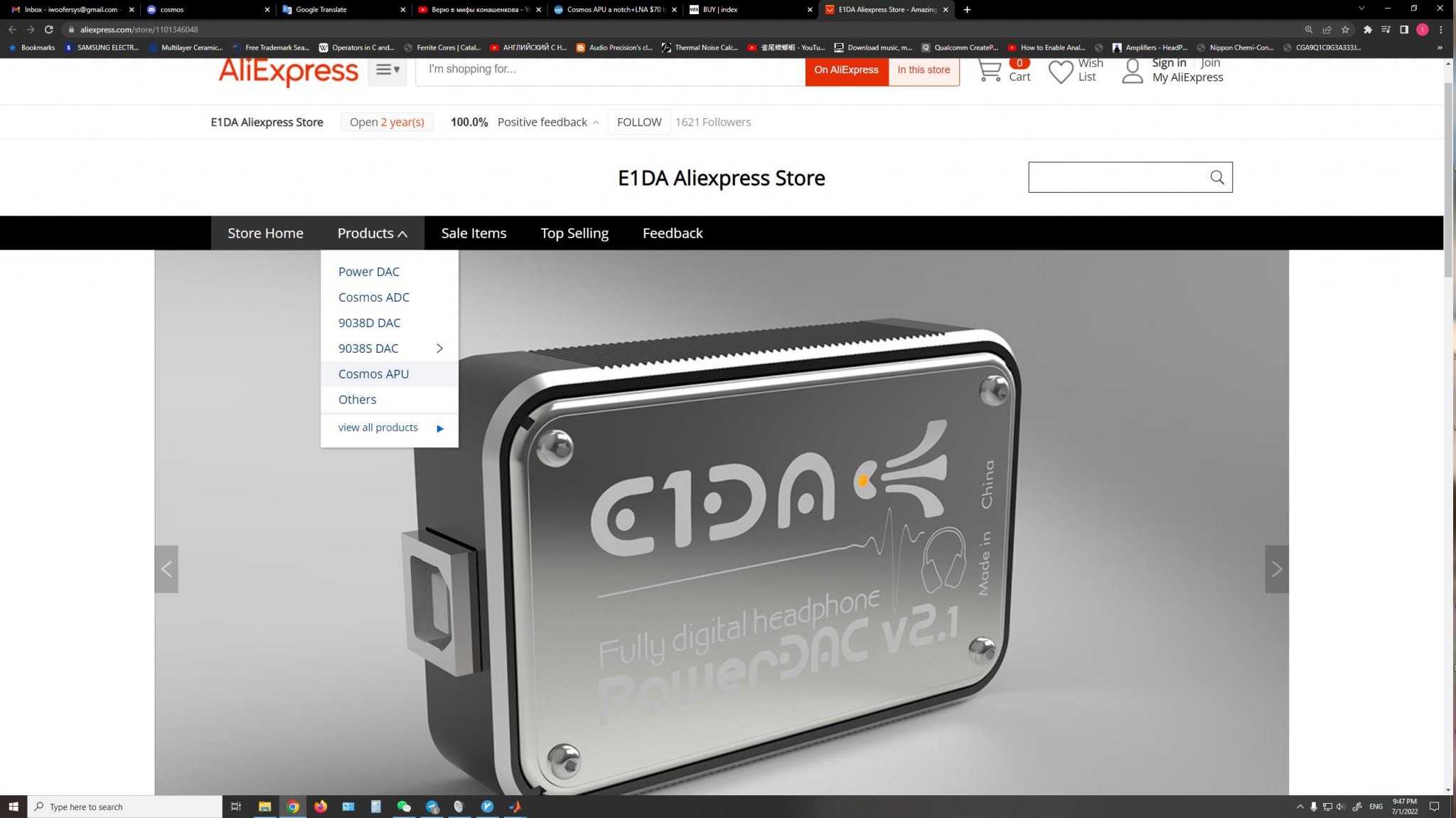

Ivan, your Aliexpress store seems to be having problems.
I cannot find it or any of its products by searching within the store. I can access it through a google search or from your homepage. However, when I click on a product, I keep getting "Sorry, no matches were found for your refined search." This happens in Chrome and Edge.

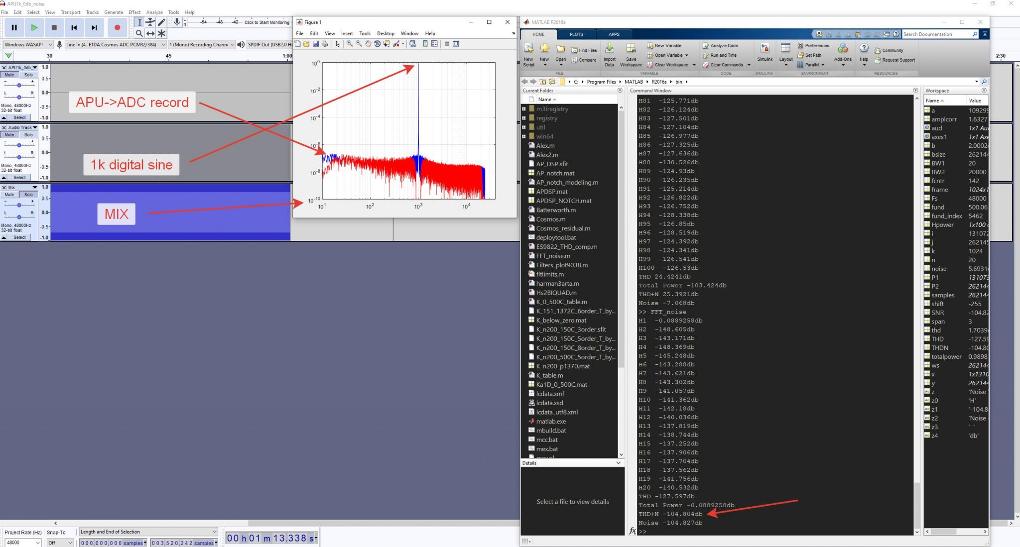

The practically achieved number is -132db, I've no sine source better yet. I just finished the Matlab simulation of the THD+N with an ideal 1kHz sine + real APU noise with exactly the same notch+20-20kBW as AP2700 SW does. As you can see, a noise-limited THD+N value is -134.8db@1kHz@10Vrms(APU Notch gain 0db) i.e. about 10db better than APx555b. I have to mention that my ADC sensitivity was 2.7V which corresponds to about 8.8Vrms APU input at 1kHz(+20db gain -30db notching = 10db or 3.16x times), hence, 10Vrms input has about 1db room. The correction should subtract .5 to 1db from the THD+N simulation above i.e. the limit is around -135.5db.

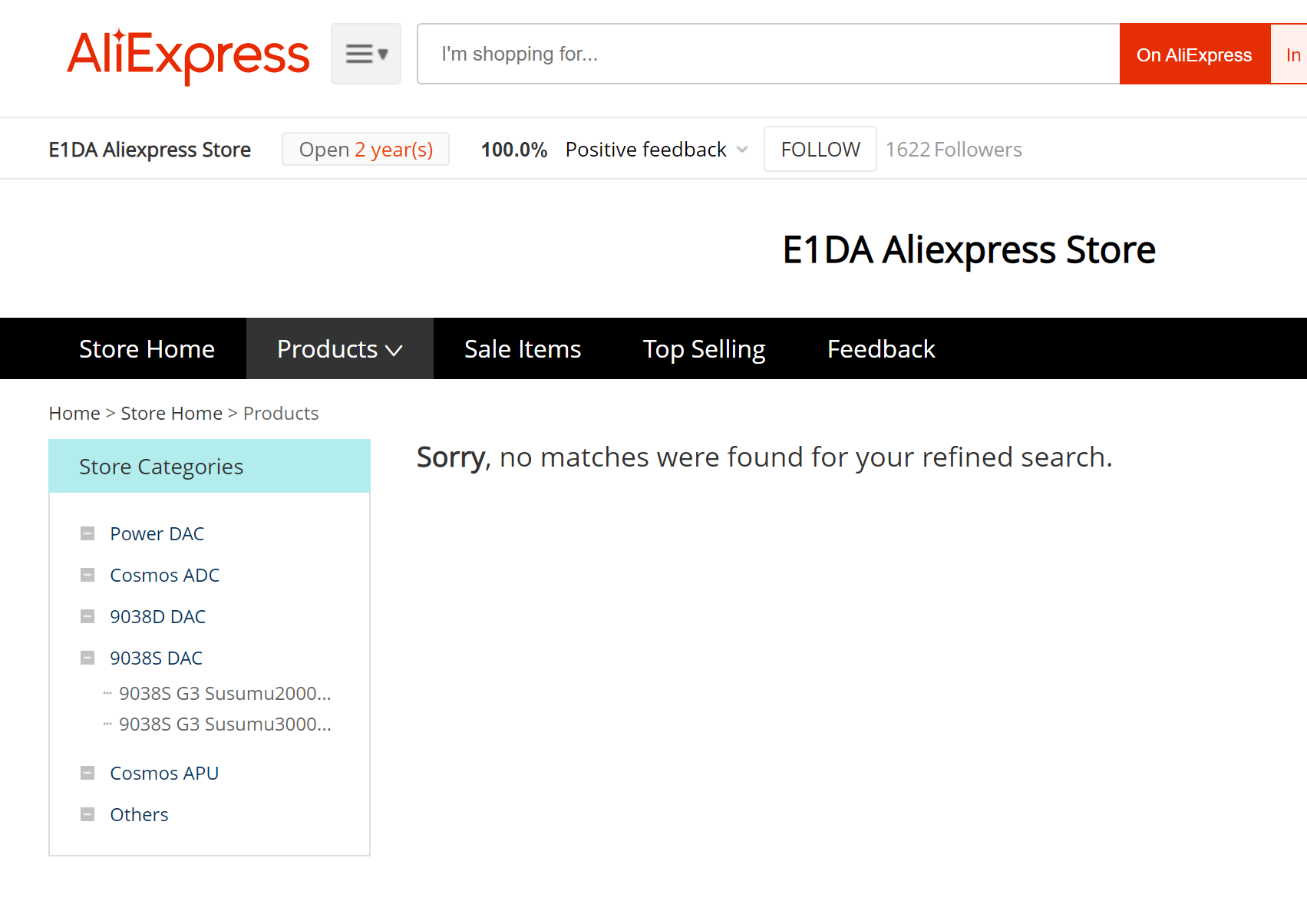

Yes, I can see the same page but when I want to look at any of the products listed, I get what I have attached:I can see that with USA VPN.
From the US "via Comcast" I have been able to navigate the Aliexpress stee and see the items. However there are several "stores" selling the E1DA stuff. DD-audio, Transformer and amplifier etc. Are they selling real product? With markups? I believe this is the correct store: https://www.aliexpress.com/store/1101346048?spm=a2g0o.detail.1000007.1.39ba1278GI1rXG

I have ordered through your Aliexpress shop several times before, and it was always the problem that when I used the search field of Aliexpress to search e.g. for 9038D, I wouldn't get your shop or individual products, only those from resellers, so I turned to using google or the link on your website.
Using google or your website, I now get to your shop, I get to your shop, see the pictures, but when I click on a product, it get the image above.
There seems to be something similar but slightly different (different message displayed) going on randomly for many other listings. We mused it might be due to an unresolved electric safety EU regulation but it pertains to totally passive parts like aluminum feet to mount a case on, too.
