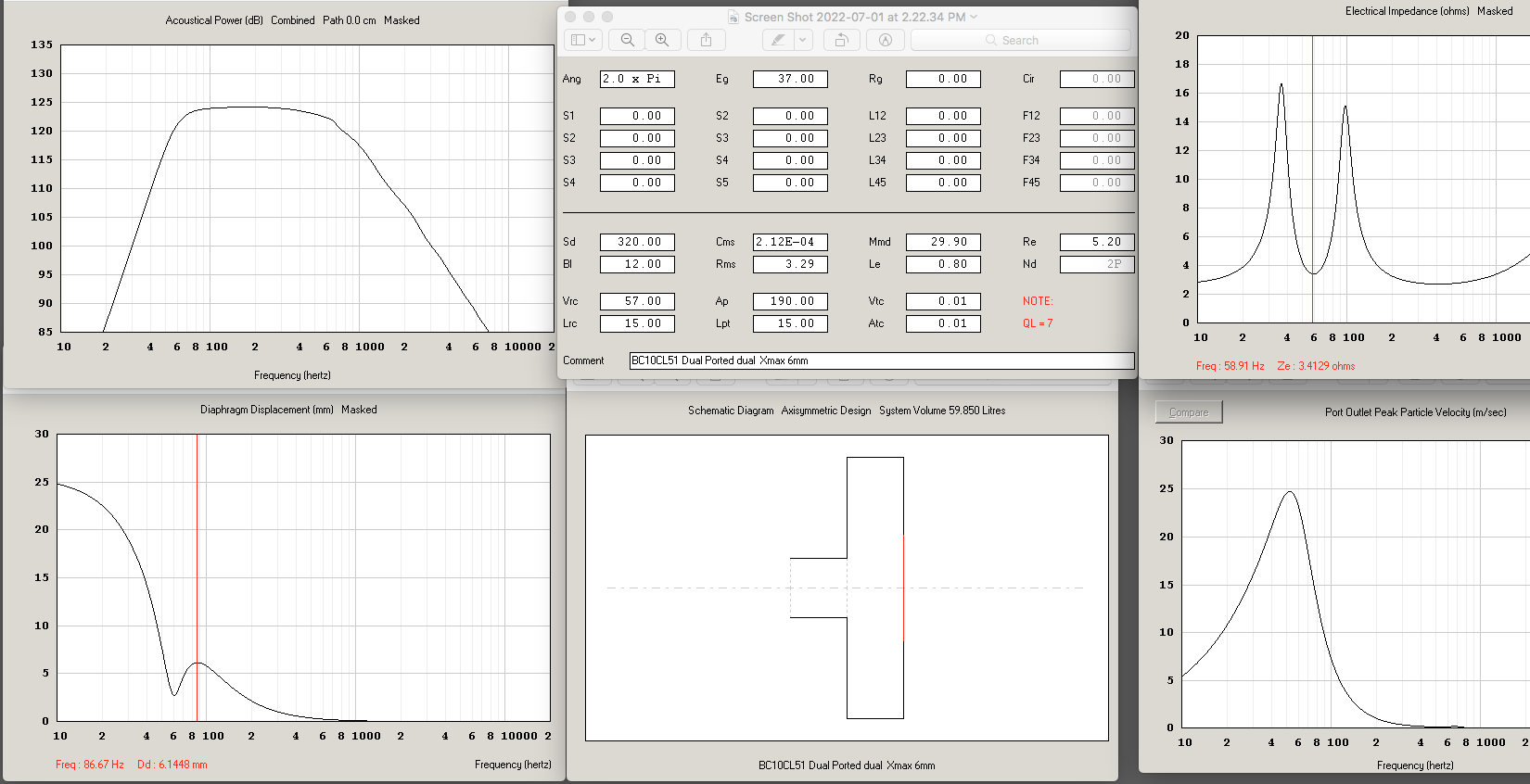

Using four B&C10CL51, a pair in each 60 liter box (Fb 60Hz), you could expect close to 130 dB at one meter down to 60Hz.Basically I'm attempting a crude, light, outdoor PA speaker, with some warm low end.
Using softwood 1/2" plywood, each box could weigh under 20 lbs with the 2.6 pound woofers, 35 pounds for the pair total would be possible, even including some bracing.
That said, the chip amp you have been using can't swing 37 volts output, so won't reach that level.
