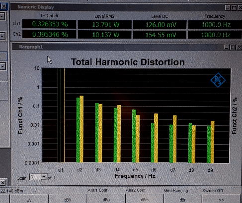

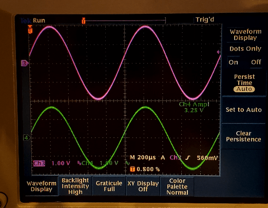

Well I put in a pair of SJ56 parts on the other channel. Couldn't get proper bias on that channel. Turned out all of the four NEW zeners were shorted again. Replaced, got both channels working. Now they are doing okay, about 0.3% THD. Clipping is about 83W into 8 ohm load.

Oh, it's going to get a good workout before I ship it back to the customer, for sure!
It's interesting how the left channel's distortion came down when I installed the parts for the right channel and got it up and running. Must have been reading garbage harmonics polluting the common bus.
