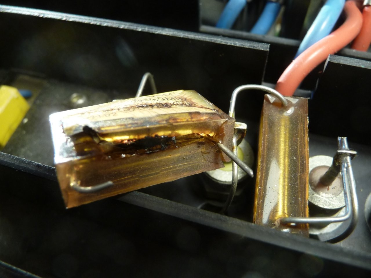

Cracked/exploded Evox Rifa Metallized Paper X2 Capacitors - What Deficiencies?

Why do these versions in particular fail so often (unfortunately often associated with very penetrating odors and very time-consuming cleaning of the environment - today happens on Linn's Brilliant SMPS) ?

Replacing all Rifa PME271M capacitors is at the top my to-do list when refurbishing a vintage device. The failure mechanism has been described extensively on many places. The (epoxy?) case will degrade and crack, letting moisture inside. Thermal runaway will then cause the explosion as soon as the device will warm up. yet another instance of manufacturers selecting the wrong matherial because they failed to test aging.
The (epoxy?) case will degrade and crack, letting moisture inside. Thermal runaway will then cause the explosion as soon as the device will warm up. yet another instance of manufacturers selecting the wrong material because they failed to test aging.

They have a timed life and will even crack if left in a drawer without ever having had power applied to them.
Replace them if they are more than 10 years old.
If they do not have an obvious date of manufacture on them a bin is a the right place for them to go.

To my knowledge, a formal failure analysis backed by real data has never been published because it would obviously be a lawsuit magnet. Rifa PME271M capacitors were also installed on older Shaffner EMC filters, they are notorious for this issue. As you already noticed, a quick internet search does list several forum threads and blogs. Deep inside a few of them, such as Let's Talk About Capacitor Failure - Byte Cellar , you will find some good insights about the vintage Rifa X2 capacitors. They are usually presented under the "anecdotal" and "iphotetical" light, again to avoid a lawsuit.
Rifa's MP caps are infamously notorious, but in reality all Metallized Paper caps eventually end in the same way sooner or later, even non-Rifa types.

this was in a STUDER A68 :p
