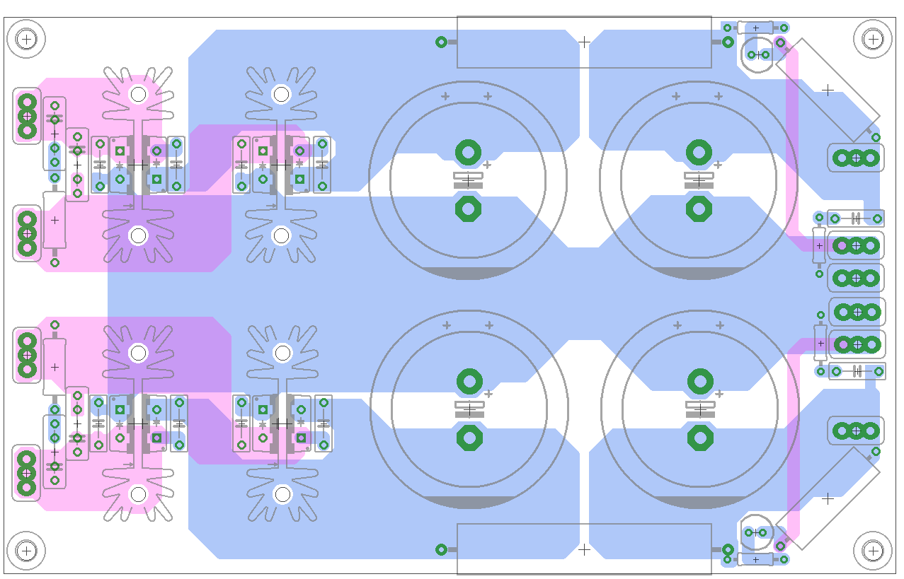

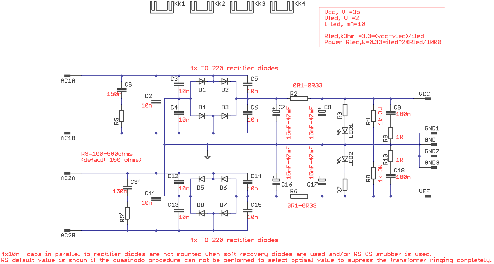

I did a bit of detective work in eagle to check the schematic versus the layout.
The rough layout posted here corresponds to the layout of Project16 gerbers.
The corresponding exact schematic according to which layout is made is also posted.
although i checked it thoroughly, Could Project16 or Fab or anyone vet the schematic?

Thank you Project16 for checking. Pl dont mind me posting a very ugly looking eagle layout, its just for extracting the exact schematic and checking it:eek:. Its just a first hand draft layout, made without thinking of symmetry, clearances and whole lot of other things that makes a PCB design special.
Your layout is much more beautiful and has many component options that will help any builder.
