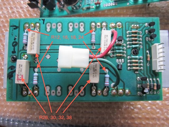

No obvious shorts there. Check all diodes on the PCBs. Which HS assy is the bad one, left or right?
Craig
Craig

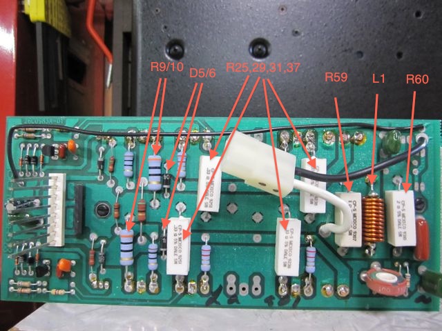

12345 are output devices. 7 is probably a LM350 which is a temp sensor. 6 is probably the driver transistors. 8 is the bias transistor.
Outputs and drivers are the same, four outputs and one driver per phase (five bigguns total). The one with brass colored clip is probably the bias xsistor. The TO220 is the predriver. Look on the schematic for anything that if shorted would connect the +rail to the output, D5 for instance.

Last night I checked D5 and D6 with the Fluke in diode mode and both appear to be fine. It would be nice if the components were identified on the PCB 🙂
D5 .41/inf
D6 .41/inf
I also went thru all the diodes (in diode mode) and resistors (in ohms mode) and all check ok, Im looking for opens or shorts right ? Pretty much all the values were as stated on the schematic.
Regarding which HS is Channel A, I dont know, how can I verify ?
Is there any chance that the op amps or the two other IC's could be causing this ? Or have I made some earlier error that has lead me in error to this point ? Or how about the last board that looks like the power supply ? There are no signs of physical damage that I can see after careful examination with a light and magnifying glass......

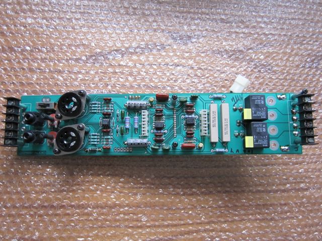

Look at the LAOPTO schematic, do you see IC2? Check the outputs 10 & 11 for CH.A and 5 & 6 for CH.B. I'm not sure if there is suppose to be DC there or not but they should be all the same. I thought at first IC1 might cause a DC offset but it is capacitor coupled to IC2.
Craig
Craig
I think your IC2 is going to be bad, latching up to either supply seems to be it's modus operandi. Check all resistors around that IC, might as well ck everything, there's not that much. MCM Electronics has STK3152s for $14.51, you might try Crest though.

Old thread I know but I have one of these on the bench now. Started with Channel A in protect, checked output before the relay and it's OK, good signal and NO DC offset. Found a shorted electrolytic in the protect circuit not letting relay drive circuit to function. Replaced all four caps in the circuit and we're good to go.
Craig
The culprits were "Surge" brand caps from guess where?
