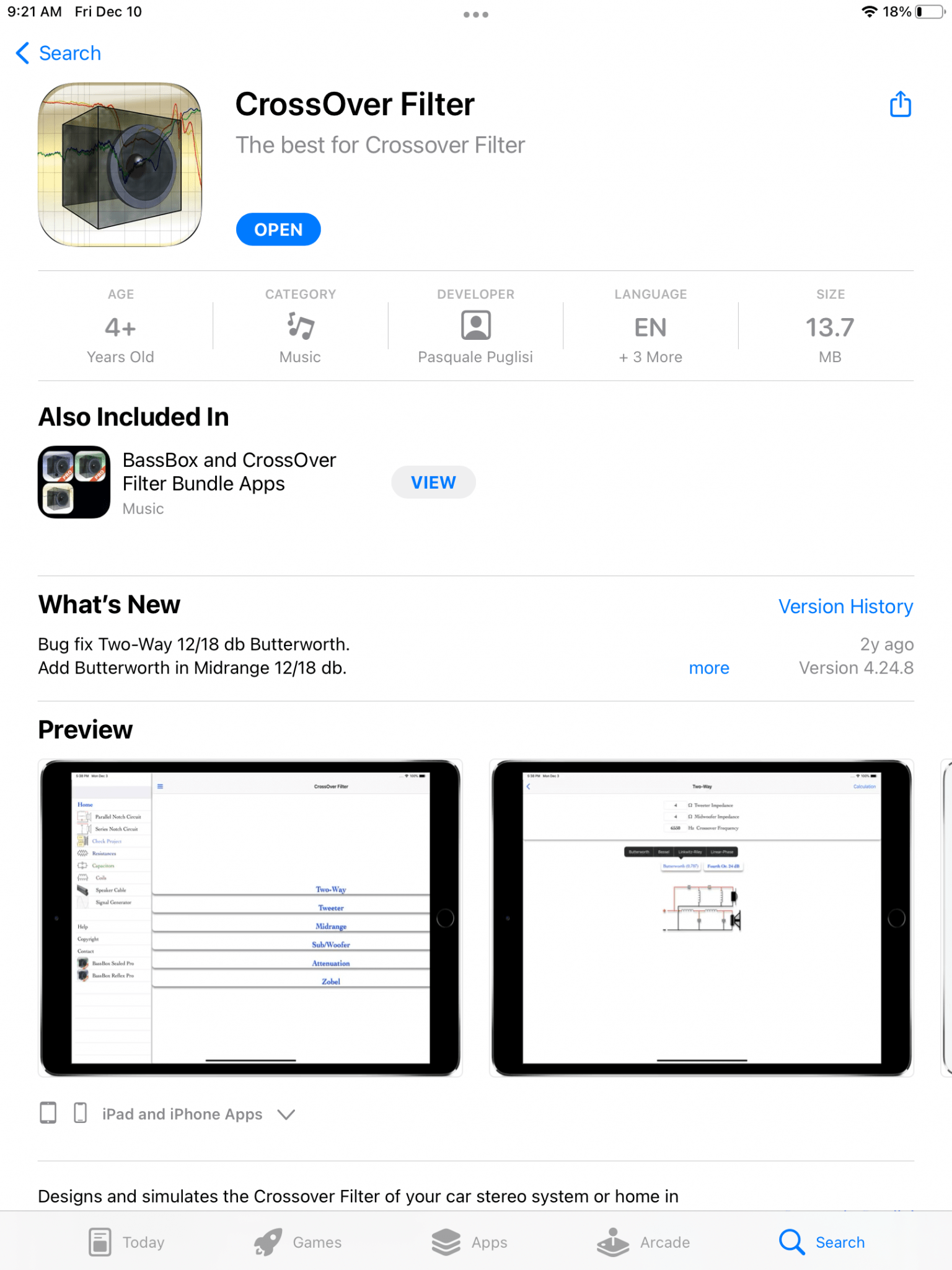

It might be that he can't download it on the computer he wants to use. My issue was I wanted to be able to work on crossovers at work in between jobs, but I can't download XSim to my work computer. If I could have found a decent online calculator, my problem would have been solved. I don't think he's asking to be spoon-fed, he's asking where he can get the tools to do his own work. This is what forums are for.so f 'ing what that you have to down load it to use it, sorry i'm somewhat tired of spoon feeding the next generation despite my own expectations not being met ...
Does it run in my iPad? I use this on my iPad and iPhone.so f 'ing what that you have to down load it to use it, sorry i'm somewhat tired of spoon feeding the next generation despite my own expectations not being met ...
