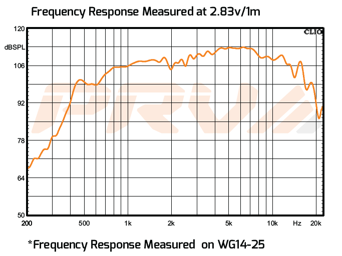

The PRV driver's blurb sheet includes a CLIO graph measured on the horn I intend to use, but how do I get that data into XSim?

Measure it on a horn.What about compression drivers (as well as closed back mids and tweets) where enclosure has no loading?
You won't get frd and zma for CDs because the curves will vary a lot depending upon what flare you mount it to. Gotta roll your own here.What about compression drivers
Roll your own here too, best on the baffle you're going to use to make the curves as accurate as possible to the final product.(as well as closed back mids and tweets) where enclosure has no loading?
As I said, the PRV blurb sheet has a CLIO graph with the the CD mounted to the flare I intend to use...
But, it is just a graphic in a pdf doc, Is there a way to manually transcribe the data points into a frd?

look here https://techtalk.parts-express.com/...p-using-spl-trace-to-create-frd-and-zma-files
let me know if this works for you, i have not tried this myself.

I just emailed a request to PRV, will try that avenue first...
but I'll go look at that spl-trace...
