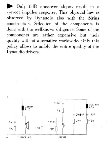

Hi Daniel,
Looking forward to your reply later. For now I thought I'd attach the basis of my x-over design as it is from Dynaudio's Sirius kit design but modified for the 8 ohm version 17W75XL instead of the 4 ohm which this original Dyn DYI kit/version was based on. Had added extra coil for woofer low pass to accommodate 8 ohm impedance versus 4 ohm. Perhaps the other sections above standard zobels on both woof and tweet are not necessary but again I'm looking forward to your comments...
Thanks,
Gordon
