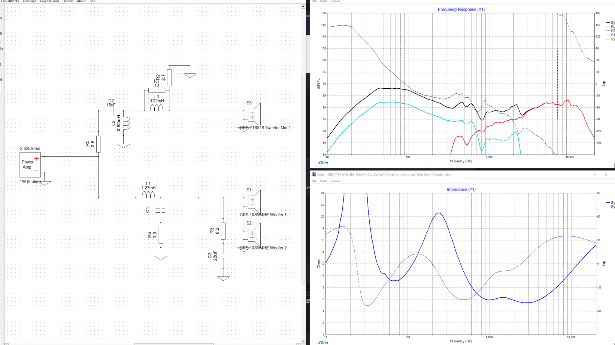

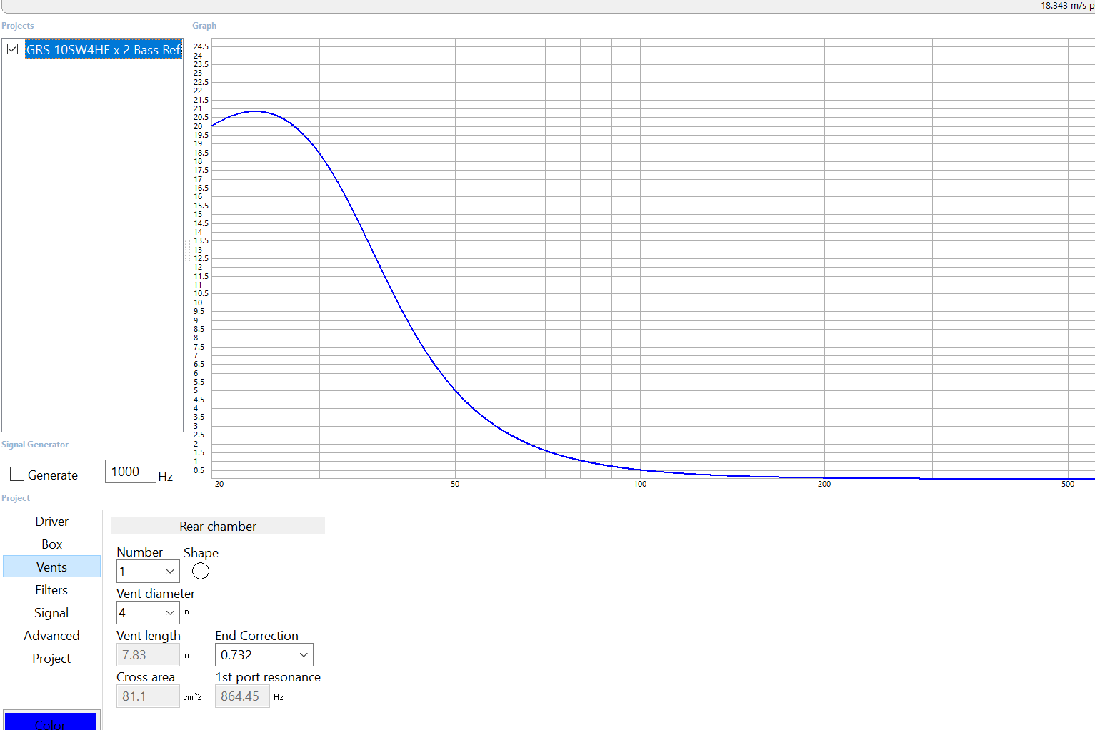

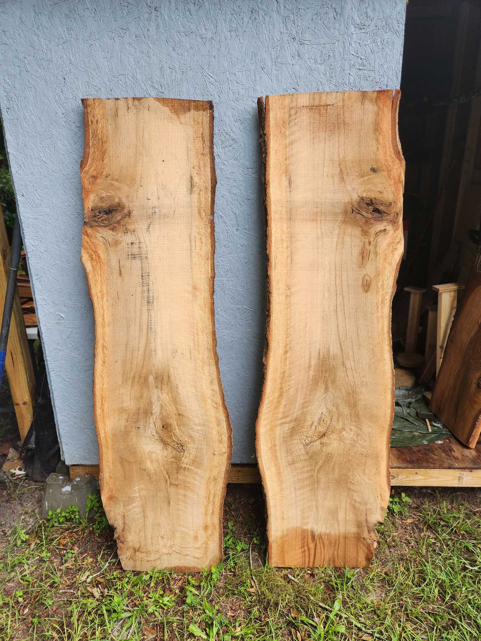

Baffle width needs to be around 10" to allow comfortable arrangement of 8" woofers on the face of the baffle. It'll be a solid oak slab, so I'm thinking 10" wide by 50" tall basically as a starting point. Then arrangement the drivers on the face so that the planar is approximately ear level when seated in the room, and the mid and sub woofers will be below the planar.

Note that driver(s), vent(s) ideally need to be at a pipe's odd harmonics, so with 'L' = internal height, 'Z' = driver and using the acoustic center of clustered drivers........I'll move things around to see what looks good.
Z = (L)x ~ 0 (top), 0.217, 0.349, 0.424, 0.561
Vent offset only, depending on box HxWxD ratio: Z = (L)x ~0.651, 0.714, 0.848, 0 (bottom)

No longer any bass reflex, all sealed. So will just be the drivers. The internal chambers will be separate. The two sub drivers will have their own 1.5 ft^3 sealed chamber. The planar and mid woofer will be in their own chamber too.

OK, but the rules still apply 'close enough' WRT the exterior baffle in your case same as OB.
All good, thanks. Will see where that all falls in line on the final baffle after I get the slabs.
