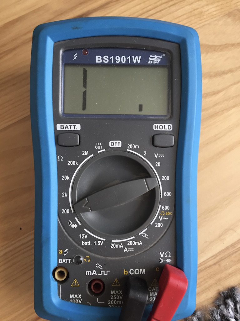

Ok, my bad with the terminology.
To make sure, here's the reading without a load, and then with the woofer.
That does look like an "I" ( maybe standing for "Infinite".
I'm sure that should be mentioned in the manual.

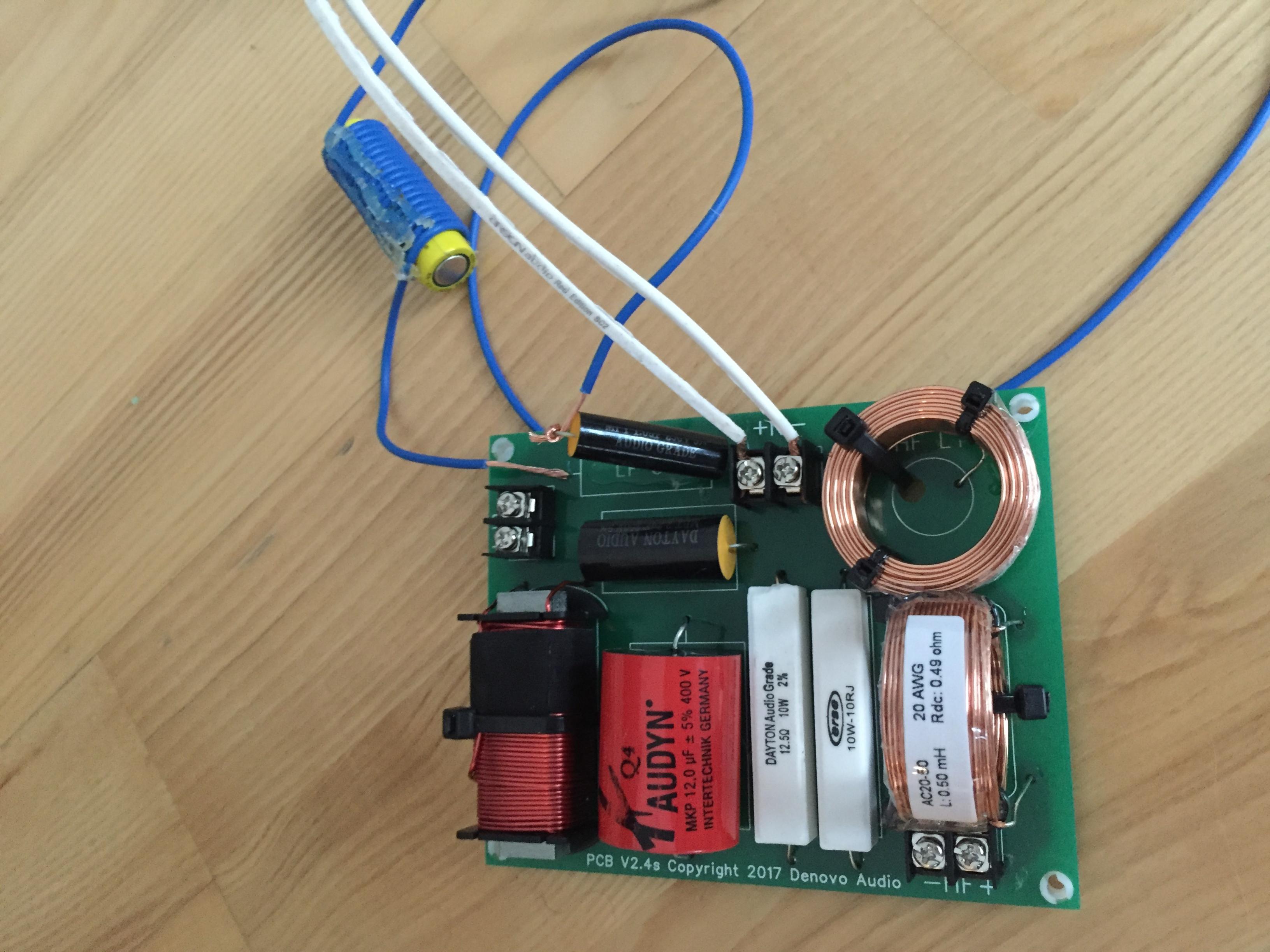

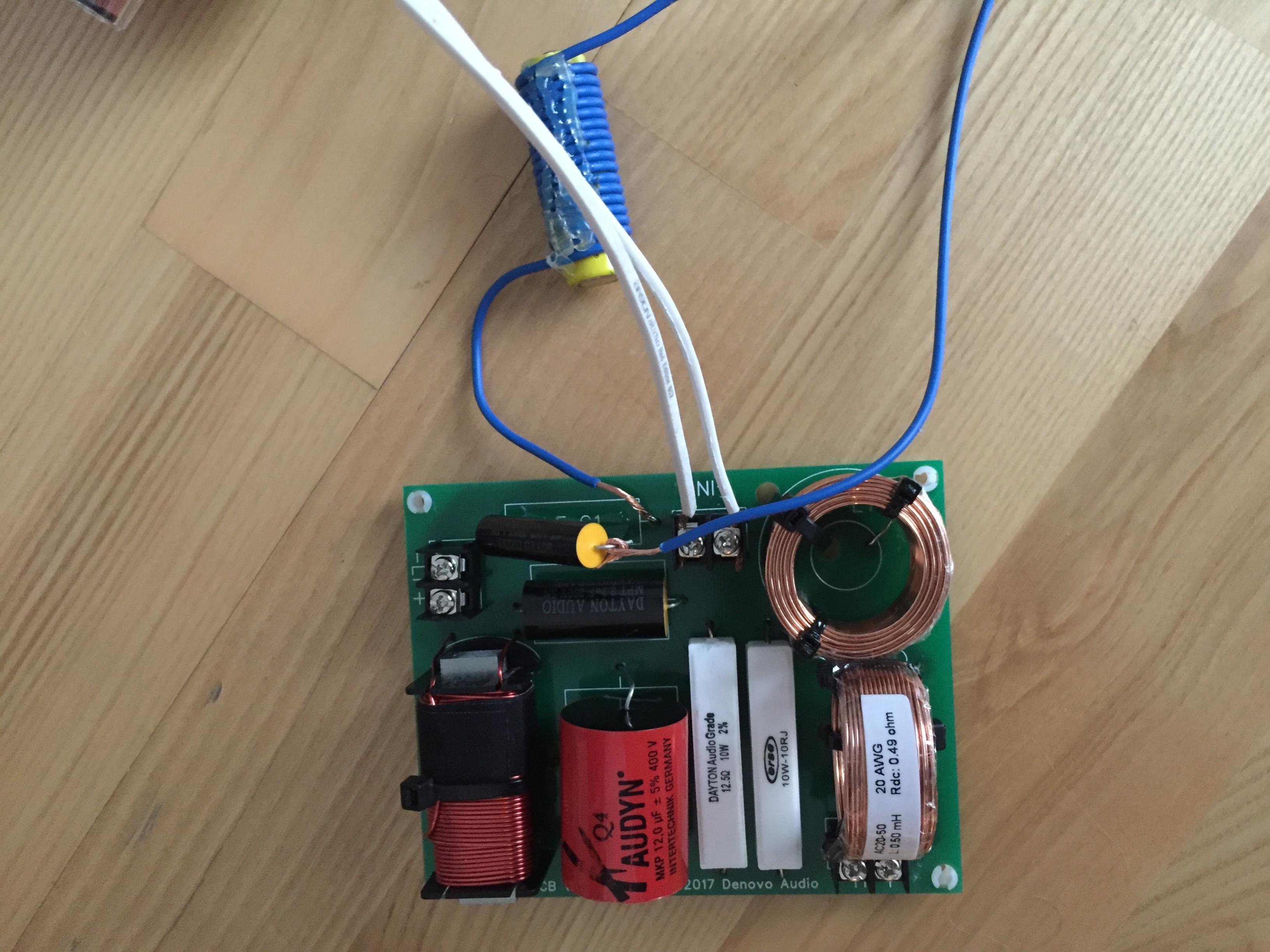

Got a tip I could test this with a homemade "inductor" as well, so went and tested it out.
And it works... See pics below (tested in series both before and after LF_C1 since I was unsure if it would make a difference at that time).
Whats the value of your homemade inductor?

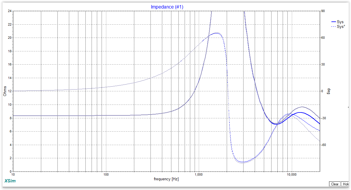

Is your ICE amp actually stable with a 2-ohm load within its pass-band?
XSim says that if the coil value is around 2.4mH then your amp is starting to see a load develop that's less than 2 ohms around 3400hz.
If it's .56mH then your amp is seeing about 1 ohm at 7K ( in a very hiQ notch ).
You should really just add the 10R resistor in place of that mystery coil ( the mystery coil lowers impedance in a very specific but unknown area, while we know the resistor << or lack of >> lowers resistance in the UHF up above 40K ).
IOW, adding the coil ( instead of the resistor ) is not the same test for isolating the problem.
Whats the value of your homemade inductor? Is your ICE amp actually stable with a 2-ohm load within its pass-band?
No idea for both questions

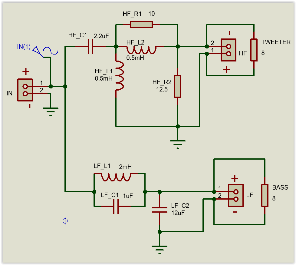

What does your schematic look like?
I tried to recreate it in XSim, but I might not have gotten it correct. See below.
Anyways, I'm not sure how to move forward here.
Both the XO design by DIY Sound Group and the amp is "kinda faulty", but not really...
Adding a 10R resistor in series with the cap will change the response (judging from XSim), and I don't really want to modify a filter design that should work in the first place.
You've laid-out ( within XSim ) the HiPass incorrectly ( as I understand what you previously posted ).
The 10R resistor in series with the 1uF capacitor might just be enough resistance to stabilize the UHF of your amp & save what you currently own ( & you won't know until you actually try it ).
Originally an over-range value was indicated by a display of 1999, but that was technically incorrect,
since you could be actually measuring 1999. Then they made the display flash on and off 1999.
Finally, they settled on just displaying the leading 1, to indicate an over-range value.

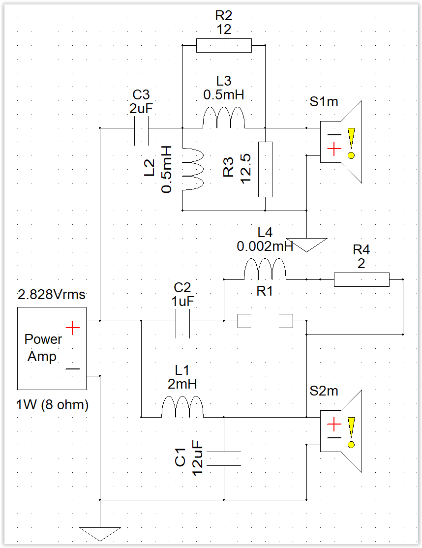

I have helped Defo with this filter on a Norwegian forum. I made a drawing where I overlayed the arrangement drawing of the parts on top of a mirrored picture of the PCB. In this way it is easer to reverse engineer and create a schematic. The overlay is showed in pic1 and the resulting schematic is in pic2.
We can see by following the red line from negative to positive input terminal that there are two capacitors in series. (LF-C1 and LF-C2).
This will effectively short any high frequency signal and I suspect that it is only small variations in components values that makes one of the filters trigger the protection circuit.
I am no passive filter design expert, but my suggestion was to insert a 2uH inductor and a 2 ohm resistance in series with LF_C1 to block high frequency signals. The 2 ohm resistor was recommended because it will dampen the resulting tank circuit formed by the new inductor and LF_C1 creating a resonance peak at 112kHz.
He tried only the 2uH inductor, and then the amplifier did not trip the protection circuit anymore.
There seems to be conflicting opinions on how this filter is made. Please check if I have made the schematic correctly.
DIYSG designs are beta-tested on typical AVRs.
PS; I'll post my file in a moment
Okay XSim file ( with quick component fix ) has been posted.
Use the "Hold" function to toggle between old values and new values ( I doubt you would hear the difference )
This will have so much impact that it would be pretty much the same as removing the 1µ cap from the original circuit.

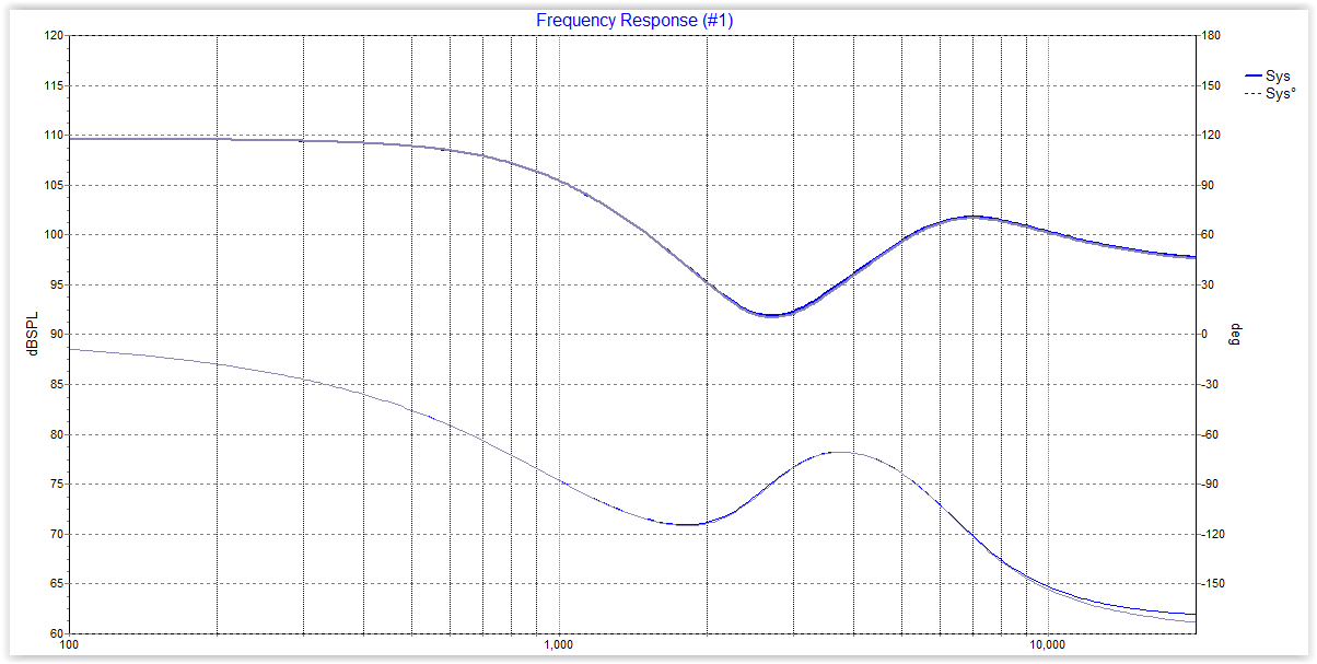

I made a xsim version of our modification. Pic1. The resulting frequency response is in pic2. And the resulting impedance response in pic 3.
Using the hold function we can see that the response for the woofer is identical except for the impedance above 10kHz.
In pic 4 I have simulated this up to 1MHz with and without the 2 ohm resistor in series with LF_C1(and the new 2uH ADD_L inductor). The difference can be seen in the plots to the right in this pic. Without the 2 ohms resistor we get a huge resonance at 112kHz from the tank circuit LF_C1 and the new 2uH inductor. How problematic this is in real life can be argued. 1 ohm almost eliminates this problem also.
Anyway, this modification alters the filter less than adding a 10 ohm resistor and will also increase the filters impedance above 100kHz. This will give added headroom for the switching residue of class D amps that operate at about 500kHz.
Ok, I have had a Skype-chat with Armand on this for a while now, and my conclusion is that this filter is just so badly designed that one should just start over.
That's a real bummer. Bought the kit for the very reason of not having to design a crossover myself.
With no drivers I get no reading (0 ohms). With tweeter connected, I still get no reading. With woofer connected I get ~6 ohms.
Guess that means soldering is "fine" (working at least).
Done. I disconnected LF_C1, and issue is gone.
I then reconnected said capacitor, and disconnected LF_L1. Issue still present.
Good! Then swap LF_C1 from the 'good' board and see what happens.
