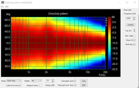

Hi! Got a DIY 600hz horn with a 2" Compression Driver (Paudio DE99) and JBL2225H 15" Woofer bi amplified and active crossover by minidsp.
Listening distance from the speakers is about 3meters away.
Looking for some crossover recommendations that would improve the "centering" of the vocals to improve the sound, and a more solid midrange.
Tried out different points and crossover slopes but I keep coming back to HP at 1200hz 6db/octave butterworth and LP at 600hz 6db/octave butterworth.
The one octave underlap between the crossovers is deliberate since that seems to sound the best for me and sounds more "live".
I may be exhibiting a bias since Im a fan of 1st order crossovers so any recommendation would help and I can immediately try it out since I have a minidsp.
Attaching pictures of the measurements and the speakers.
Priorities are dynamics and a more solid center vocal image.
Thanks in advance!

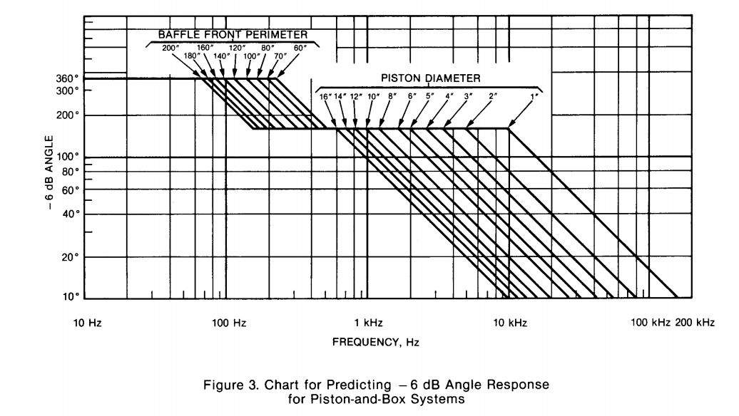

You don't have to keep it at 600Hz just because the horn is 600Hz capable, but the convention is to pick a crossover frequency where the directivity of the woofer gradually transitions to the horn, without being noticeable. Now, since this criterion indicates not a single frequency but a band of frequencies (around 800Hz), as you can see in the pictures where the -6dB beamwidths are similar.
That JBL is a big boy, so beaming will start fairly low. Normaly I would suggest lower xo point, about half an octave above horn cutoff frequency or 850Hz. Unfortunately, there is nasty step in CD response at 800Hz, probably with phase issues as well. So, for HF, I would stay with 1200Hz xo point, but with 2nd order for better attenuation of that problematic area around 800Hz.
For LF, current 1st order at 600Hz dont give enough attenuation above 1200Hz, so despite
"underlap" you actually have JBL overlapping with horn, smearing the midrange.
Also, according to speaker pics, it looks like acoustic center of JBL is in front of acoustic center of the horn. For both reasons I would go with 1200Hz 3rd order for LF.
If you have problems with "centering" of soundstage, one possible reason might be that furniture you have in between speakers.
You should have clean space between speakers, especially at height of HF driver.

Wow! Thank you for pointing me in the right direction!You don't have to keep it at 600Hz just because the horn is 600Hz capable, but the convention is to pick a crossover frequency where the directivity of the woofer gradually transitions to the horn, without being noticeable. Now, since this criterion indicates not a single frequency but a band of frequencies (around 800Hz), as you can see in the pictures where the -6dB beamwidths are similar.
Dont have the foggiest notion of directivity data though.
Sorry if I'm making a mistake but does the chart above suggest the since I have a 15" woofer a 6db/octave 800hz would be a better match directivity wise?
If I'm not making sense (or I'm failing to understand your post) I'd be happy to hunt down suggested links or topics for more knowledge pending some suggestions or guide words to point me in the right direction.
Where can I find that beamwidth table and the accompanying book or website?
Thanks again!

Well, here itself (link), last post.Where can I find that beamwidth table and the accompanying book or website?
https://www.diyaudio.com/community/...cy-are-drivers-really-omnidirectional.359166/
