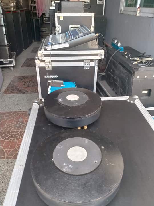

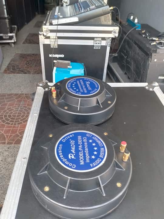

Also, hornwannabe, could you please show some close-up shots of the compression driver throat and phase plug ? Also, is this driver the PA-D99 or the throatless PA-DE99 ? I'm asking since I guess it was you in the following thread.

Oh yes that is indeed me.Dispersion should be more or less OK in either case (900Hz / 1200Hz) but I guess 900Hz would sound smoother (without narrowing) when sine swept from woofer into the horn.
https://www.diyaudio.com/community/...d-driver-that-can-reach-500-hz.321521/page-11
As you can see, my past idiot self got slapped by physics.
Was able to attempt a 500hz crossover.
A lesson I learned from this was:
Even if it's possible it doesn't necessarily mean it's a good idea hahaha
God this build was 3 years in the making since I finally finished it last year!
Anyway since you're so intent on the info, Ill attach the pics and I used theseto mate the horn to the CD
