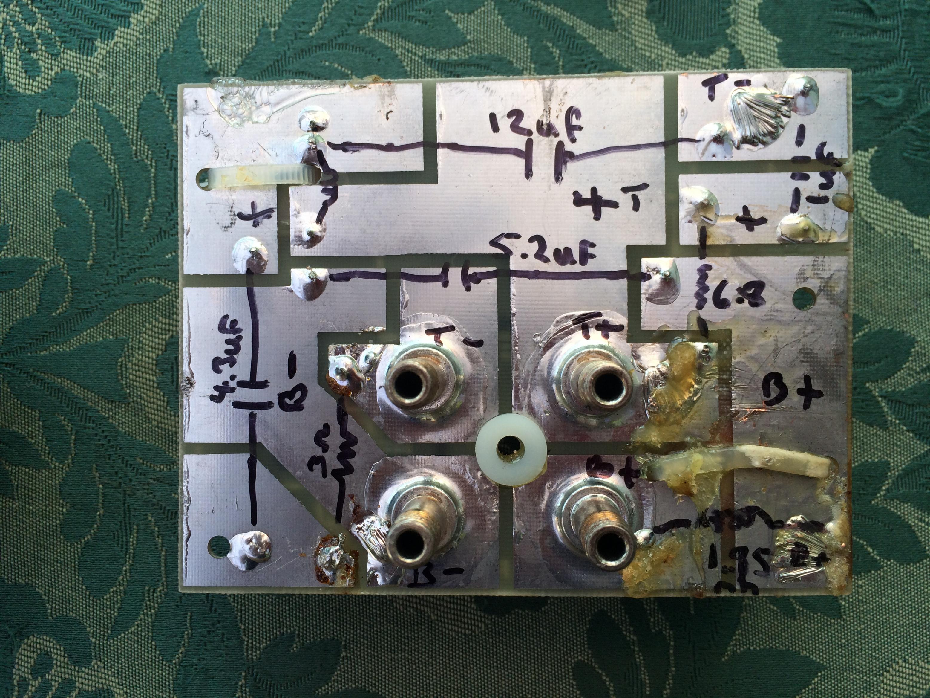

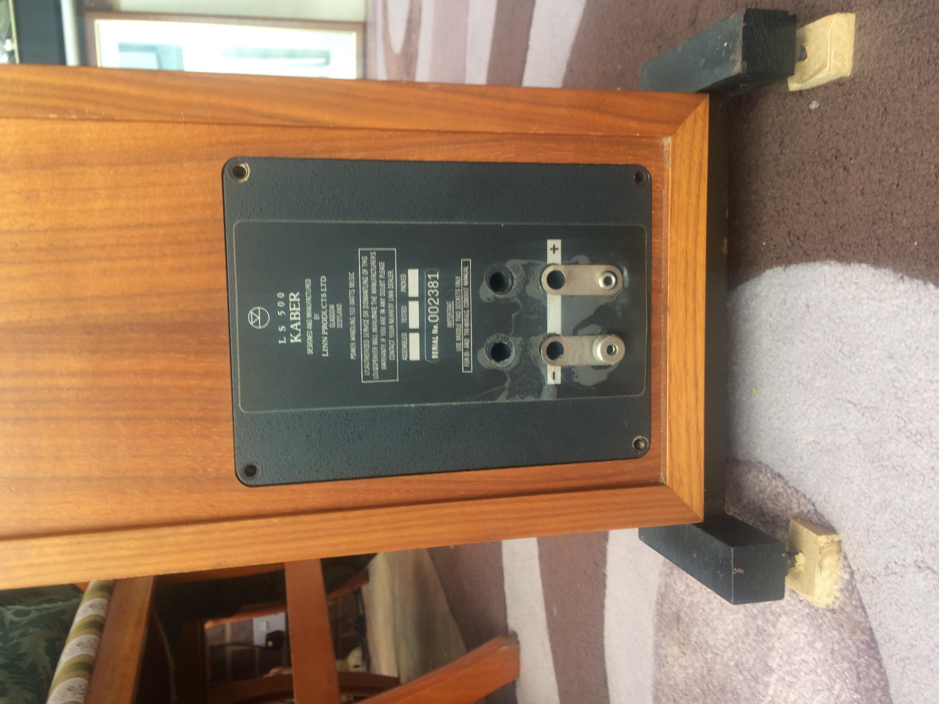

Hi all.Looking for some help obtaining a crossover wiring diagram for my Linn Kaber speakers.They are passive and are about 35years old.Serial No. is 002381.

If you can show from up close the crossover board from both of the sides, then at least capacitors and resistors might be identified and their respective schematic as well.

Hi Lojzek.Thanks for the reply.Here are the photos of the crossover boards and my, hopefully,correct interpretation of the components.

Thanks again for the reply Lojzel.That's brilliant!Really appreciate you taking the time to help.

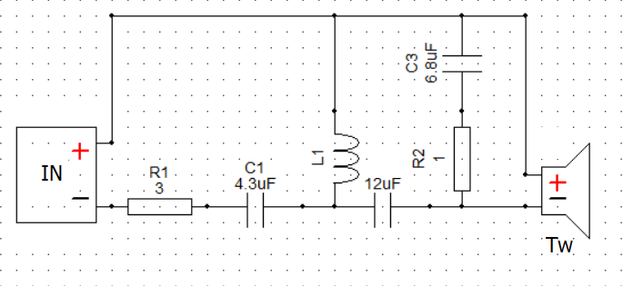

Hi Lojzek.Just wanted to ask a quick question about the tweeter circuit.I see that you've
got the positive side going to earth.Does this mean that when i connect the wires to the
tweeter i should reverse the polarity.

All of the drive units in this loudspeaker are connected in phase. This tweeter circuit should be less confusing. It seems manufacturer decided to place the parts in the negative branch unlike majority of others. Electrically it's irrelevant. Either way is alright.
Maybe just me, but that's a funny old circuit! Never seen one like that before... 😀
Seems to be an MTM wired up as 2.5 way, like the above Troels Gravesen design!

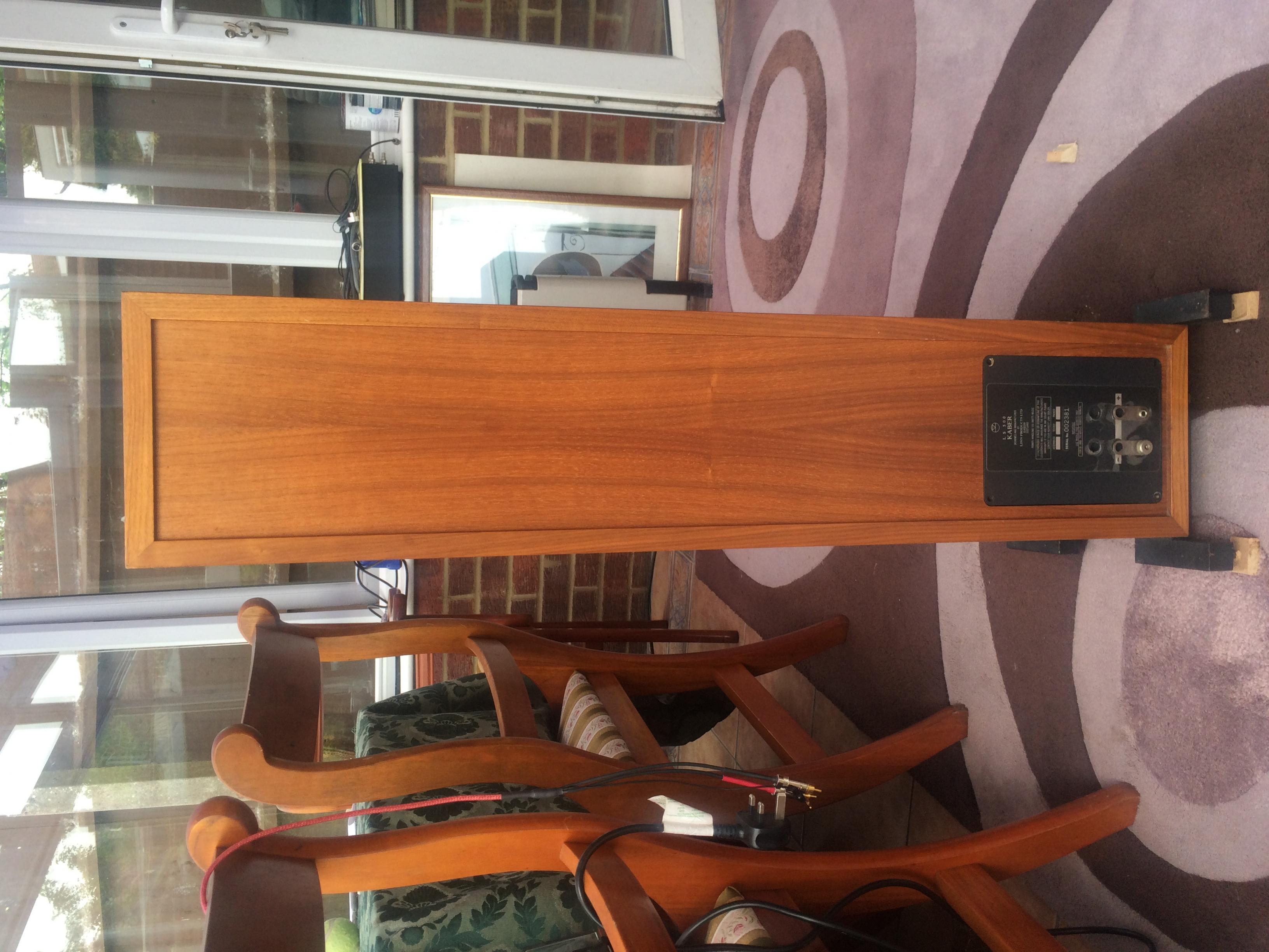

Steve, you can post a JPEG (640X480) picture of these cabinets with the paperclip in the advanced reply box direct to the forum. I want to see this. Seems there were a few models.
