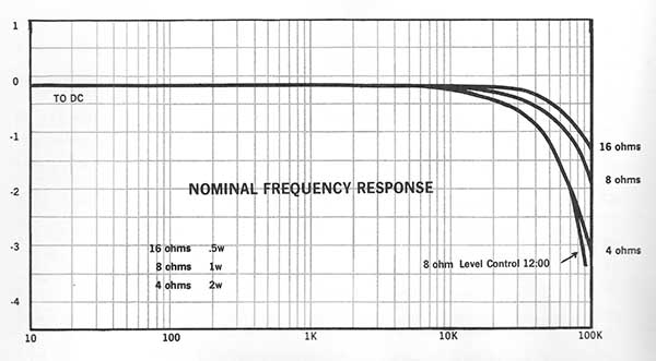

From my DC300 manual:
These amplifiers have no input capacitors and have a frequency response +-0.1dB from DC to 20kHz
I would suspect your signal input and if not that, your speakers.
Exactly what I said: 1 db down at 45kHz at the lowest load impedance. 🙄From my DC300 manual:
As mentioned above, 0.1dB down at 20 kHz.
No trace of "+10 dB above 2 kHz" 😱
These amps, DC300* are designed to produce DC voltage, for such things as throttle control solenoids, linear actuators, etc.
Hope you meant "designd to amplify DC voltage " 😉

The last time I did a FR sweep on mine, it does roll off quite a bit as shown in the manual.

It appears that after re-measuring the crown the response is more like 4 dB up in the treble. This is compared to the output with my moscode amp. Also the bass is down in midbass and lower bass by several dB.

The capacitive load won't cause a 4 dB tilt up in the HF response. May cause peaking above the audio band, but its effect at 20k should be well under a dB. If you really do have a rising response there is something wrong. Old electrolytics could cause it, but it still seems weird. I'd suspect calibration isues. A falling response is more likely with bad electros.
If you are actually getting a rise in FR at the high end this could be caused from resonance peaking due to the Leakage inductance of the transformer and the panels capacitance.
The resistors in series with the primary winding is what is used to reduce this Peaking affect in ESL's.

That's not the amplifier's fault. 4dB of acoustic rise and coming out of the speaker and 4dB of peaking in the amplifier's response are not the same thing.
