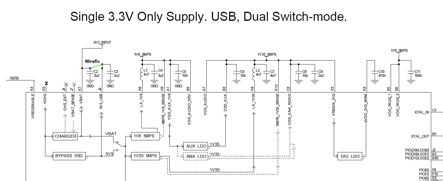

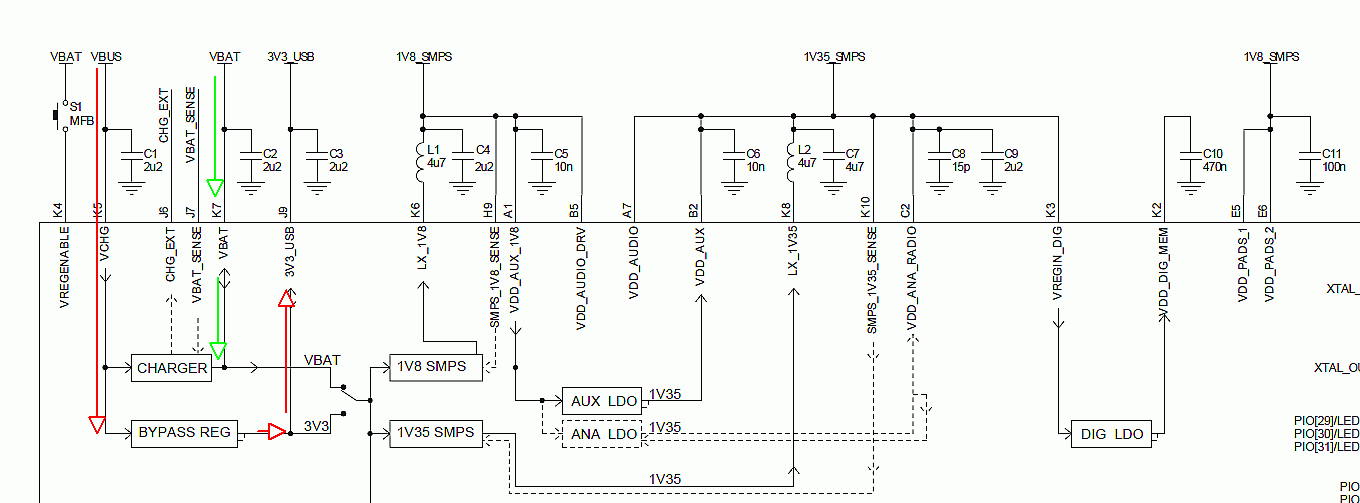

Fix:
Limitation:
When running this in bus powered mode, BT is not longer working in this configuration as long as USB is connected. So device has to be in a self-powered mode, aka battery or external ldo and needs a wire patch to power the USB block from external ldo.
Code:
// PSKEY_USB_VENDOR_ID
&02be = 0a12
// PSKEY_USB_PRODUCT_ID
&02bf = 1243
// PSKEY_HOST_INTERFACE
&01f9 = 0002// USB link
// PSKEY_USB_VM_CONTROL
&03c0 = 0001// True
Limitation:

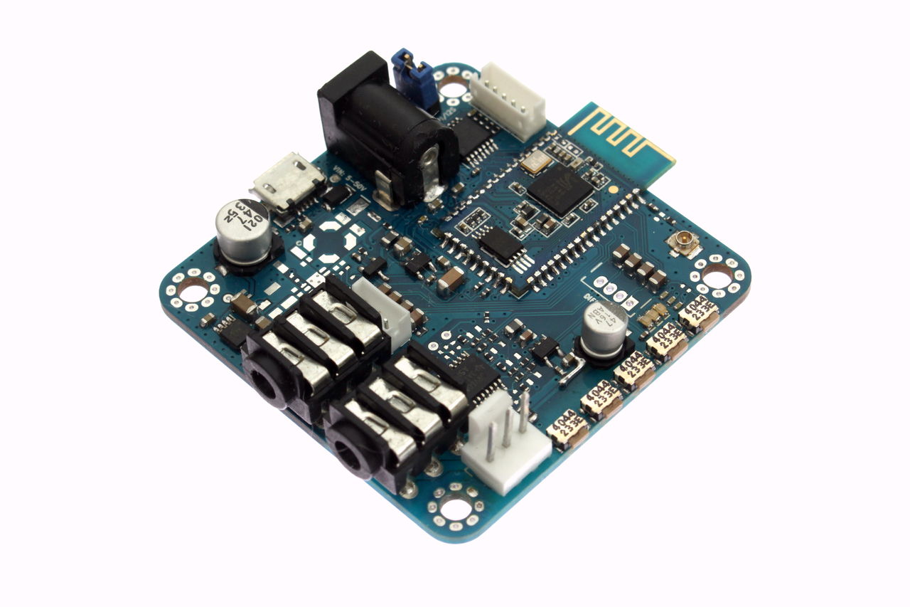

I now give up on the idea these modules are capable of outputting any digital stream with the firmware shipped. To me it looks like the firmware enumerates the parameters set by the PSkeys. (Which is valid at any time) While the PSKeys set the initial parameters, the program is free to alter the settings. So, without a different firmware, there's no hope for me.
Regarding the connection range of the baseboards shown in this thread, i tested the onboard antenna in comparsion with the Molex patch-antennas.
While the onboard antenna is good for ~10m/32ft, the Molex patch antennas provide a stable link at 40+m/131ft. (Longer distance is to be tested)

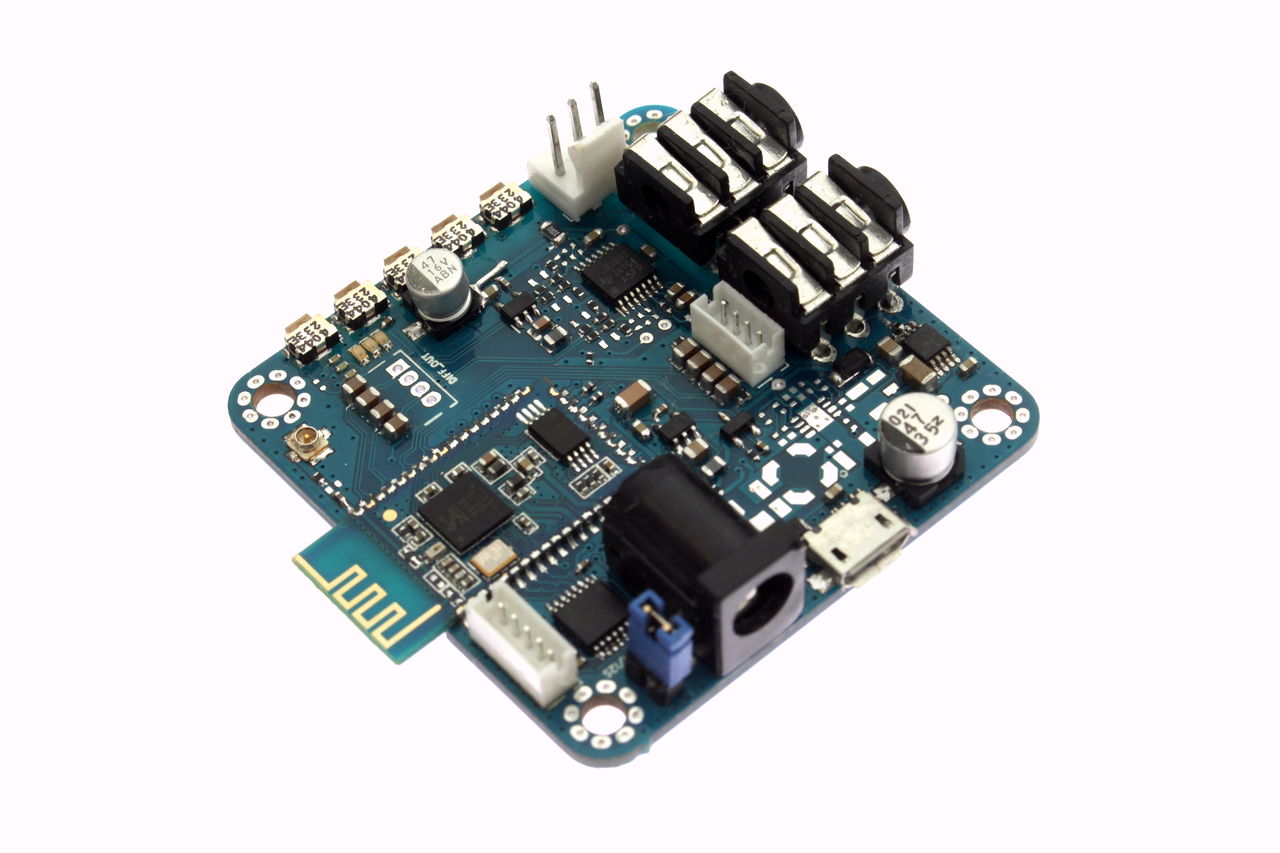

I've been watching this thread for a while now as I've been interested in a BT-to-digital module.
Instead I ended up ordering a CSRA64215-based module which is outputting I2S with no modification to hardware or configuration data:
https://www.aliexpress.com/item/CSR...odule-APTX-LL-TWS-I2S-Output/32716171541.html
I'm using it directly connected to a PCM5102 module for test purposes:
ASSEMBLED PCM5102 DAC decoder I2S player 32bit 384K beyond es9023 or PCM1794 | eBay
Presumably the I2S output could be connected to a WM8804 for conversion to S/PDIF if required. This is what I intend to do.
Just thought I'd mention this CSRA64215 module as an alternative as it appears to be being a struggle to get the CSR8645 to provide a suitable digital output.
