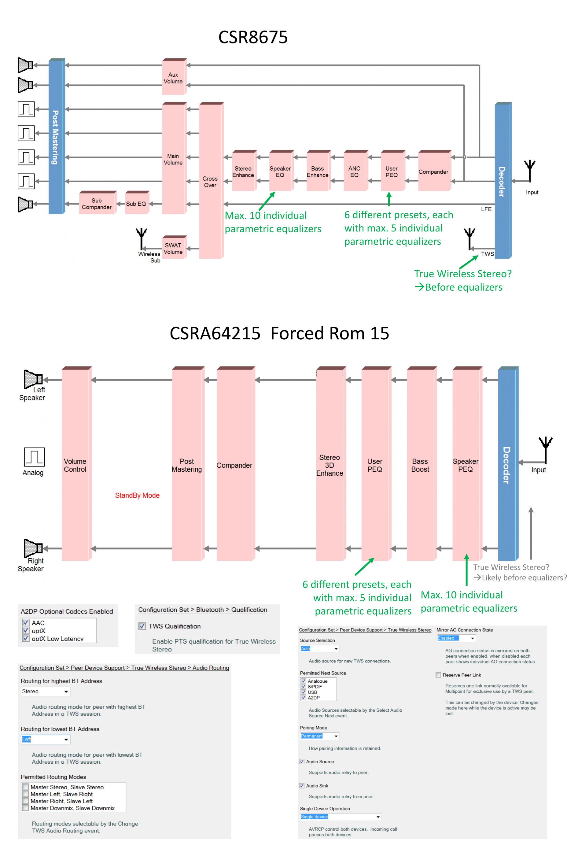

Hi Diysub,
I tried dyamic bass adjustment but did not get it to work -->I use the User PEQ. To protect the drivers I use a high shelf filter to remove the very low frequencies which my drivers are not capable to reproduce.
As far as I know: Multipoint means multiple (only 2?!) transmitters (e.g. phones) connect to one receiver (CSR board). Only one can play at a time. You mean True Wireless Stereo, it seems that this signal is branched off before the EQ stuff:
DSXgVOB2AIAAAAAAIQoYgsAAAAAABCiiC0AAAAAAECIIrYAAAAAAAAhyTD+H9Msm8dVbZhfAAAAAElFTkSuQmCC
But I do not know whether the speaker signals of the "transmitting CSR board" and the receiving are in phase or delayed.

I did some research and it seems that CSRA64215 has TWS and multipoint! I thought it has no multipoint and that is the reason for using the CSR8675..
I have one CSRA64215 here and can confirm: AptX works, multipoint works (2 phones) and in config tool (forced rom 15: https://www.diyaudio.com/forums/dig...a64215-rom-15-csra64xxx-v2-3.html#post5663329) it is possible to activate TWS! →I would recommend trying it with cheap CSRA64215 boards since with the Tinysine boards AptX+multipoint does not work (post #20).
Here are some screenshots I made on the way:
If you do not need a lot of power you could try the board with integrated amplifier which I have here and run it at 12 V (https://www.diyaudio.com/forums/cla...5-bluetooth-4-0-noise-fix-24.html#post6290609) or use stand alone Bluetooth receivers. Keep in mind that there are versions with differential and single ended output. $26? for the combo, ~$10 for a stand alone board and it is also a lot easier to solder the cables for the programmer compared to the Tinysine boards. Often you additionally need an isolated DC/DC converter for the power to avoid ground loops.
With these CSR boards it is usually not straight forward, so I can not promise that this is the best approach but it seems like a good start. I would recommend trying everything with 2 or 3 boards before buying 5 at once.

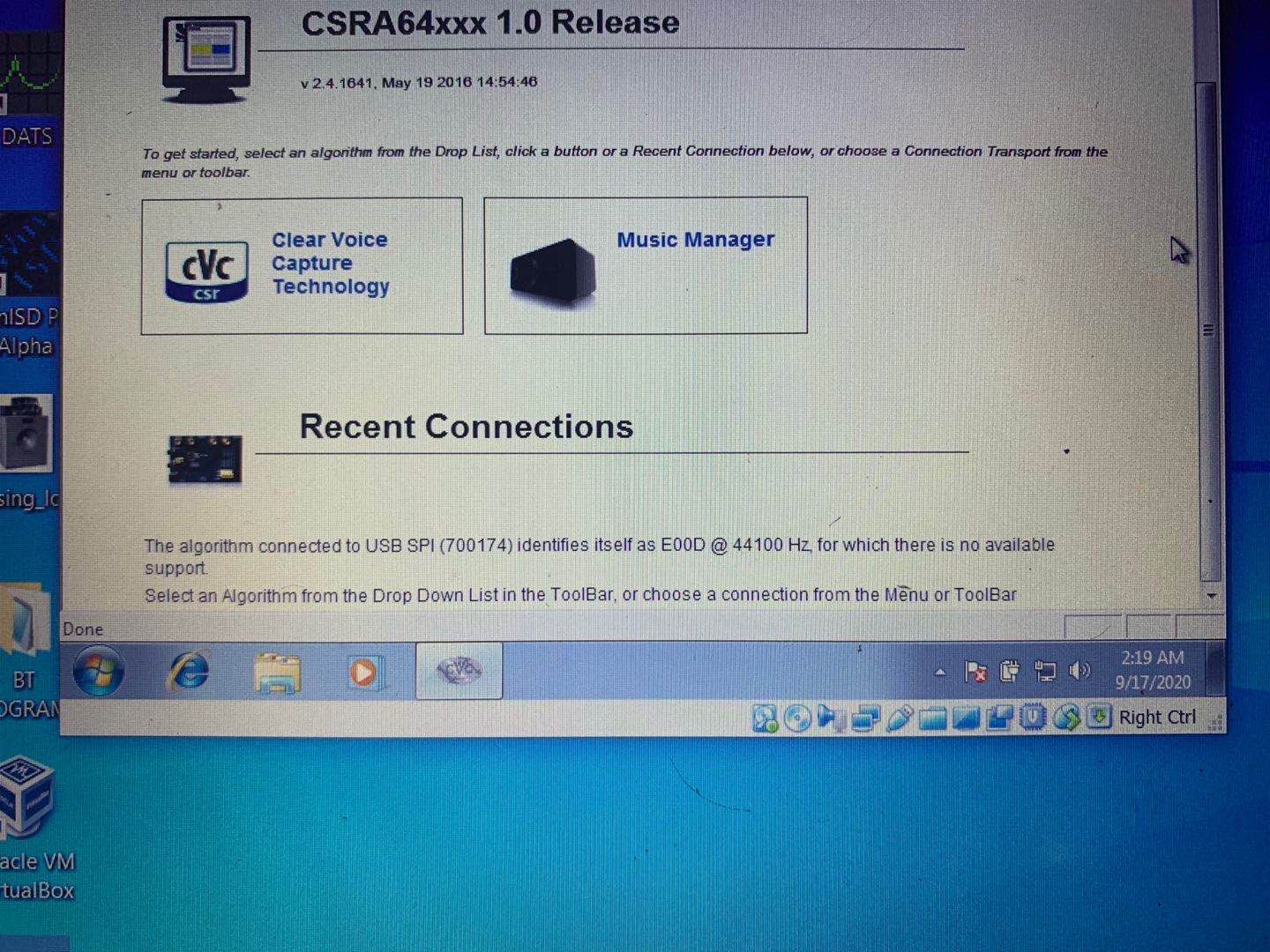

Hello has anyone had any luck with connecting a CSR8675 to the CSRA64 universal front end program and connected it to the DSP to change EQ settings. I have done everything i can and still no joy. i have followed all videos using 32b windows and have also followed the tinysine website and still not joy. Any help would be great. I am using the Tinysine firmware and the ADK works great just cannot connect to DSP
Hello thank you so much for your reply, i am still really butting my head against the wall with this one. i am getting somewhere slowly i think. The CVC program now responds with (see the attached photo). to me that says the program is recognising the algorithm but cannot open it because its not supported. does this mean i need a more updated ADK file? or have i burnt out the spi programmer maybe?
Again thanks for any help that can be given. This is the last piece to my project and i'm struggling.
