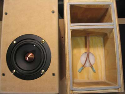

I did use the Northcreek sizing guide, so just under 2L in the aperiodic section (and stuffed with polyfill), and the breathing area is VAS (~5.5L). I did not use a ScanVent, I just used a piece or 3/4" plywood with a 2.5 or 3" hole in it, a bit of fiberglass insulation (it's been a while but I think about 2.5 - 3 inches uncompressed), and a thinner (1/8") piece of wood with a matching hole to compress the fiberglass screwed into the thicker plywood on the back. The back of the thicker plywood was also rounded over just in case. This picture should help clear things up...

I should have Chris's Northcreek MAPD design for the FR125's up and running tomorrow. Many thanks to Chris, Dave, and all here for your information and ideas on this driver. I'll try to post some pics and a cutlist up here, as well. Some folks might like this box because I've used the CSS baffles and I think it will deal nicely with the low end.
Northcreek and others referencing the aperiodic enclosures suggest to stuff the compression chamber full. Is that a must? Is it for back wave reflections or is it for dampening frequencies?

I have the FR125 in the Northcreek based MAPD up and running. Again, many thanks to Chris, Planet 10, and others for sharing their knowledge and experience with enclosures and this driver.
Cabinet exterior dimensions are H=11" W=6.5" D=12"Compression chamber volume=.066^' Larger chamber is .199^'. Total volume=.265^'.Chamber through hole is 2"Dia.These dimensions allow the use of the CNC baffles that are available. I'm using my laptop and the Sonic Impact original T amp at present. Tomorrow I'll give them a run with larger gear and can post back then. First impressions: The MAPD deals with the bass in an adequate manner. The bass is only limited by the driver's rolloff. It's tight and not boomy at all. The imaging with these boxes is great, especially nearfield. The mids and highs are clear and detailed. For my listening habits, a tweeter wouldn't be necesary. The bass is not up to a full two channel set,IMO, but is more than adequate for nearfield or HT use. A subwoofer would get it all together, especially crossed high to 100 +hz. I had the compression chamber stuffed with dacron but removed it as I don't think it afforded any effect. I used dacron as the aperiodic vent, as well. One layer of 1/2" behind the hole and hole stuffed with 1".
Overall, a great driver with an enclosure that mates well.
I tried to attach a pic but my resolutions are too big. I'll have my little photo editor tackle that in the AM.![angel :angel: :angel:](https://files.diyaudio.com/forums/images/smilies/angel.gif)
