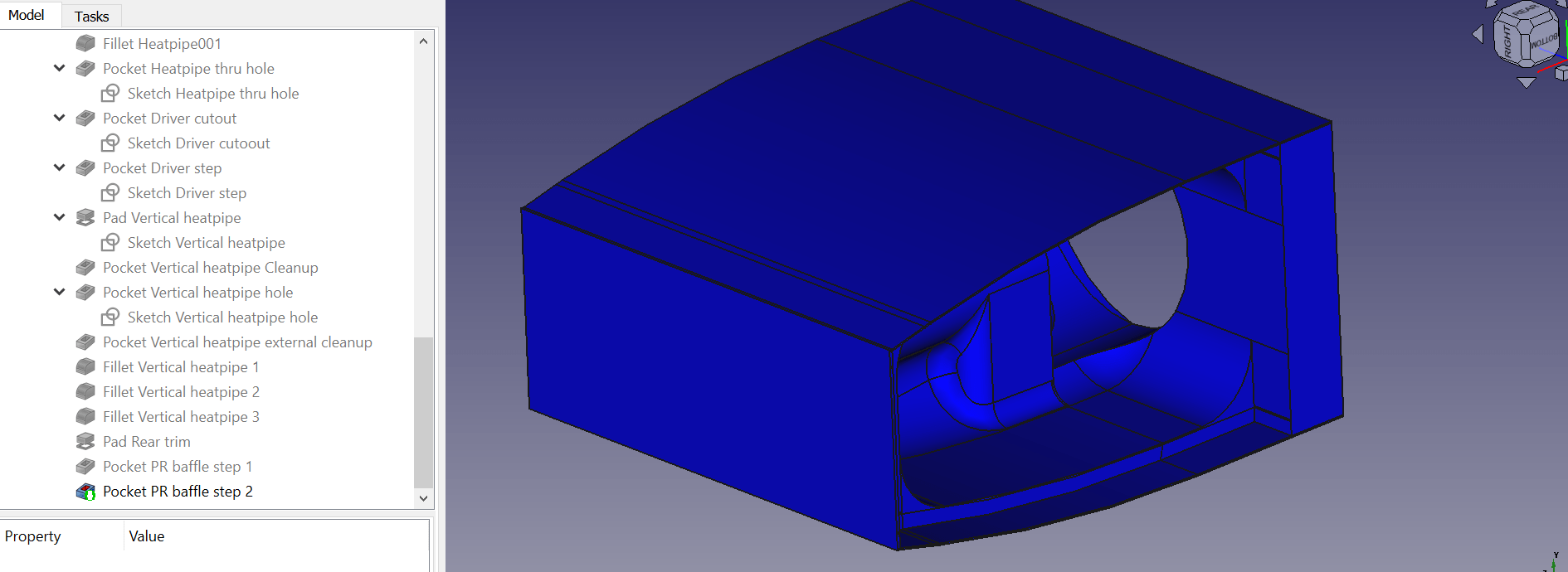

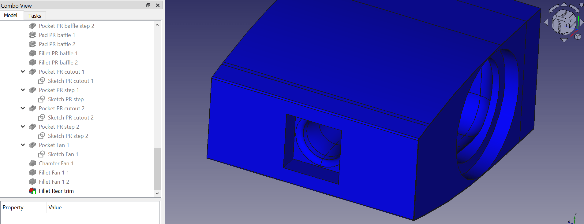

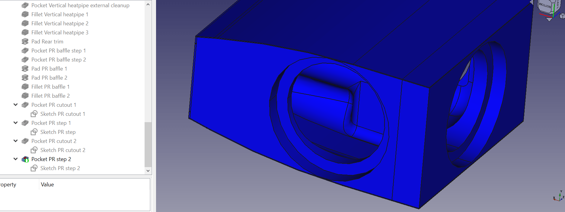

I realised that I need to form the fillets before creating the driver cutout. This is how the pipe will be tabbed in. Some of this will be cut away with the driver opening

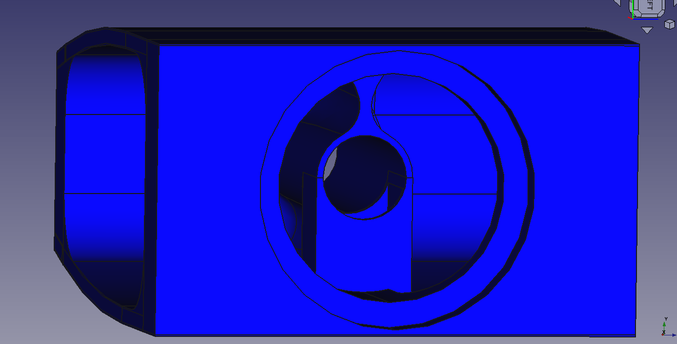

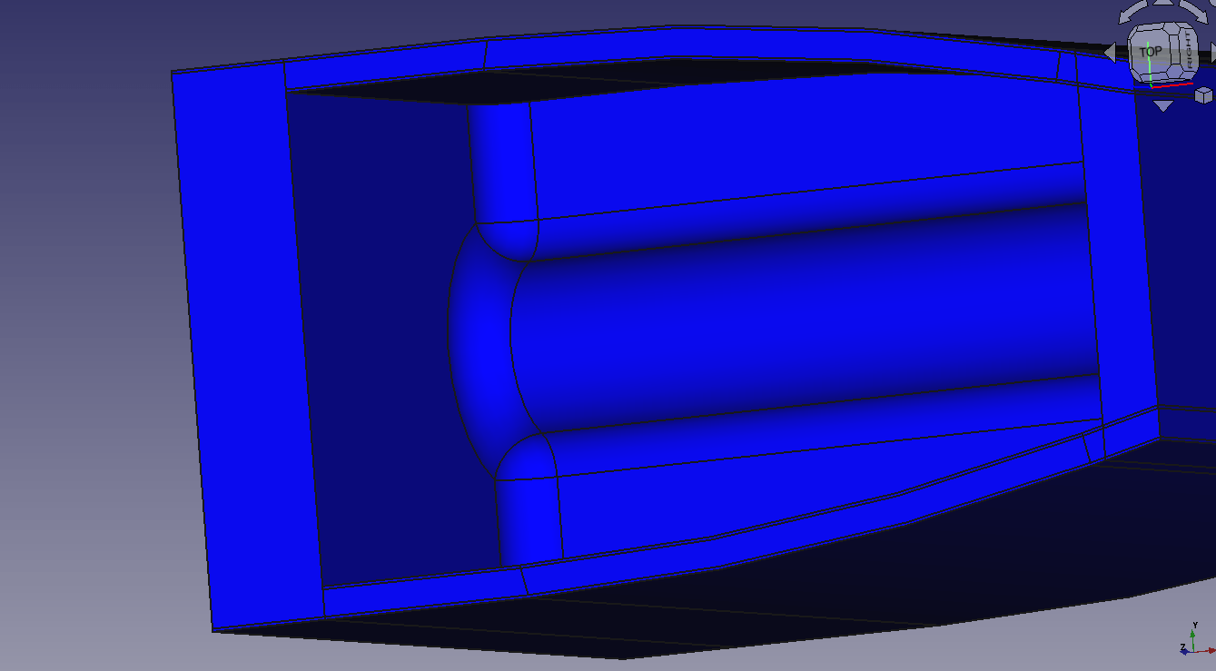

The fillets in the previous update do not meet my spec in this area. So I had to take the model back to the point in time of creating the back panel. There is a limitation in FreeCAD that I had to find a work around for and in this case turning the back panel to 30mm from 20mm thickness did the trick. Now I can set 40mm fillets instead of 9mm. The updated pic shows the new internal fillets

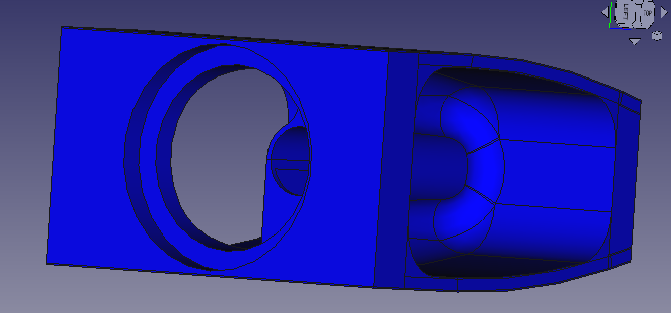

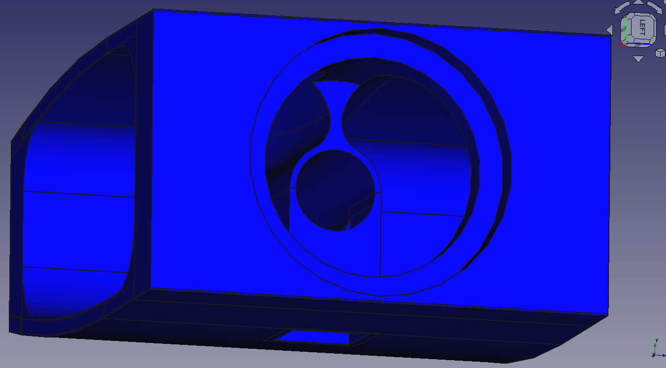

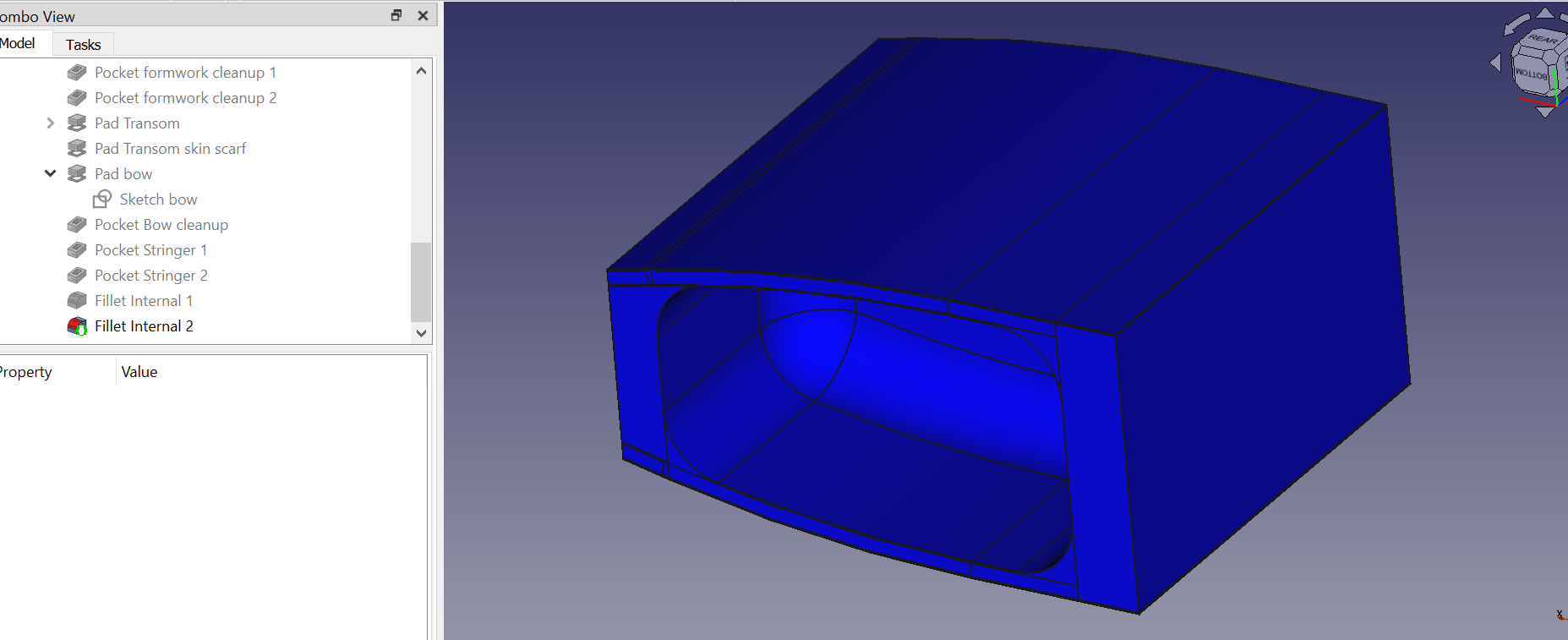

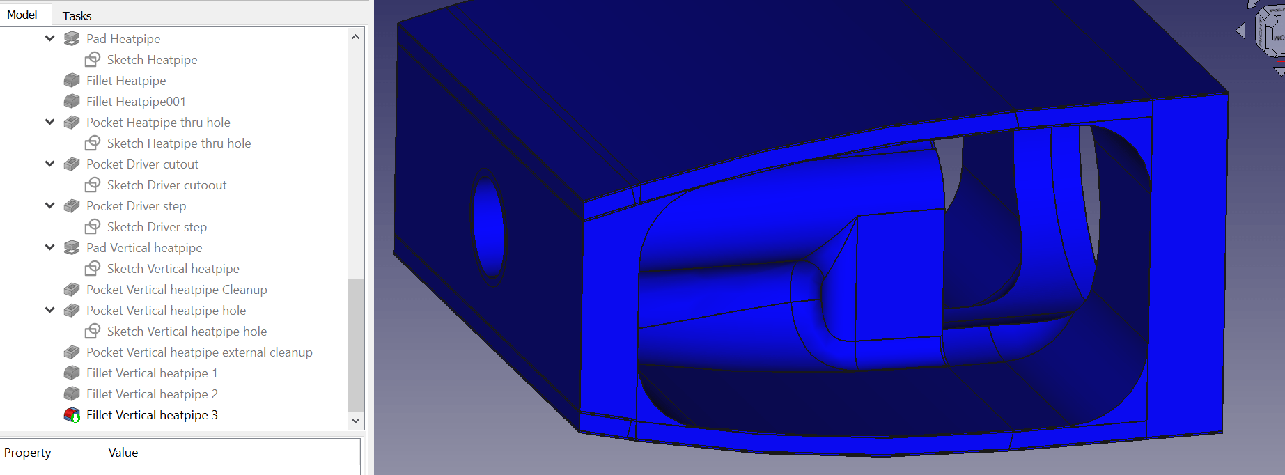

Internals for the speaker sections are mostly modelled now. The following pics show how the 90 degree bend in the heatpipe is formed, how the fillets merge with the pipe and internal walls and how the active driver cutout and step recess is formed. I have chosen a 20mm rebate step instead of flush to allow some depth for excursion

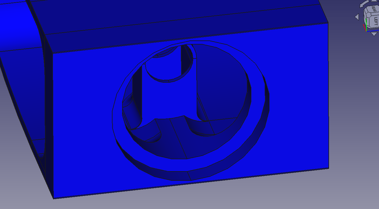

No, this issue is not a flaw in the program. That's how the fillets work. When you select an edge and fillet that, a pair of lines in the model are formed at the fillet widths. The lines from another fillet cannot superimpose or pass over. One line can approach another to any decimal point but never the whole number or beyond. When I curved the cab sides using fillets, a line got set near the rear inside curve. New fillet on the inside corner got limited to 9.999999999mm as the line was 10mm away from the corner edge line. I resolved this by going back to the back panel that I had extruded through the cab. This was going to be 20mm bamboo panel. By extending the width to 30mm, I managed to extrude it over that line and swallow it up. The new inside corner edge now has moved 10mm and no longer restricted by any lines from previous fillet and I could now set my 40mm radius work out from my scantlings for this projectHave you reported that issue to the developers (freecad)
Now that I am aware of this limitation, I can use it better. Next one that I draw like this will have all these initial lines placed inside points of future extrusions and carves. I hope this makes sense
The FreeCAD app is very capable but very chaotic in interface. It seems to be made up of modules (workbenches) coded by different folks. The modules aren't very consistent with each other. I think I have worked out the parts design bench fairly well now but can really feel the combined weight of these limitations for prototyping. This is a program for drawing an already designed item. Have a look at the FreeCAD templates done by other members for flat panel speaker boxes. The use of spreadsheet and all that is a very mature process for FreeCAD
Unfortunately, the only progie that seems aimed at prototyping is SolidWorks. It really is worth the money they are asking, and my hobby is important enough to me to work towards this
Side baffles for the PR unit created. Again, a 20mm step to allow for excursion instead of flush mount. Doing this will allow flatter grills. Just the back panel left to tidy up with the fan inlay, and then I can move onto the v2 electronics bay and she will be done
That's it, the rear panel is complete and so is the speaker section of this cab. Onto the electronics bay now. Version two electronics bay will be fairly roomy. At the moment, I am leaning towards an FFA001 module to drive the mains and FFA002 channels for the subs DVC. Two pairs of custom banana outs for the mains. Stereo XLR ins from the mixer and a DSP based xover inside. A neat addition will be a pair of banana sets for switching the internal amp to drive a larger external passive sub

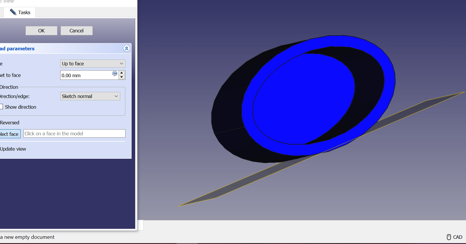

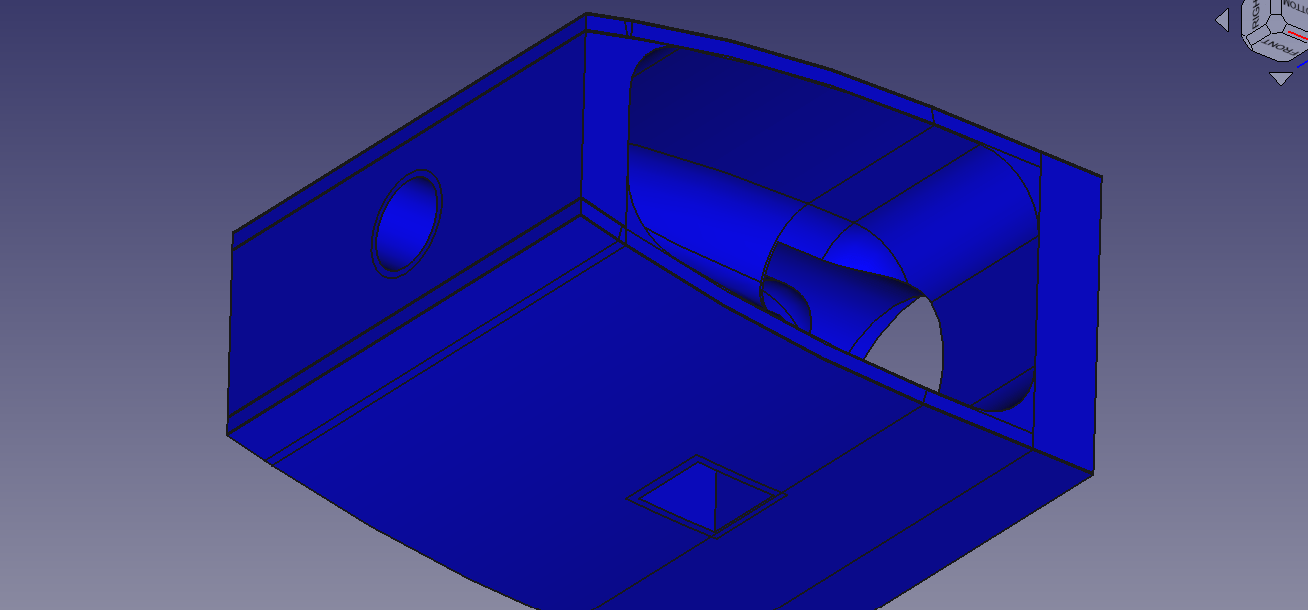

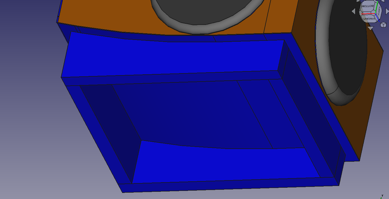

After a day of headbutting with FreeCAD. This is how far back I need to cut the model back to start the electronics bay feature. This time I think it's a program bug, as the extrude to a face function does not work as expected. I have extruded to a curved face before, so didn't expect it to not work
Doing it at this stage is super easy though. What I will do is save this as a new file, create the electronics bay and then carve away the cab to end up with a two part model

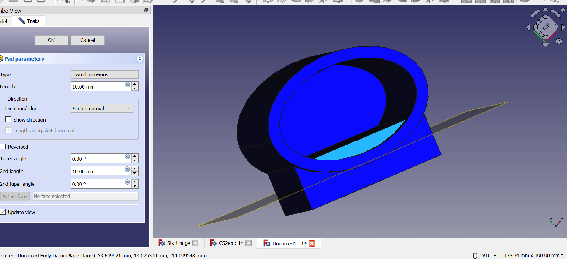

Studying this further as maybe I am not using this function correctly. Made a test case curved panel and extruded to it. A regular extrusion using the dimension option works as expected. Creates a slab and the highlighted face gets carved away next. I'll use this way to create individual side, fore and aft panels for the bay
Extruding by using up to face and both checked and unchecked for the reverse box does nothing
I will explore this some more and see about sending a link to this message
Success! Now I can scrap the speaker cab section from this file and work the electronics bay further

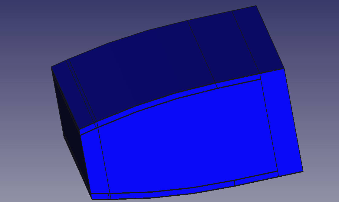

Encountered some severe limitations in FreeCAD while trying to develop my base block using an arc in the sketch instead of curving the sides with fillets. This is for the clean lines that I showed in the previous post. Works and gets me a clean extrusion as shown. Well it's useless! Creating a structure using the arc tool is a dead end. The created surface cannot be further extruded in steps to create laminate layers. I am glad that I tried that. And I did try many variations over the past few hours. At least its good to know what rabbit hole not to jump down again. It is definitely not a problem though as starting from scratch, I can use fillets for shaping the side panel curves and push the edges of the fillets well into the sacrificial formers area at the ends. After forming the skins, I'll slice the ends away and replace with the solid baffle and rear panel, leaving no shape forming lines on any panel. So, no work limiting lines will appear on the model
