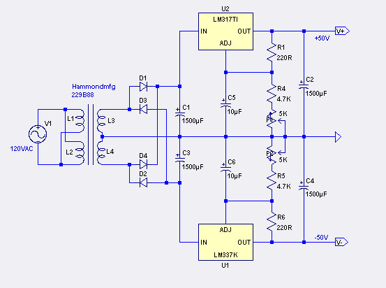

Thanks for the complements. Are proposing a voltage doubler using the F4 transformer? I hadn't considered that, but given that less than 50mA is required from each higher voltage rail, that should be easy. I just used a Hammond 229B88 transformer which has a pair of 44V secondaries.\ ... It's easy to get higher voltage rails (needed for the preamp) from F4's transformer so the integration is easy and straightforward ... !
In a way - I use this routinely (PSU sch. from post #1), works better than other "voltage doubling" schemes....Are proposing a voltage doubler using the F4 transformer? ...
IME, LM317/337 are producing a certain amount of HF noise at the output, but in this specific case we have an advantage - the preamp has the constant current draw from the PSU so we can add nice RC elements at the regulators' +/- outputs (10R + 100uF) to filter that noise out. Sometimes, the difference made by this filter can be even heard...
Would you put that filter at the folded cascode "load" resistor or at the PS? Seems to me that there would be a noise advantage placing it at the cascode.IME, LM317/337 are producing a certain amount of HF noise at the output, but in this specific case we have an advantage - the preamp has the constant current draw from the PSU so we can add nice RC elements at the regulators' +/- outputs (10R + 100uF) to filter that noise out. Sometimes, the difference made by this filter can be even heard...
At the PS +/- outputs - we want clean PS voltage.Would you put that filter at the folded cascode "load" resistor or at the PS? Seems to me that there would be a noise advantage placing it at the cascode.
Your circuit uses cap. multiplier filters for the 51V supplies, but does no regulation and has significantly higher ripple than from the TL431. It can be argued that regulation is not needed for the folded cascode IF both +51 and -51 supply voltages vary (nearly) identically with mains and power transformer load variations, since the resulting current variations will cancel. Otherwise the cascode output voltage offset will vary. Since I am NOT using a capacitor between the cascode output and the F4 input, I was concerned about the output offset and after some analysis concluded it was not a problem for offsets up to 0.1V-0.2V or so, since JFET follower input stage has a floating output and cap. coupled to the output MOSFET gates.In a way - I use this routinely (PSU sch. from post #1), works better than other "voltage doubling" schemes.

How about this variant "voltage doubler"? This uses a topology that avoids DC in the transformer windings, which would probably not a problem for the F4, and it used in many of the FirstWatt power supplies. It is shown here using the TL431, but could just as easily use your cap. multiplier.
