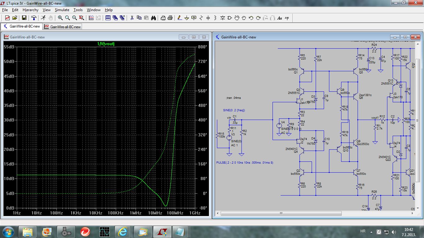

I simulated with different values of the resistor connected between Q9 and Q10 emitters and there is no significant change in THD or PSRR, so I stick with circuit as it was with Baxandall super pairs. I have Dimitry Danyuk enhaced cascode, but I think it could not be implemented here.

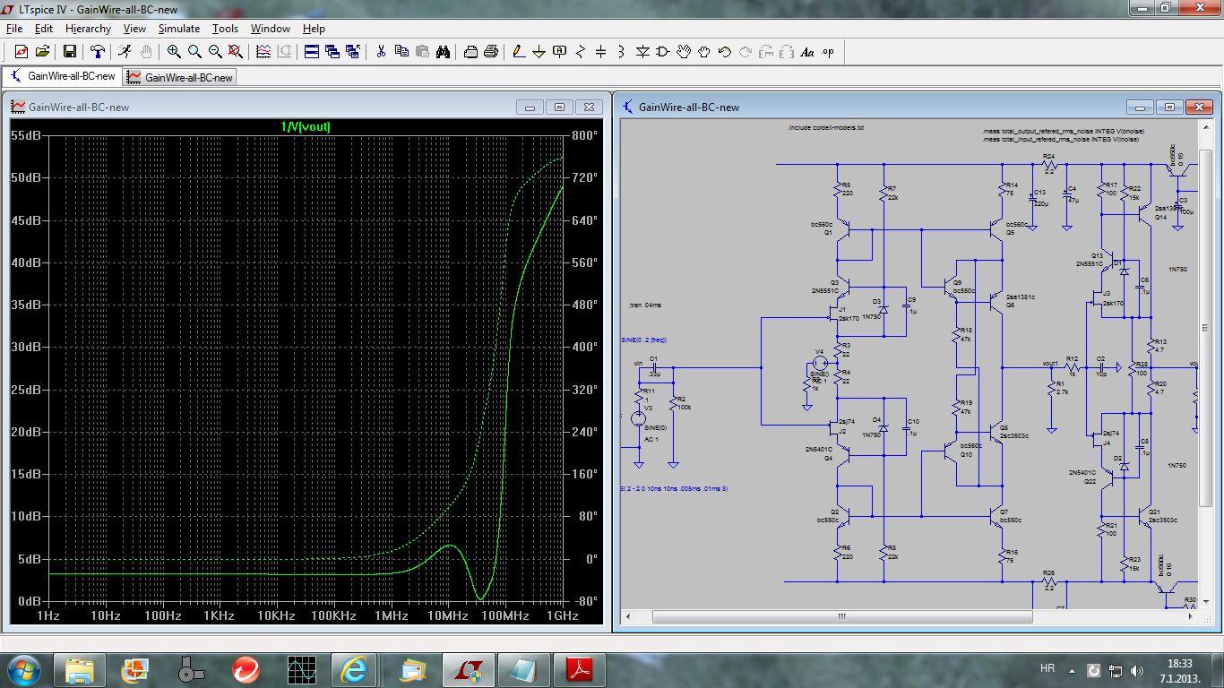

I simulated only current conveyor part, without output buffer, with cross connected resistors and resistor connected between emitters. I could get very insignificant drop of THD20k from 2.05 ppm to 2.02ppm but in that case the resistor was 4.7 kohm and dissipated 0.9 W(with 13 mA). One side effect was that power dissipation on Q6 and Q8 droped to 100 mW and low power transistor could be used. I am not sure if this is better.

At R9 would be a (-) input port to use for cmr tests.
Thanks, I will do that.

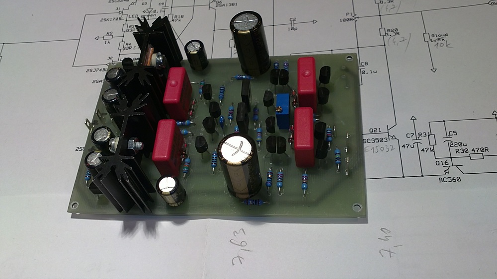

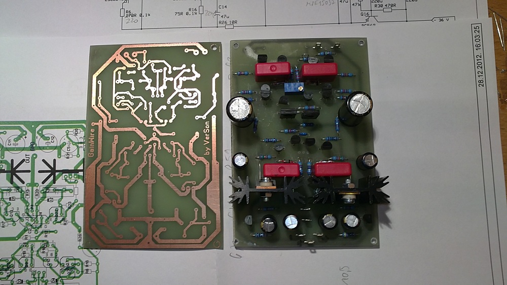

Here are some photos of the GainWire boards.

CMR uses same source (1) to drive both inputs -- so use 2 series R from sig gen of maybe 1K or more going to + and - input ports. Looking for a difference plot. Should have >60dB rejection or cancellation between ports for optimum performance. SOTA would be >-100dB.
Maybe true for modular instrumentation amplifiers but this circuit will only be connected one way in one circuit. It has passed all the requirements so far so even if CMRR is low, there may be little to gain from increasing it with this particular implementation.
R7/R8 give the + input slightly extra gain. At a current gain of 18.54k at the Jfet sources, this calculates to a CMRR of 2.85db, which seems to agree with the simulation. R7/R8 need to be bootstrapped to the negative input or replaced with current sources.
I think in the first simulation since you bypassed the 1k resistor you caused major offset which saturated/clipped the output resulting in optimistic PSRR.
